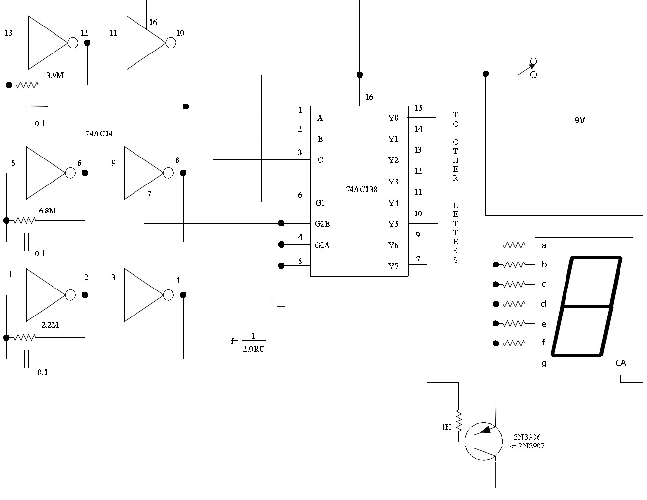

I've done the test for the display with two values of resistors. 680 ohm resistors are suitable for my 7-segment LED display.
I already know how to build the 555 timer to feed the circuit with clock pulses. I only need to know how I can make the binary numbers count randomly so that the message 'Hello' appears in random order.
Thanks,
The attached diagram uses CMOS IC's. The output of the 74AC138 is 8 lines, but you only have to use 5 for your display. You may have to experiment a little on the values of the resistors for the 74AC14 oscillators.
I have shown the connections for the letter O. Use resistors and a PNP transistor for each of the other letters.

thanks k7elp60 for your circuit diagram. it is clear enough to read. I will implement it on breadboard and i will tell u later on, if it works or not.
