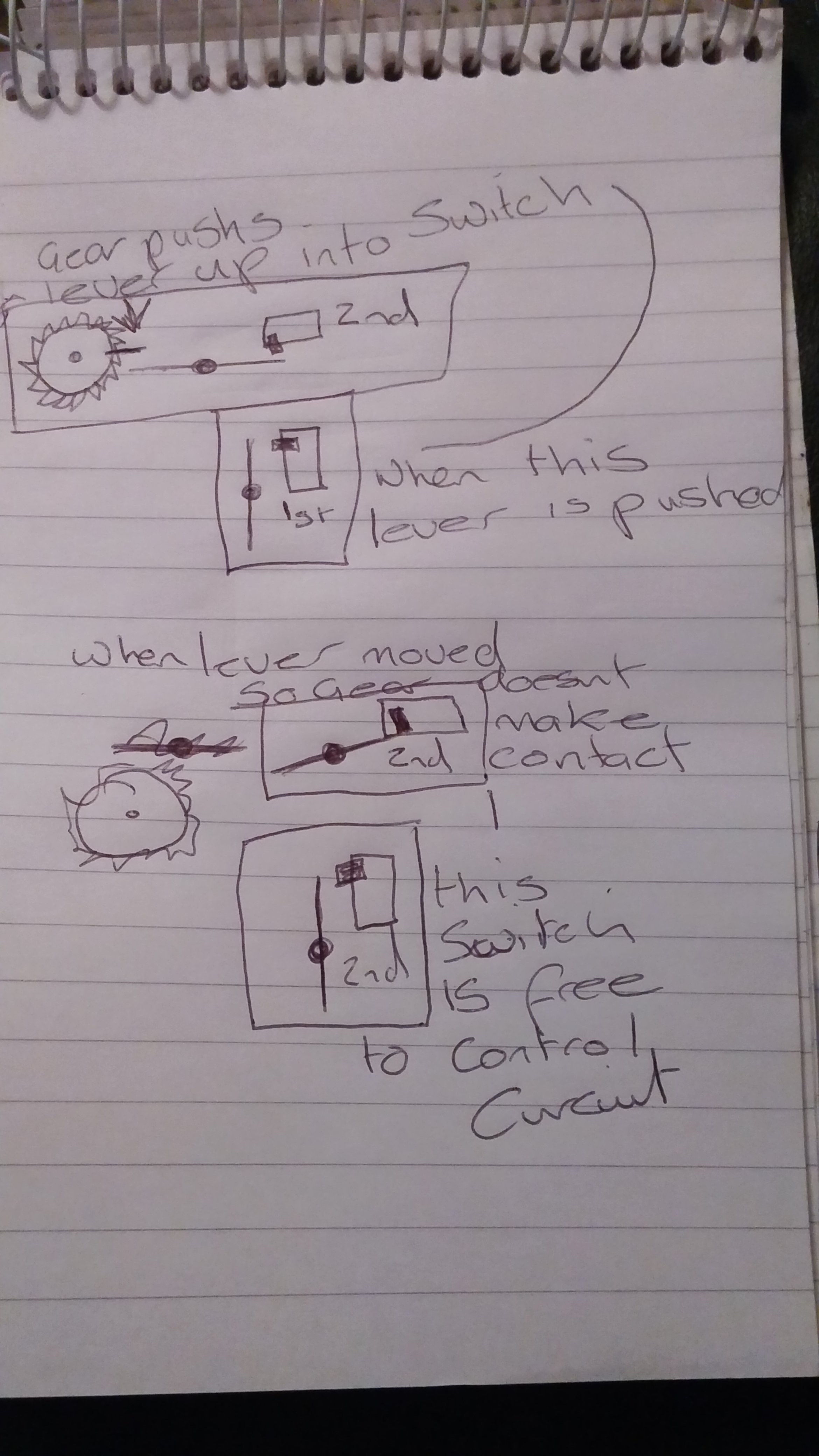

In the first instance the A switch makes and the B is a momentary press to break until A is released and pressed again the 2nd instance B is pressed in before and held and A then makes circuit when pressed until released i was planning on using mini micro switches im hoping to replace a single switch on a trolly system the switch is pulled out of way by lever unless that lever is pushed up first hope this is clearer
I'll post some pics tonight of item may help i could use a 3rd switch to cut of B so A is free to make and break but i would like to avoid this as it would be outside casing and would be vulnerable

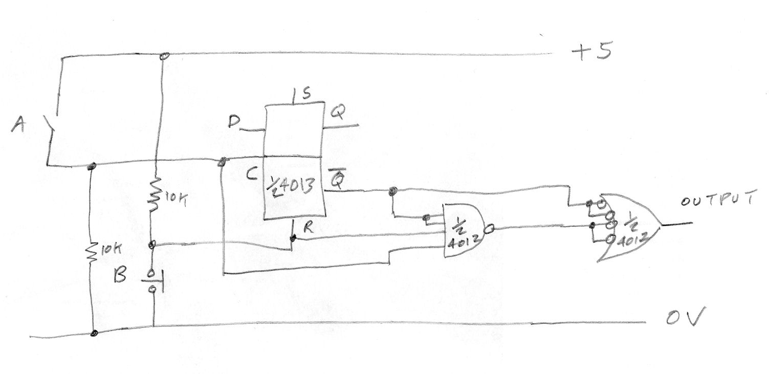

If I understand your reqirements then I think this should work.
It will require a small change to ensure it powers on in the correct state. Also the D input of the flipflop should be connected to +5 volts. (I forgot to draw that line on the schematic.) If switch A goes from the open to closed state first then the flipflop is set as the transistion clocks in the high on the D input of the flipflop. the not Q output drives two of the four negative inputs of the quad negative input OR gate. (This is just an alternative way of thinking of a quad input NAND gate.) This drives the output high. When switch B is pressed it forces the flipflop into the reset condition switching off the output. (If switch A is still closed the output will NOT go low untill the B switch is released. If this will cause a problem then another flipflop will be required) If the B switch is pressed first and held pressed then the state of the A switch is routed through the two gates to the output. The circuit uses half of a CD4013 dual flipflop and both gates in a CD4012 dual quad input NAND gate
Les.
I think im getting this and the gear that hits the lever to press B is spinning very fast so unlikely to stop in time for it to still be pressing it but if it did just taking battery out should sort it? Or if i release A and press again would it think it was instance 2 and just keep motor running. And d just goes straight to line above and the 4012 would run in that order which would be just pins from one side of the chip and 2nd part from other side of chip and am i right in thinking any spring based switch would work for A&B would like to use microswitchs

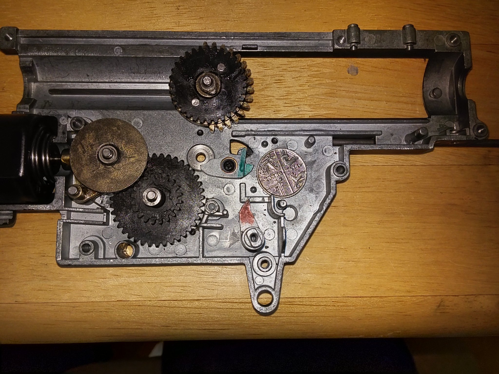

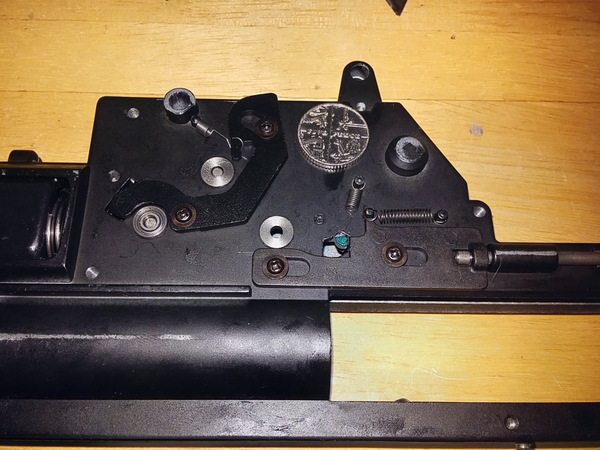

Just catches the lever so pulse every revolution the circuit is part of a trigger for a airsoft gun (basically a toy gun like paint bull) so the trigger spins the motor and pulls back a piston the same gear that flicks the lever lets piston slip to fire the bb semi auto mode the lever will flick switch and break circuit and when put in to full auto mode lever is lifted to keep it firing and im basically trying to shorten the trigger pull well shortening pull isn't a problem its the trigger reset thats the problem, its about a inch now and the pull reset on a microswitch would be a lot smaller and would be adjustable by moving the switch

I can see no reason why micro switches should not be used. For the following comments I am making these assumptions. 1 Switch A is the trigger. 2 switch B is pulsed by the bit sticking out from the gear wheel hitting the end of the lever when in single shot mode. 3 To set continuous fire mode the assembly containing the lever and switch B is moved away from the gear wheel and a cam or something pushes the lever so that it operates switch B. 4 the output of the circuit drives the motor.
The possible problem I described in post #7 would only occur if the trigger was held in while changing back from continuous fire mode to single shot mode. I would think in single shot mode that the motor would always stop either with switch B pressed or just after it was pressed. (As the motor would not stop the instant power was removed.) When the trigger was released in continuous fire mode the motor could stop in any position. I suspect this could cause a problem as I would think there would be a cam on the gear wheel to trigger the firing.

3something is moved to press switch switch stays in same place and lever no longer gets hit but B is being pressed

Ive marked the lever that will hit B with green it will lift from this position to hit it and go up when in full mode. red one is trigger which will tilt right. photo of case is to show bit that puts it in full mode one on right with rod i was hoping a hole could be made for a 3rd switch so it could be inside and just lever of switch out but this is not possible but could drill hole for wires and have it on rear but this would have to be very flat 2mm and be pushed in from side if i could find switch like this i could use one for cam on gear cut lever part that catchs cam and use it for B only keeping and 3 in case but would worry of durability of switch this small being hit so much

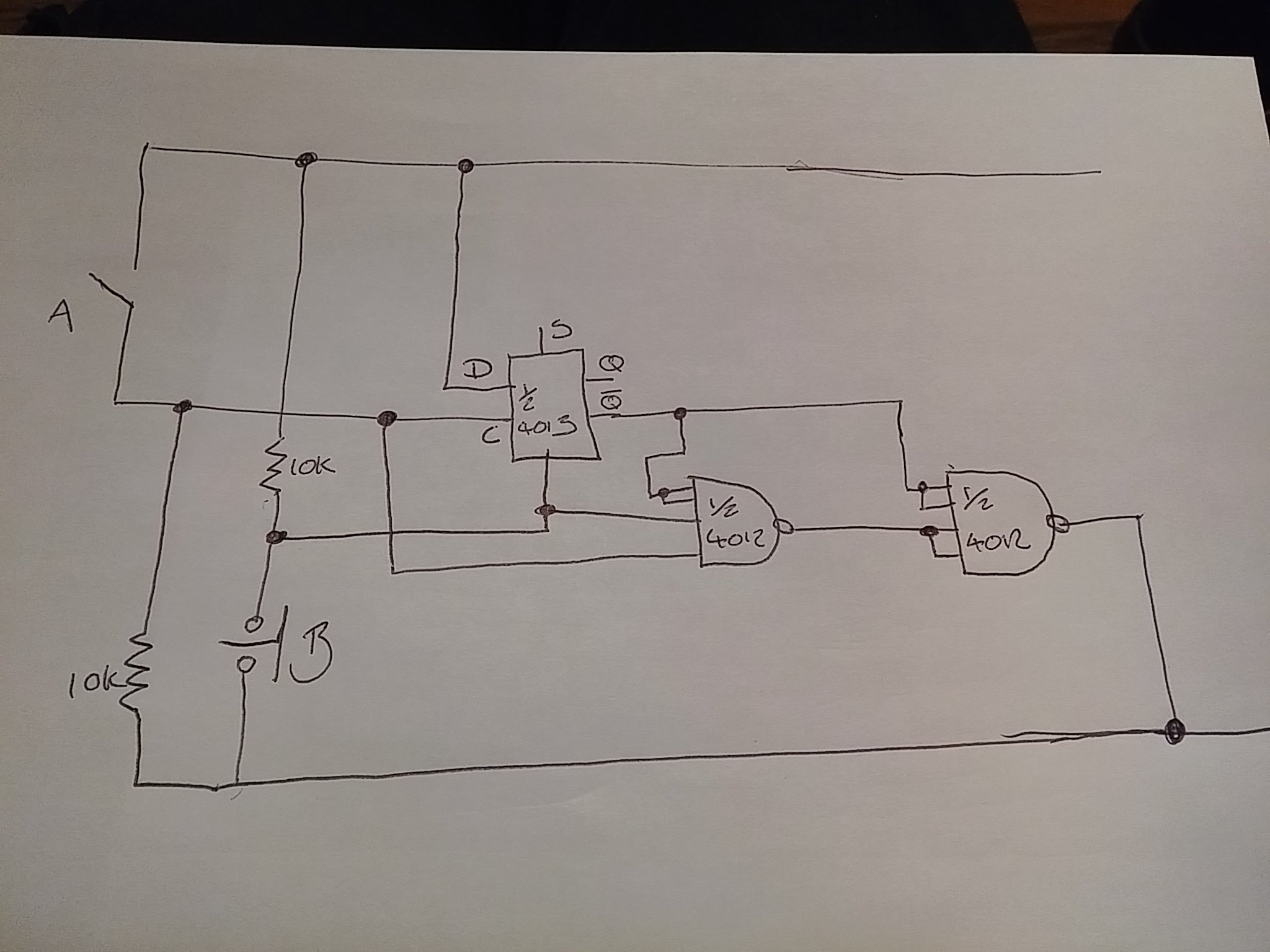

I have redrawn your schematics to make sure ive understand them as im gonna try this as parts are cheap and worth ago and i hoping that it will be very rear that it stops pressing B as this is the moment the spring is let go and motor will have to much momentum to stop here any help or comments will be appreciated
Hi Stuart,
You have redrawn the schematic correctly except you have connected the output (The output or the right hand half of the 4012) to ground. This should go to the mosfet driver circuit which drives the motor. I would advise adding decoupling capacitors between ground and the positive supply. A 100 nF mylar or ceramic capacitor should be fitted close to the ICs and also something like a 10 uF electrolytic but that does not need to be very close to the ICs If you are using the same power supply for the motor as the ICs then having a diode in series with the positive rail will help reduce any drop in voltage caused by the motor starting current from effecting the circuit. (Diode - to the battery diode + to the circuit positive. In the circuit I have not put in any components to ensure the flip flop powers up in the reset state. If the circuit works as you want I will redraw it with these components added. The DC4000 series ICs can be used with a power supply up to 15 volts. It does not have to be 5 volts. In answer to your question about a switch that generates a pulse I do not know of one. Adding a capacitor and two resistors you can generate a pulse from a normal switch. To get a positive pulse when the switch closes connect one side of the switch to + 5V Connect the other side of the switch to ground via a resistor connect one side of a capacitor to the junction of the first resistor and the switch. Connect the other side of the capacitor to ground via a second resistor. When the switch closes you will get a positive pulse at the junction of the capacitor and the second resistor. The component values will depend on the length of the pulse you require and the impedance of the circuit being driven. The leading edge of the pulse will be fast but the trailing edge will be an exponential decay. If you require more precise pulse the you could use a CD4047 IC (Or similar.)

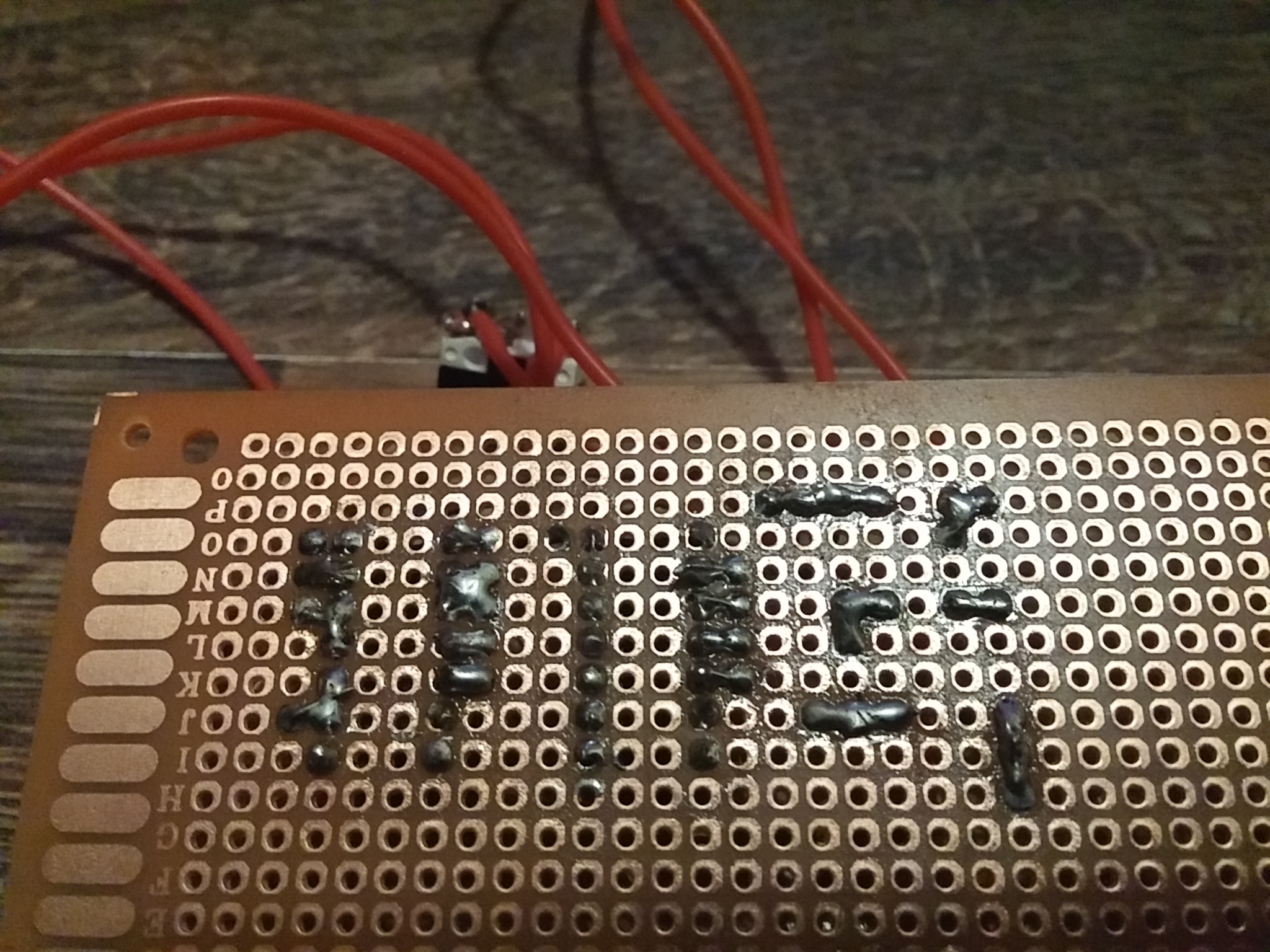

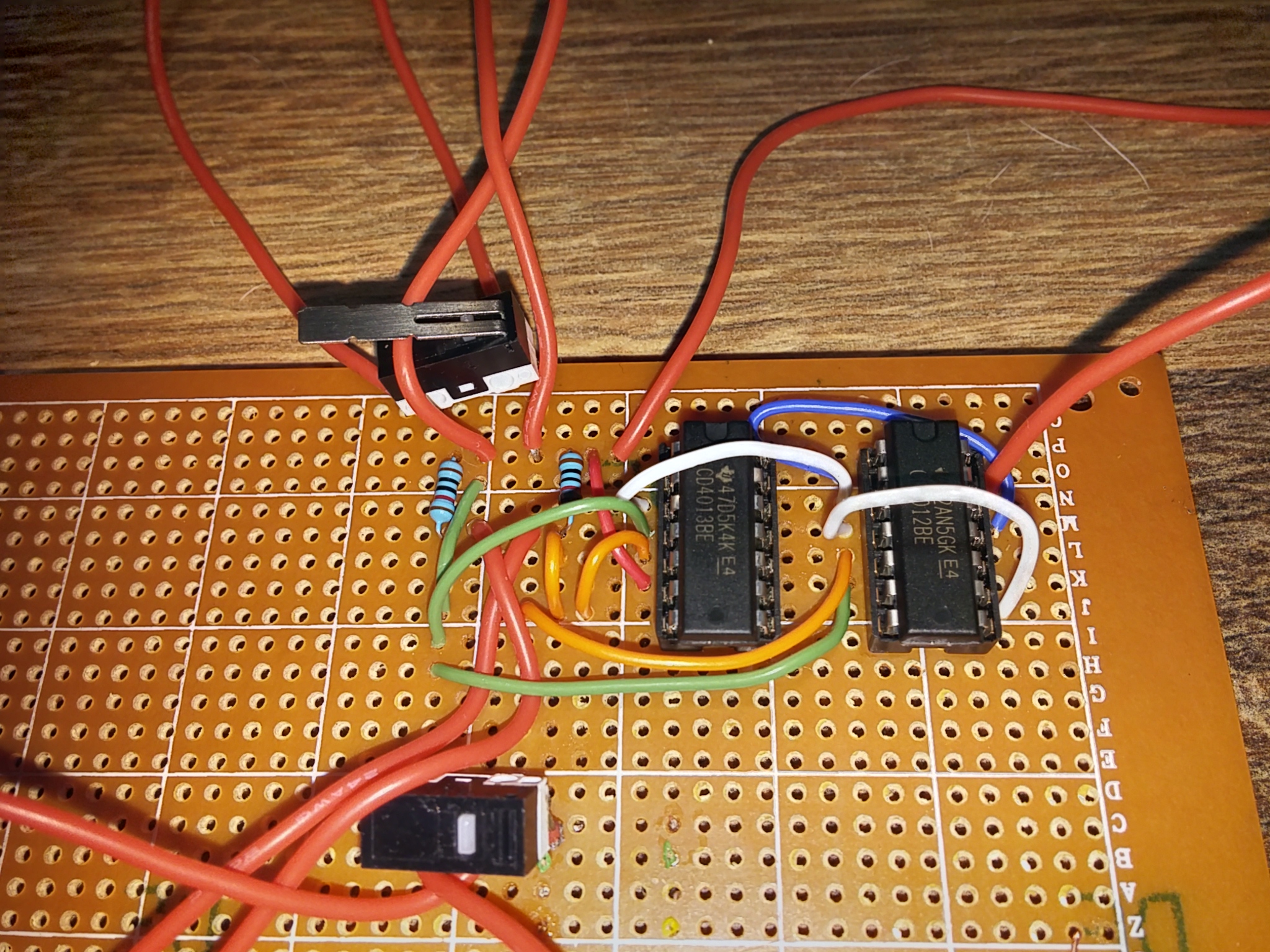

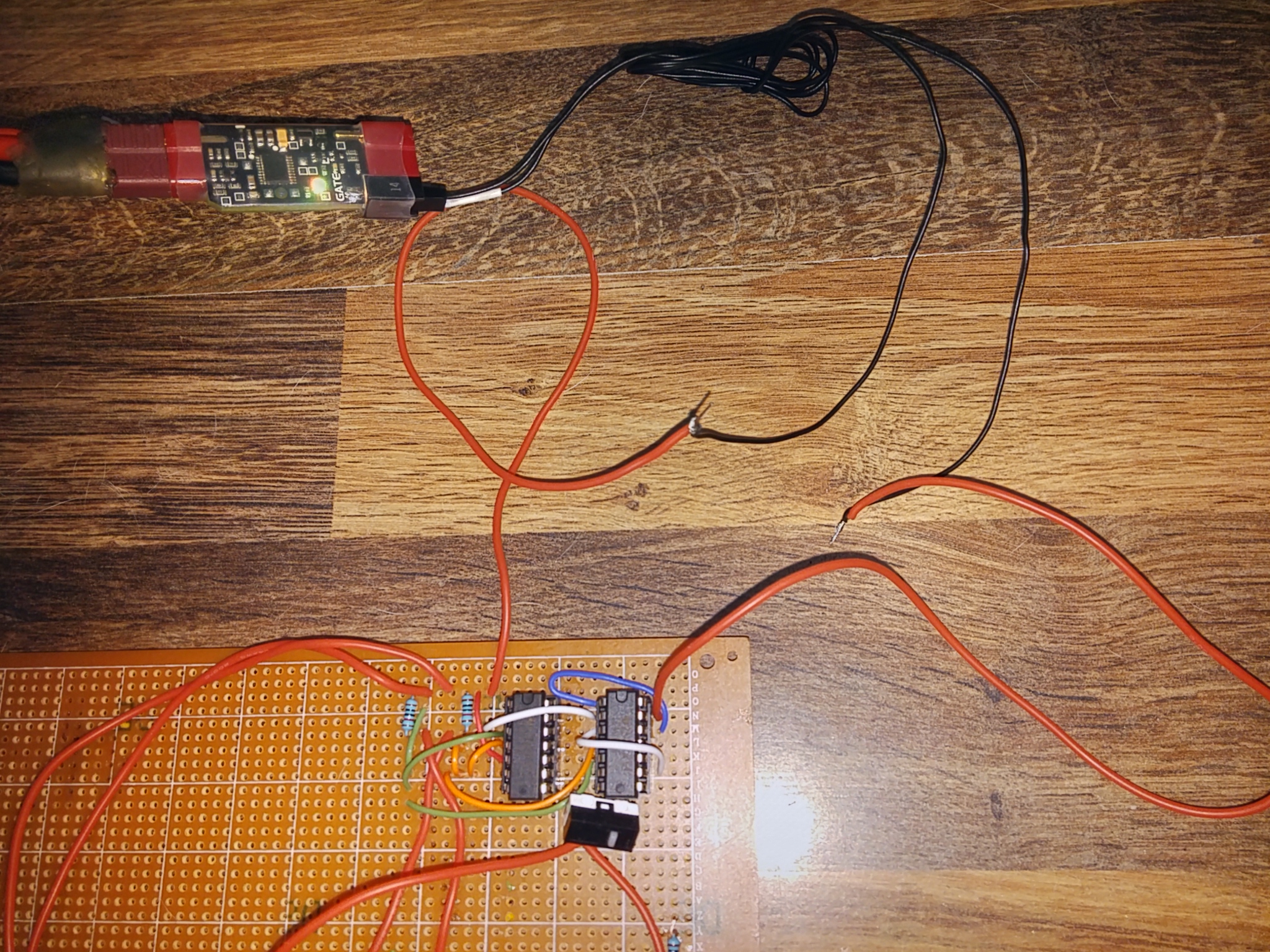

Ive built the circuit 3 times first time i messed up as had the output on the top pin of the 4012 and the rest of the pins all out by 1 because or this if you held B and then A could be pressed and make
The secound and third time led just stays on with switches doing nothing i was think that i may need power to come straight from battery
Hi Stuart,
I have noticed that I have not shown the unused set pin connected to ground as it should be so it does not float high or pick up noise. This will not be the cause of your present problem as it would cause the output to come on when it should not. I built the circuit today and its behaved as expected except for the condition when the B switch is pressed first and held pressed and the A switch is held pressed while the B switch is released. When the B switch is released the output goes low but when the A switch is then released the output goes high. I worked out that this was caused by contact bounce when the A switch opened. This can be cured by connecting a 100 nF capacitor in parallel with the 10K resistor from the clock input of the 4013 and ground. I cannot see any decoupling capacitors that I suggested fitting on the picture of the board that you built. This is something that you should do on all logic circuits.
Les.
