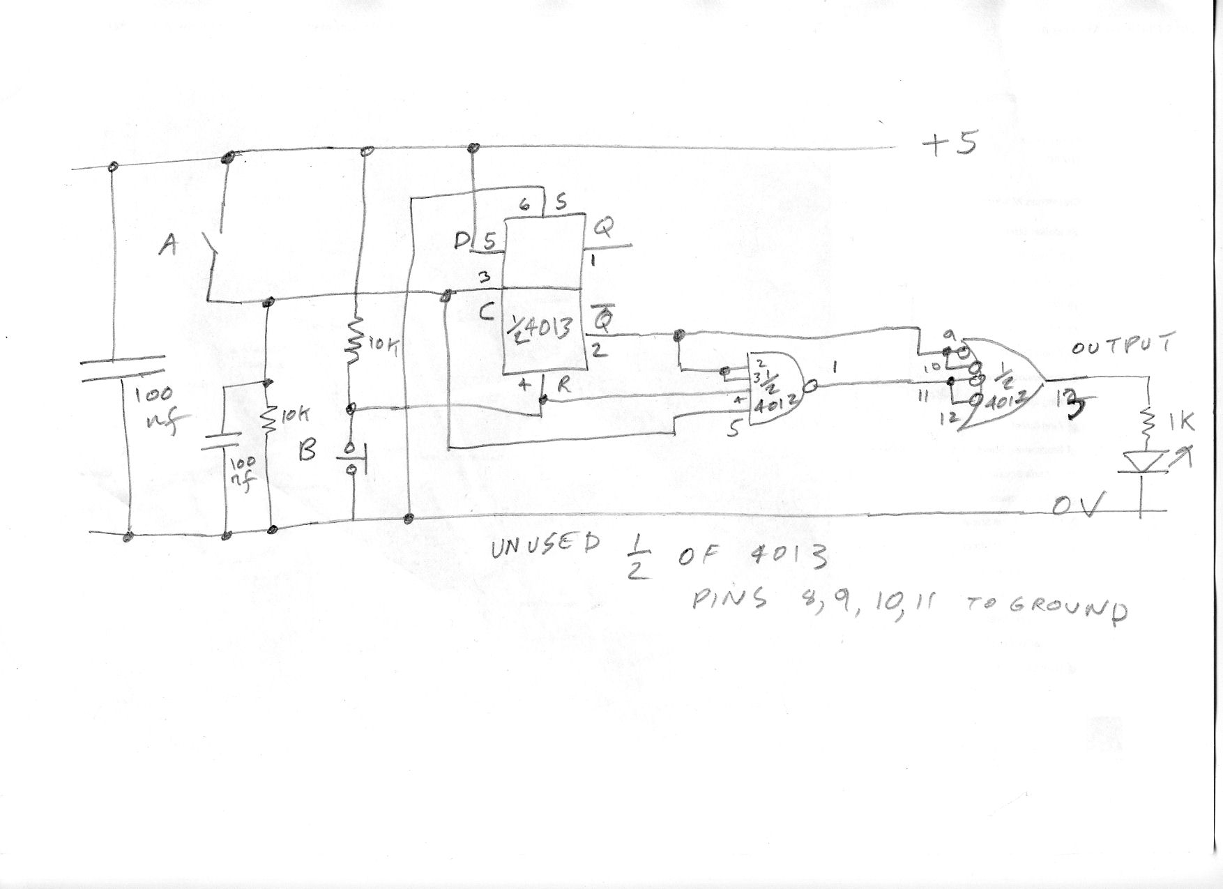

Hi Stuart, There is nothing wrong with the type of contruction that you used - it is better than a breadboard type of construction. (I have not tried to check that your board is wired correctly by converting it back into a circuit diagram (Schematic.) Decoupling capacitors go between the supply rails and should be as close as possible to the power pins of the ICs (0 volts and +5 volts in this case.) (In situations with fast switching speeds you may need to put a decoupling capacitor close to each IC.) In this case ground and 0 volts is the same thing. (There are situations where this may not be the case.) This is the circuit as as I built it. (After adding the capacitor to de bounce switch "A")
Les

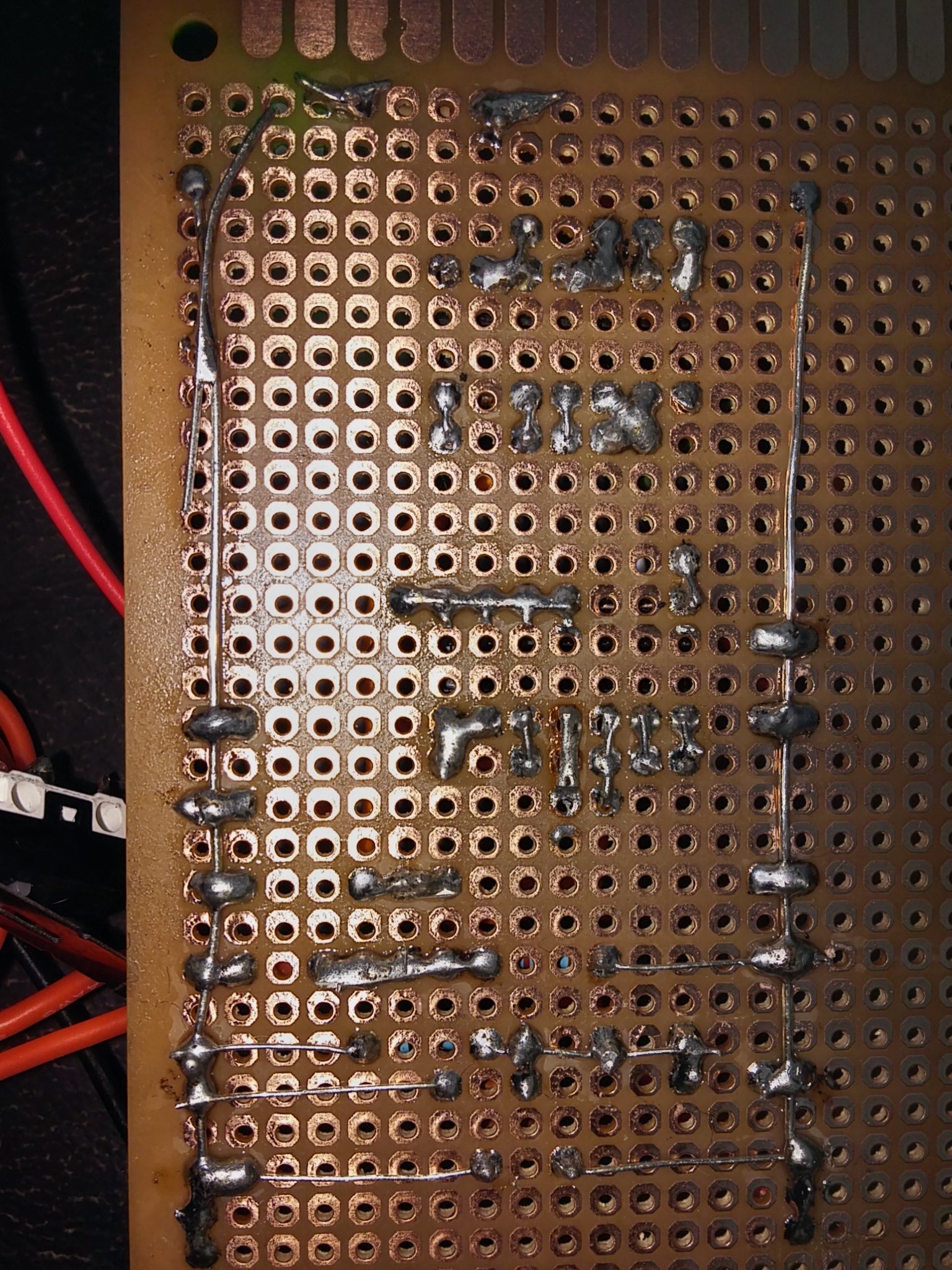

Hi Les, in your circuit you didn't include the power supply pins for the two chips, so the OP didn't include them too into his circuit.
So both chips are un-powered. That's why it wouldn't work.
See the edit pcb attached.
The bottom view is rotated and mirrored so the orientation is correct.
Allen

Thanks for spotting that. I did not attempt to check that the board layout matched the circuit diagram. I will have to remember in future when trying to help new members not to assume anything about their level of knowledge. Considering how new Stuart must be to electronics he has done well to build the circuit at all as I did not put any pin numbers on the original circuit. I was glad I built the circuit to confirm that it would work as I had overlooked the effect of switch bounce in the situation I described in post #20 I still need to add a few components to ensure the circuit powers on with the flipflop in the reset state. The circuit I built seems to power up consistently with the flipflop in the set state. I can see no reason for this I thought it would be random.

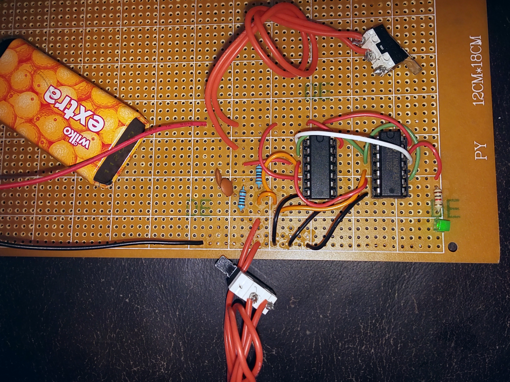

I've done it again with a 9v just trying to power led ive done it as close to your diagram as poss
Ive just changed it so ive got caps between 0v and 7pins and +5 to pins14 cap closer to ic pins i think this has got me alot closer as almost works well closer than anything else
A lights led and if you press B it dims it but comes stright back on
And if you start pressing B it lights only when A is pressed but its dim like above
But the 4013 is getting very hot
Hi Harv,
I've just checked that your board is wired as in the circuit and it looks OK. What I did notice is that both micro switches have the wires to the same connections. My understanding was that switch A is normally open (Contacts make when pressed.) and that switch B was normally closed. (Contacts break when pressed.) (This was from how I had interpreted post #1) After re reading post #1 I think you may mean that when switch B is pressed that the output of the circuit goes low. Can you wire switch B as normally closed to try if that works. (If you need switch B to be normally open then it only requires a small change to the circuit.) I have just read the edit to your post #31. Neither IC should get warm. I have just measured the current taken by my circuit wit a 9 volt supply. (Which I assume you are using from the PP3 battery in the picture.) With the LED out then it draws 2.2 mA ).9 mA of thet will be by the 10K resistor connected to switch B so the total taken by the ICs is 1.3 mA That will be 9 x 1.3 mW = 11.7 mW This should not cause any noticeable heating in the ICs.

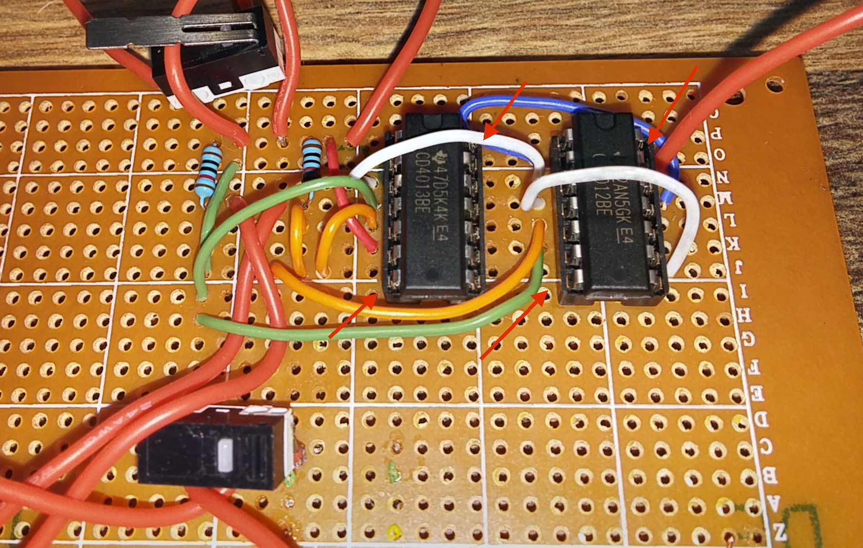

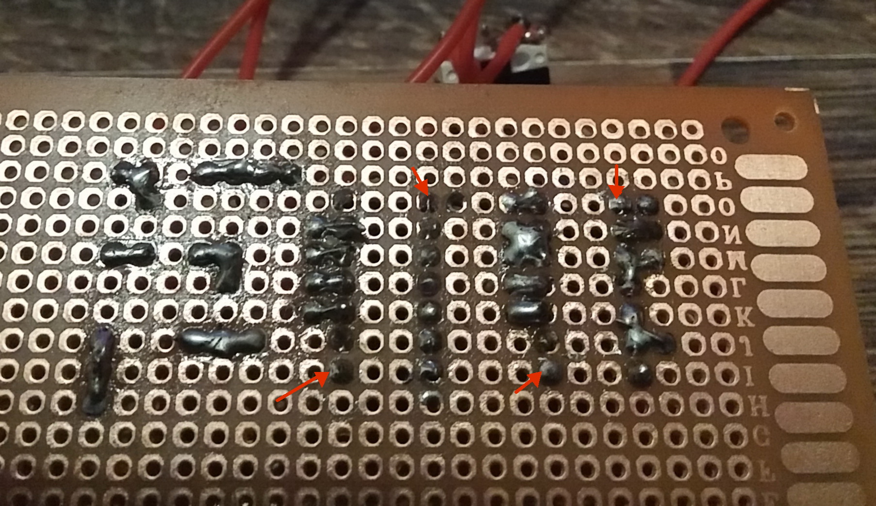

Hi Harv,
I think I have just spotted an error on your board. I think you have pins 11 & 12 of the 4012 connected to pin 1 of the 4013 instead of pin 1 on the 4012.
Les.
How ive got it in pics the light stayed on and sence then ive added cap between pins and power rails I'll redo it again as above but with switch wired nc and give results
Hi Harv,
Les.
Yep thanks how the hell did i do that ill try again
It works!!! and the problem of the cam stopping pressing B is not a problem as just means a double shot which it somtimes does anyway just need to try it in gun now

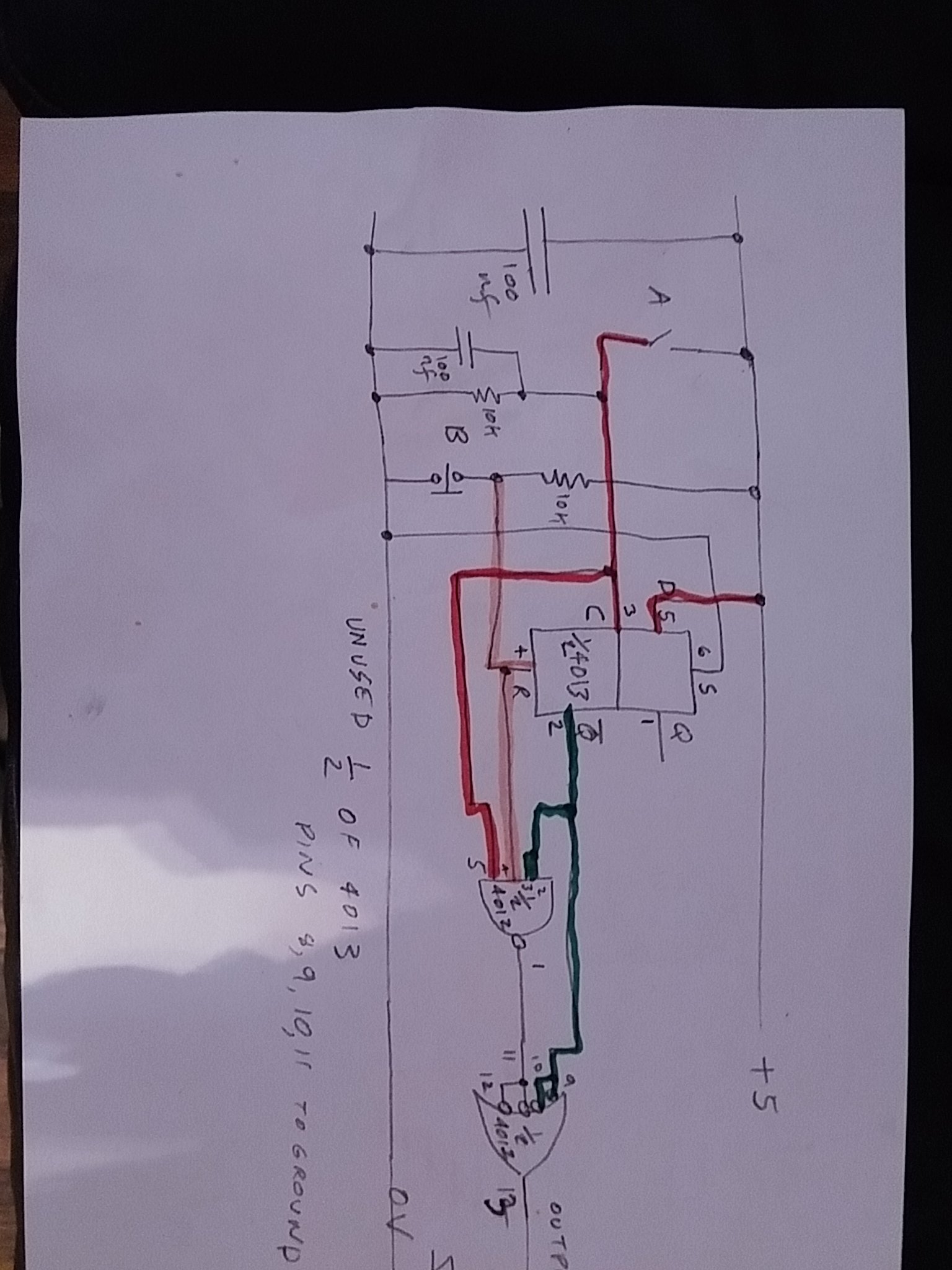

It works controlling led but when but when put on the control unit/mosfet the control unit see it as circuit made ie led lights up on control unit ive tried it many ways wired up but think right ways is the two sides of old switch to the +5 and other to output and ground to battery negative could it going low still be enough for control unit to see circuit made but not enought to light led
Hi Harv,
Can you post the schematic (Circuit diagram.) (NOT just a picture of the components and wiring.) of how the gun was wired originaly. Also post the schematic of the mosfet contol board including the part numbers of the components so I know what the drive requirements are. Then can you post the schematic how you connected your board up to the gun. You have not given enough information in post #39. (It would be like me telling you to build the board by connecting a CD4013 to a CD4012 and a few resistors and capacitors with no other information.)
