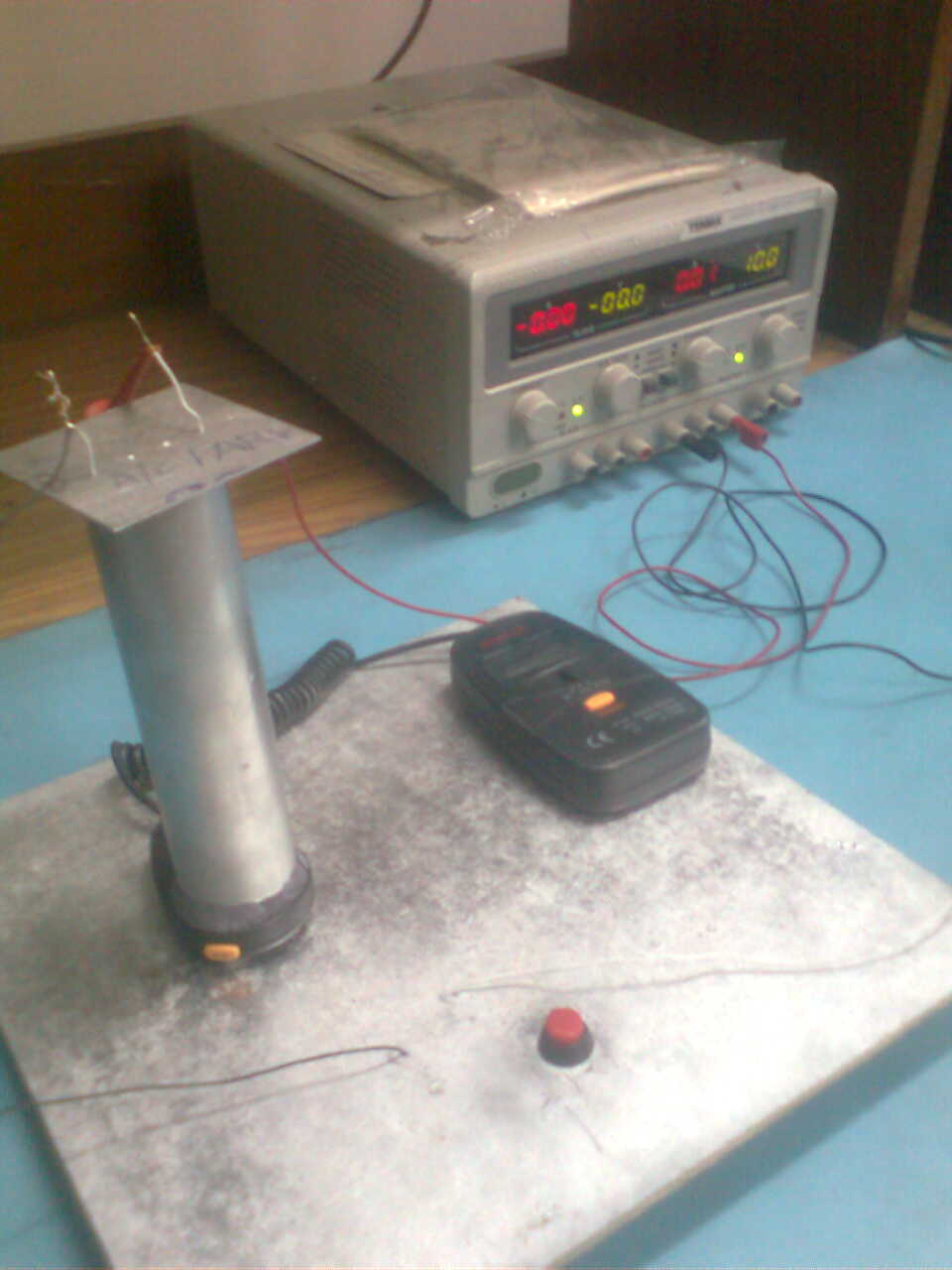

in this project m required 2 measure the intensity of different hbleds,making there V/I curves & ploting there efficiency as well.m using a lux meter 4 it. In my set up, i ve used a pipe & 4m inside i ve sprayed silver paint 2 make it a reflective surface,on 1 side of pipe i ve attached the sensor of lux meter & on the other side of pipe led is attached with an aluminium lid.nw a series connection is made which consist of power supply(dc), switch & this pipe setup. value of current is changed 4m the power supply.when switch is on,led is on & voltage,current & intensity is measured. the problem is that leds get heat up & effects the readind of intensity.also at the end of the project i ve to compare & replace CFLs with leds &ve 2 make a bulb of leds 2.i need help how 2 catter this heat issue, that by the end i can say in front of my panel dat leds cn replace CFLs & they produce negligble heat,gud brightness........plz xplan in detail n mention that wt sort of setup shud b made.

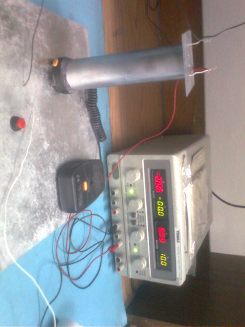

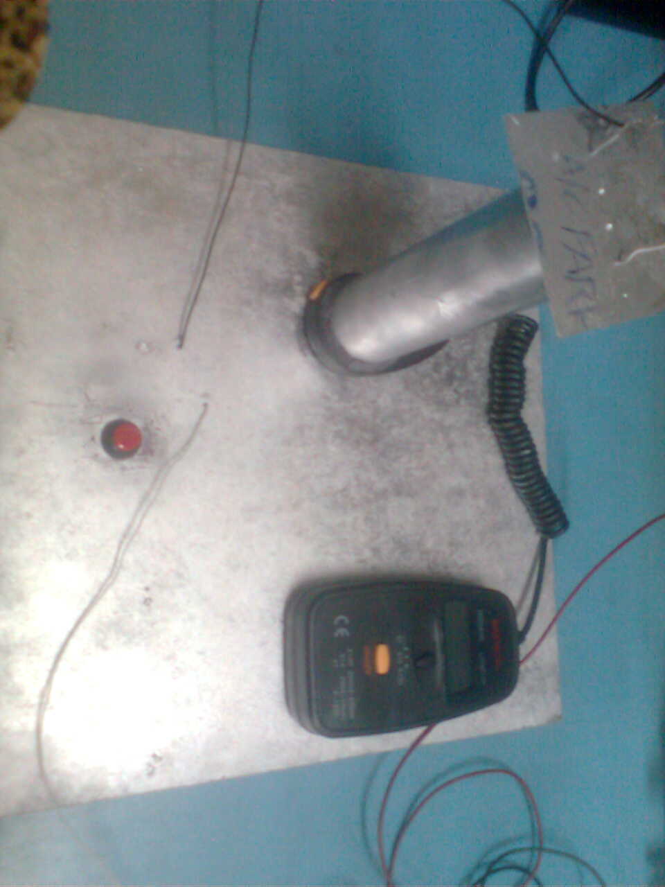

in this project i am required to measure the intensity of different hbleds,making there V/I curves & ploting there efficiency as well.I am using a lux meter for it. In my set up, i have used a pipe & from inside i have sprayed silver paint to make it a reflective surface,on 1 side of pipe i have attached the sensor of lux meter & on the other side of pipe,led is attached with an aluminium lid.now a series connection is made which consist of power supply(dc), switch & this pipe setup. value of current is changed from the power supply.when switch is on,led is on & voltage,current & intensity is measured. the problem is that leds get heat up & effects the readings of intensity.also at the end of the project i have to compare & replace CFLs with leds & have to make a bulb of leds too.i need help how to catter this heat issue, that by the end i can say in front of my panel that leds can replace CFLs & they produce negligble heat,good brightness........please explain in detail and mention that what sort of setup should be made.

Also not sure what 'catter' means. Are you missing a resistor to limit the amount of current going to the LED?
Some cheap "high brightness" LEDs are simply dim ones in a case that focuses and concentrates the light into a very narrow beam.
But a fluorescent light spreads plenty of light all around.
You have a good power supply. When testing LEDs remember they are current devices not voltage devices. Set the voltage about 2 volts higher than you need. Short out the supply and set the current limit to the current you need. (100mA) Now connect the LED. Adjust the current limit knob to adjust the light output. The voltage and current can be read from the supply. Keep the supply in current limit mode.
LEDs act different whem hot. Make your measurements fast! Normally high power LEDs are mounted on a heat sink. I don't think you can get good readings with out a heat sink!

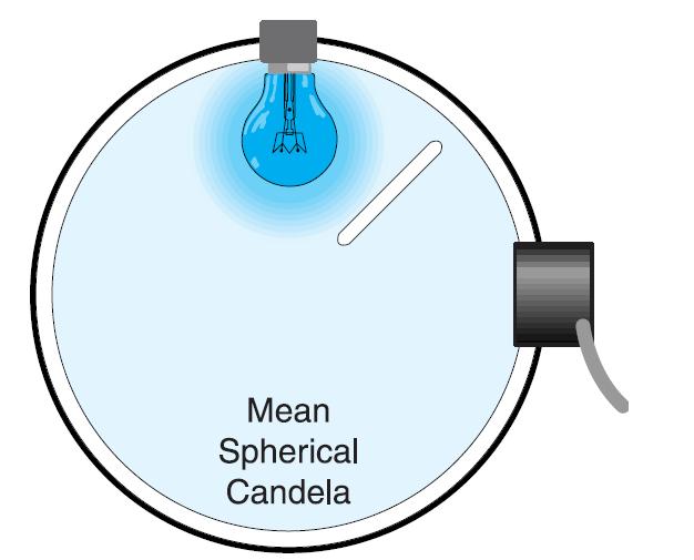

I think you want to measure the total light output of your LEDs and CFs. Most people shine the light on the meter and think they measured something. They only mesured how well the lense on the LED works. I can get the same LED silicon with a 180 degree lense and a 15 degree lense. The light meter will read that one is 100 x better. Total Luminous Output may be expressed in candela or in lumens. This is a measure of the entire light output of the light sourse regardless of beam focus.
Using your silver tube is a good idea. Here is a picture of what I use. My first one was made from a glass ball about one foot across that was a light fixture. The inside is painted white. The meter looks in from the side. The light must not directly shine on the meter.

i am not using resistor because i am limiting my current,i am varying current myself in a manner as mentioned by ronsimpson.
in addition to this,the leds that i have purchased from the markrt are not cheap,they are quiet expansive.(reply to audioguru)
ronsimpson,thank you for so much help, iam using my power supply in the same manner as you have mentioned.nw my next question is that i am using this lid of aluminium as heat sink.in addition to this i am also using heat sink paste to attach led with the lid. but by the end i have to make a product out of it,which will remain on for a long period,how will i overcome haet in my end application?
