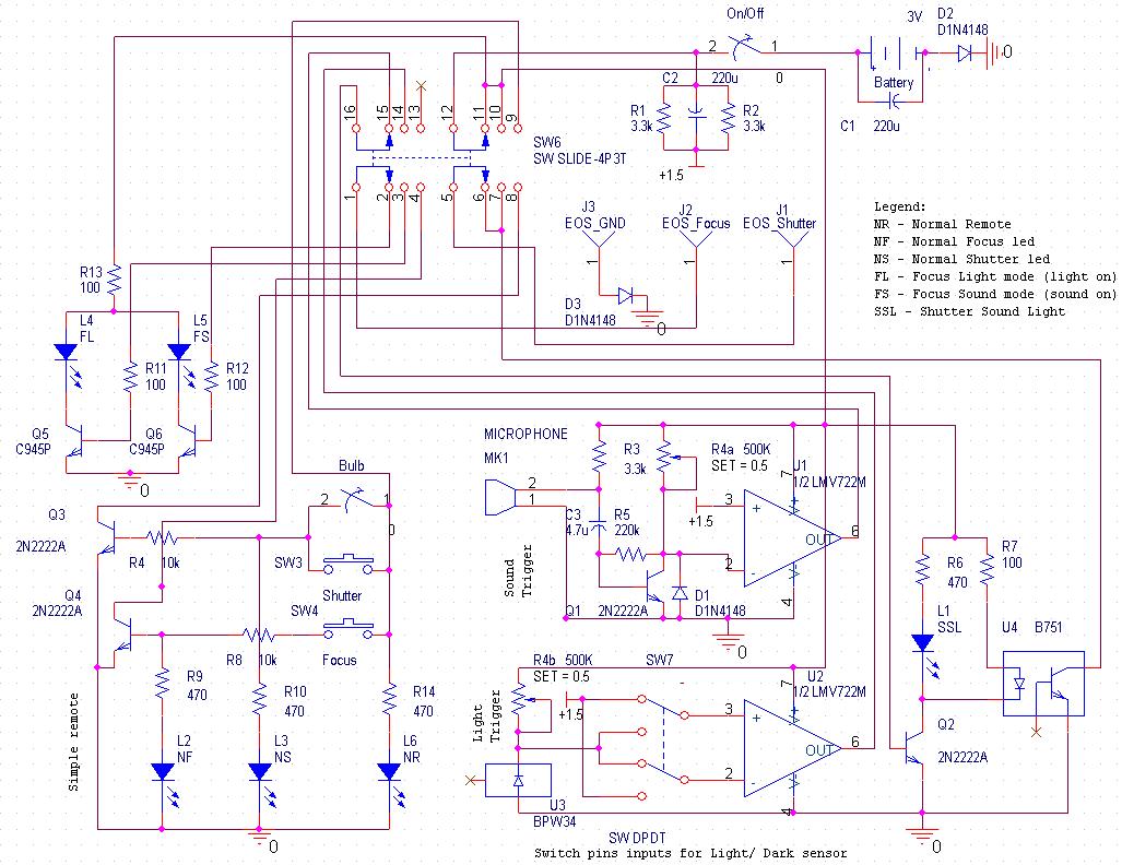

High gain Mic Preamplifier
Good.
You have a sensitive audio circuit.

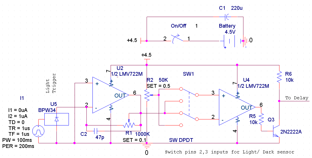

A transimpedance amp converts the extremely low current from the photo-diode to a voltage.
Hello Audioguru,
This is the trans impedance amp that i figure it out so far, do you think will work for my needs?
