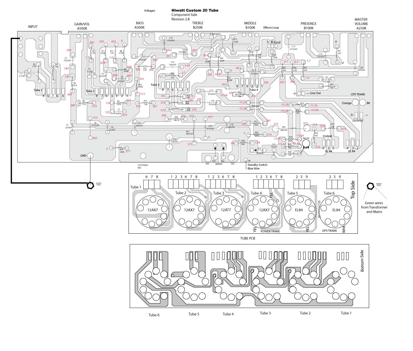

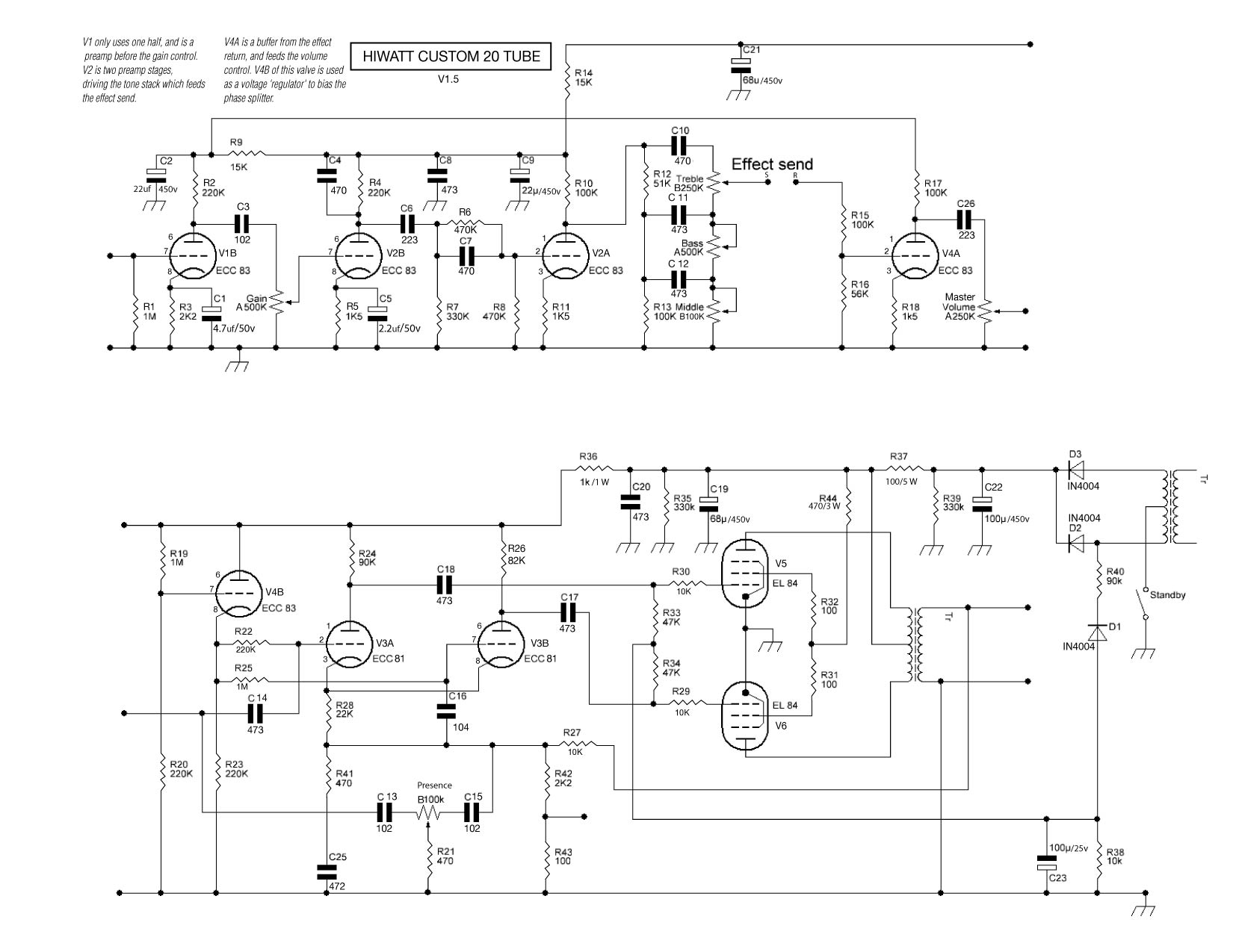

c23 was replaced with a 100volt cap. I've updated the schematic with the voltages.

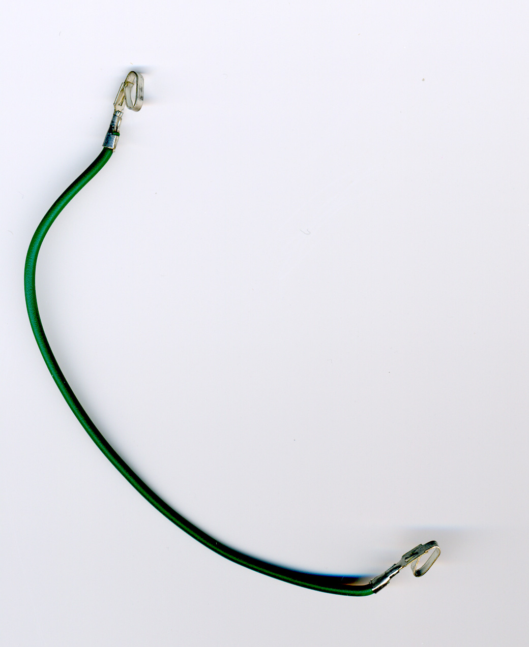

Anybody know exactly which connectors they used?
These are 13mm long and 2 mm wide with a tab on the back.
Here's a photo. The wire is 22awg 105 degrees or 90 degrees.

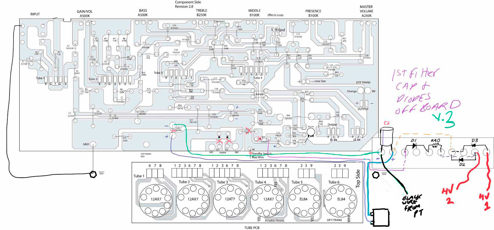

Here's a great suggestion I got:
"Move the blue standby wire to the negative lug of the main filter cap C22 100uFd 450V. I mean TO that lug, even though this will mean a blobby butt-solder joint.
There are many other PCB problems, but when I started trying to work it out I got a headache. Combined with general low-cost "quality", I'd be real tempted to bulldoze the chassis and start over with proper turrets and sockets.
Getting the massive ripple-garbage localized within 1/8" of ground bus, instead of spread-out over two inches in the middle, may help a lot.
If you do not understand exactly what to do, you can smoke the whole amp.'"
What do you guys think?
If you have a lot of hum and buzzing then you have a bad power supply capacitor.
Lets see the circuit drawing.
Those caps are all new.
Although I'm not sure how to check them.
Maybe the filtering is wrong for the amp?

There is a plan to move the diodes off the board and see if that's the cause of the problems.
The problem seems to be coming in from the input jack to pin7 of v2.
There I don't quite short out all the noise.
