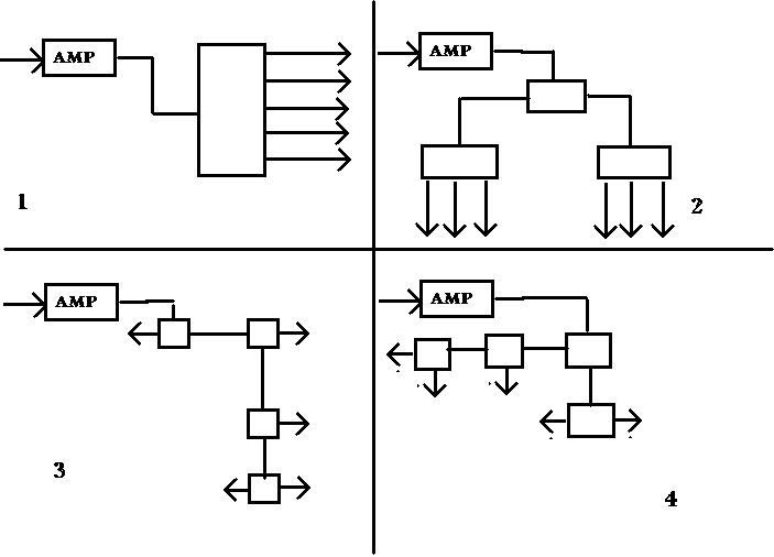

ok so i face a problem.....
i need to design a tv signal distribution for my house. there will be about 5 or 6 tvs and tv tunners...
the cable comes from the tv network and it will go trough an amplifier and then it needs to be distributed. and here comes my problem. how do i do this?
do i need to have a single splitter with 5 outputs and from there to go to each tv, or can i do like this: have a 2 output spliter and one of them goes to one tv and the other output goes to another siplitter and here it siplits and so on......?
wich is the best solution?

basicly i can see the wiring in 3 forms.
1. a single spliter, but i will have quite a large amount of cable running trough the house and this is too annoying.
2. i have one splitter near the amp and one on each floor
3. the signal travells from splitter to splitter
4. quite similar to 3
and another way comes in my mind now....
similar to 2, but i have a 3 way splitter on one floor and a 3 way splitter on the other floor.
hope someone can give me some tips on this.
personally, i preffer 2.

hm.....
yes, the second is the one that splies the same output....
though i have seen networks at the counriside done like 3, but the cable runs for miles.
i mean it splits in 2 at each user....one outputs goes on, and the other goes to that used...
so what shoud the disadvantages of the other will be?

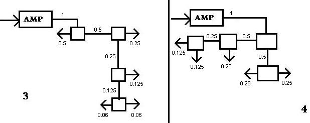

With my bad english can't better explain. See attenuated levels if amplifier output 1.

ok. i understand now.....
10X!
so the idea is to have the same level of signal at all the outputs.

ok. i agree the simple 8 output amp is the best solution ........BUT!
i can't have all that number of cables running trougm my house. the amp will be at the 3rd floor, the attic, but no TV's are there. then on the second floor i will have 3 tv's for sure. and on the first floor, 1 or 2 or 3.....depends.
running that much of cables trough the hous will be very annoing......if you can imagine that. i know this should be the best way..and the most efficient.
but i think that the other good idea is to use a 2 way splitter, and then a 3 way for each floor. this way seems best because the number of cables that need to be run. i only need one cable from floor to floor.

I vote for #1. balanced output, highest attenuation per output, and fewest splitters (allow a 1-3 dB loss at each one your signal passes through).

Your easiest method is as Seeker suggests. This is a 'star' splitter and it has all signals levels equal. With a hybrid transformer split there will be a loss to each leg of approx 12dB.
Cable TV companies use a 'tree & branch' system of feeds. A single cable carries the 'tees' which divert a small part of the signal through the tee to the subscriber. The tees are graded in 'side loss' depending on the strength of signal on the main cable at that point, and each tee has an 'insersion' loss which depends on its side loss. While this system would be OK for you, the tees tend to be a specialist item normally only generally available to cable TV companies or distribution systems installers and you would have to enquire around for catalogues and suppliers.
If you want to make a system as you suggest, then make it out of readily available 2way splitters, cascaded as necessary. A splitter will give you a feed to each of the two floors, and in each feed put a 2way splitter feeding 2 more to give 4 outlets per floor. So 7 splitters are required.
Use hybrid transformer types. These give a good 75ohm match even if one leg is not connected. The insersion loss from input to each of the 2 outlets is about 4dB, so the amp needs a 12dB gain for unity gain overall.
