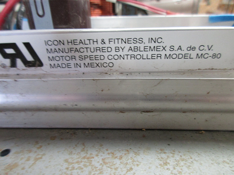

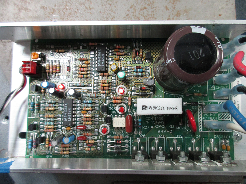

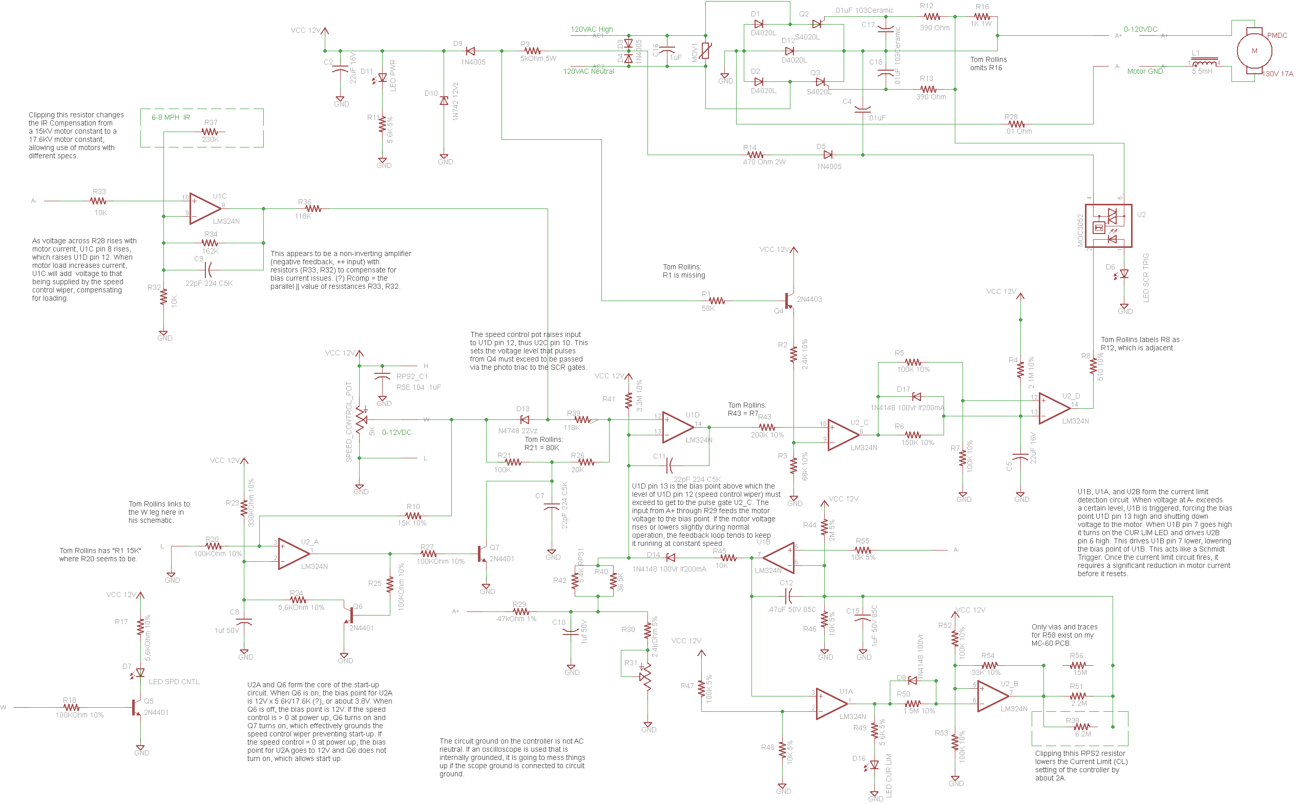

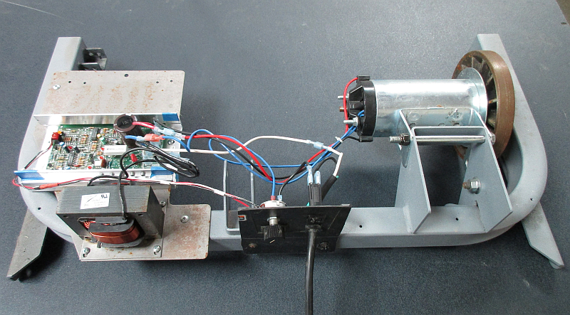

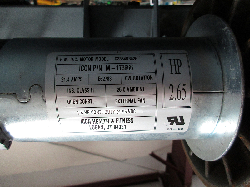

The treadmill I got had a MC80 controller. I posted a request for schematics on another forum, and MaxHeadRoom78 provided me with the attached MC60 schematics, which appear very close to what is in the MC80. I also attached my notes and some pictures of the motor and controller.
Here is a link that basically shows what I ended up doing:
MC60/80 replacement boards are all over the web, and are cited on a lot of machinist's websites.
