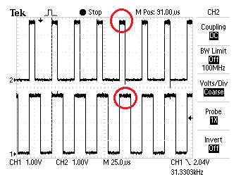

Typical PWM traces:
Note that the amplitude of the pulses is always the same. What varies is the difference in the duration of the pulse length. This difference is what speeds up (longer duration) or slows down (shorter pulse length) a motor.
In your controller, the IGBT (40N60) is really designed to act like a pulsed switch - simply on or off, for varying periods of time (with very fast transitions), and it reacts to a very low input signal level (saturation ≈ 2.1Vdc = 100% IGBT conduction). Thus, the pot mod you are considering won't (can't, really) work.

As for the controller we are fighting, I think I need an oscilloscope to figure what kind of signal/voltage actually send and receive the controller and the console, right? Then maybe some Arduino work would help bringing it to life. This may be be a winter project for me. Because I'm building a CNC lathe from scratch and I'll need a good PWM drive for it to drive the spindle motor.
