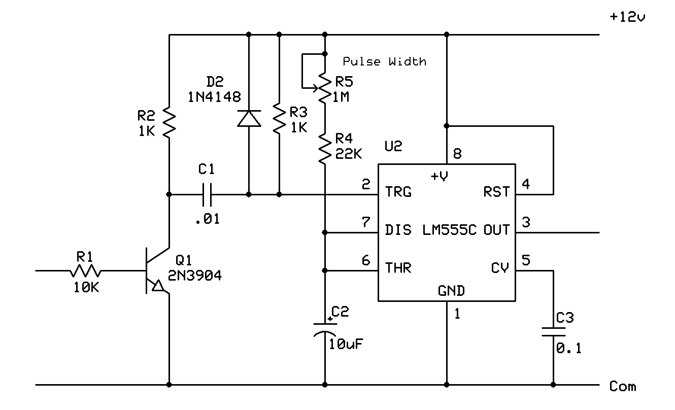

It will need to be just a little more complex than a single 555. For the first pulse, when the timer times out after "n", it will trigger again, as tehpulse is still active. You may be able to use a capacitor on the trigger pin so that the timer only fires when the input makes a high to low transition. In that case, a 555 configured as a one-shot with a period of "n" would be appropriate.
You'll also need to invert your input signal, as the 555 fires in a low pulse.
I don't know what supply voltage you have or what output voltage you need, but this should give you a fixed output pulse length triggered from the leading edge of your 1.5v button press signal.
Ken

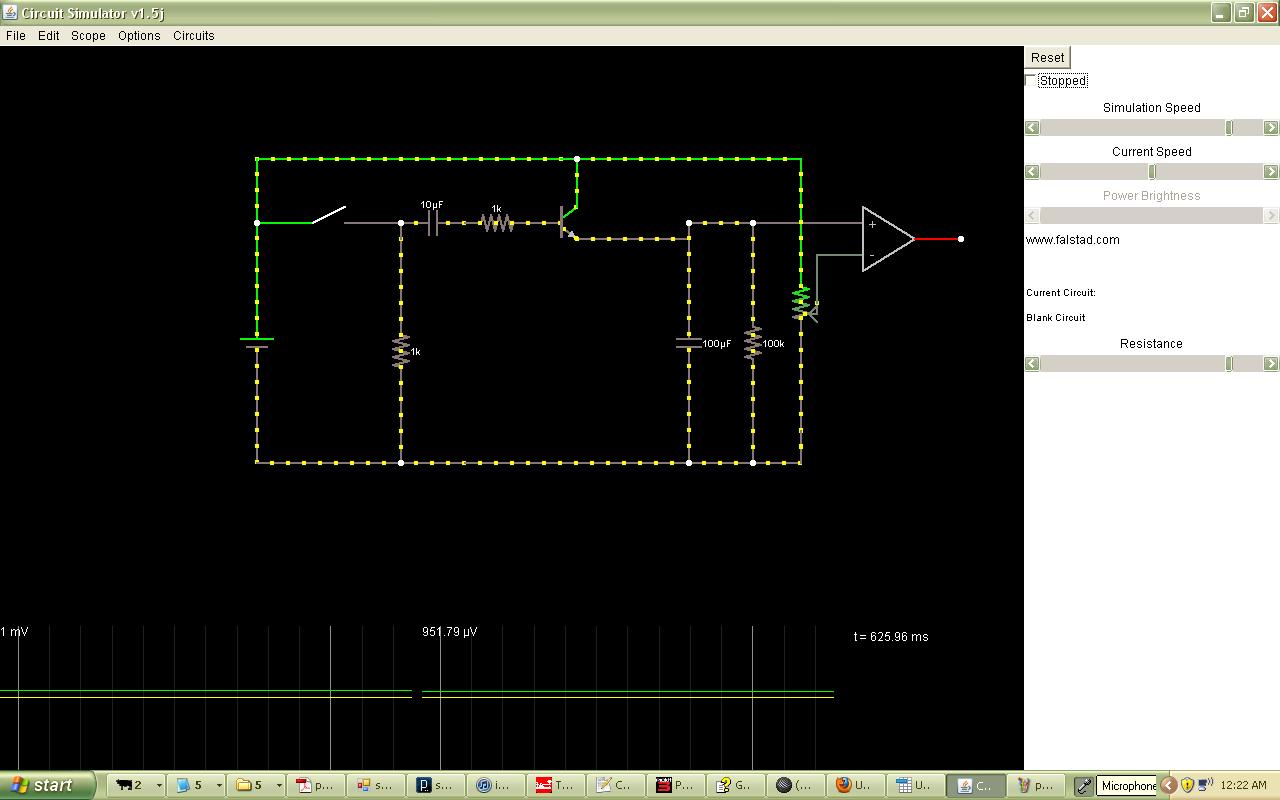

So, i had this great idea for how to do it, but it has one problem. if you rapidly press and release the switch the output will stay high. if that is not a problem this circuit might work. i haven't tested it outside the sim(which is not perfect).
Other then that, it works pretty well in the simulator, and has very few parts.(no triple 5 timer needed)
because its a potentiometer setting you can calibrate it to be exactly the pulselength you want.
the potentiometer sets the pulse time (and yes a short pulse will create a 5sec pulse)

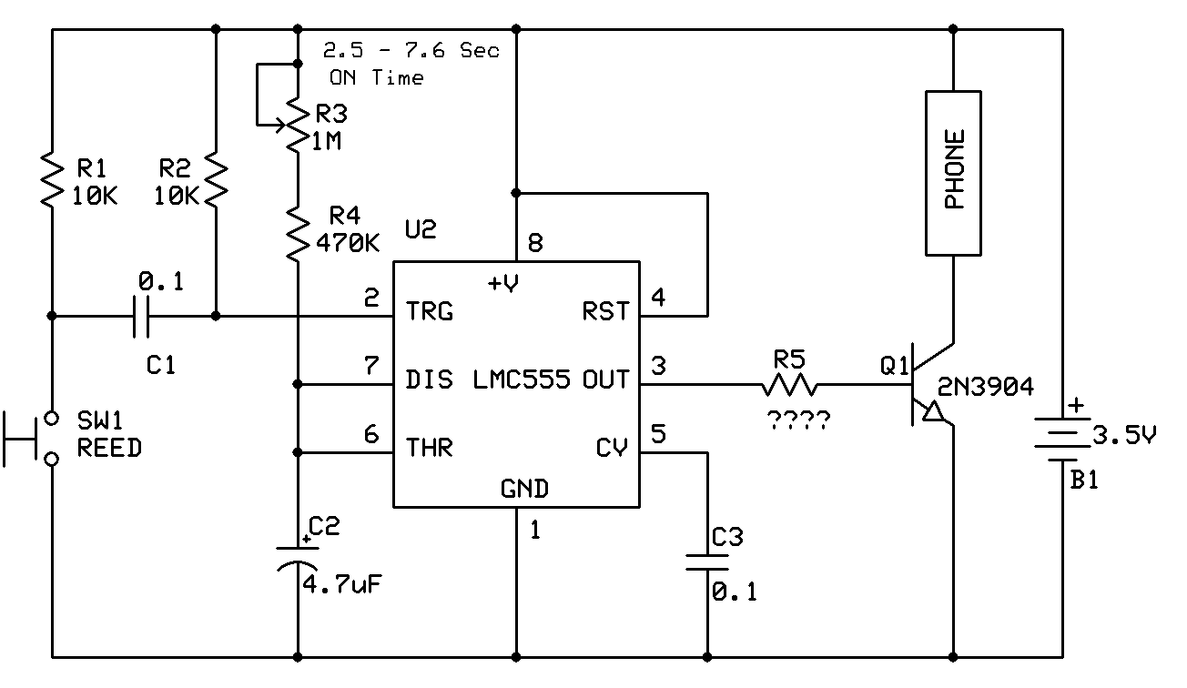

Do you mean that the phone must have the pos and neg of the battery connected at all times? If not, maybe this? The reed switch is a normally-open in this case. I don't know how much current the phone uses. I didn't include the rocker switch.
This assumes you can leave the battery positive to phone positive and switch the negative. If that won't work you would need another transistor and two more resistors.
Ken

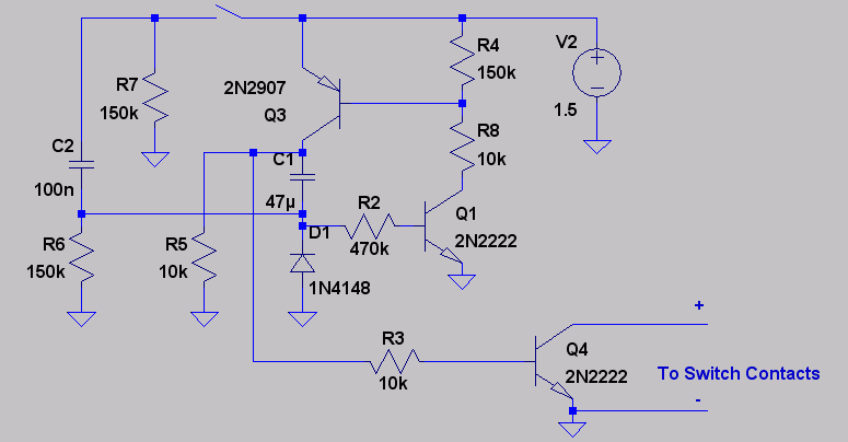

It should be possible to use a transistor to activate the phone instead of a relay. It's also quite easy to design the pulse extender circuit to draw a small enough current to allow it to last for a few years from a single AA battery.
It might also be possible to power the pulse extender circuit from the switch contacts themselves, depending on how the phone scans the keys. Using a diode & capacitor to take the power from the key mux and a mosfet and some RC for the rest. I have to go to work now, but I'll draw it up (if it's simple enough) if you don't get another solution in the mean time.
Here's a low-power simple pulse extender - has virtually no current idle consumption so you could run it from a calculator cell for the shelf life of the cell.
With the values shown, the on time is around 5 seconds & the retrigger delay is something like 1-2 seconds.
