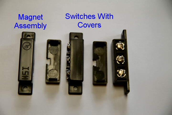

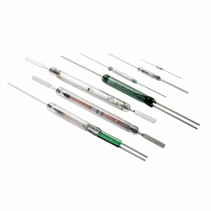

I don't get it? I looked at that switch on several sites and was unable to find much information about it. Typically magnetic switches look like the first attached image which shows several varieties. You can easily pick out the N/O and N/C as well as both in a single glass envelope. The second image shows a typical N/O & N/C switch with the 3 terminals (Common, N/O and N/C). They happen to be switches made by formerly Hermetic Switch, Inc. and is now is now HSI Sensing.
The actual switches shown in the image do have a cover piece but I don't see that in the original linked to images?

What I’ve been sent is exactly like the second image you posted except:
  • Rather than providing a screw point to attach wires mine has 2 wires already attach coming from the housing.
  • The unit it completely enclose. The reed switch is sealed inside a resin with just the 2 wires protruding from the housing.
  • Critically, there are only 2 wires providing N/O functionality, no 3rd wire to offer an N/C connection :(
