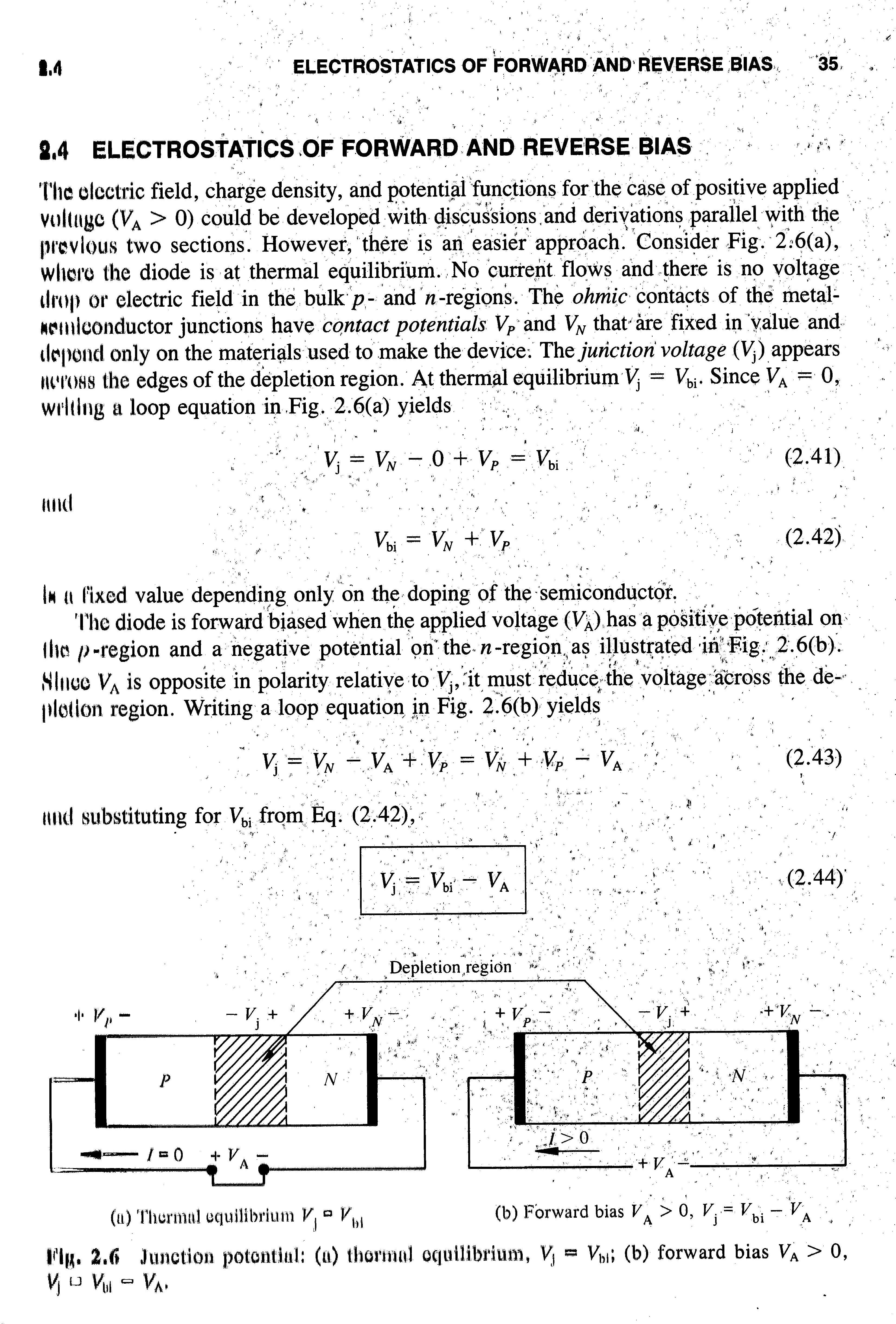

Brownout,
Φ = Φ1 - va, which is technically correct, all they are showing is that is it possible to force the junction voltage to be equal to an external voltage, per kirchoff's law. Unfortunately, however, to understand how vbe is changes, one needs junction physics theory such as in Sedra and Smith. One also needs to keep in mind basic laws of electronics physics. For example, the mesurement of potential between any two points includes voltage sources between those points. No voltage outside the measurement points can affect the measurement. One cannot show a single circuit where this principle is violated. Thus, although the junction voltage may be forced to be equal to an externally connected voltage ( which is never done in practice ) the external voltage can not change the junction voltage. It can only be changed by charge injected into the junction, per Sedra and Smith. And this, vbe is the same as junction voltage, as there are no other sources.
I am showing a attachment which shows that the junction voltage (Vj) is not, repeat not the junction voltage of Vbe as you state above. This page is from the book The PN Junction Diode, by Gerold W. Neudeck of Purdue University. Notice Fig 2.6a where the diode is shorted, and still there is a voltage of Vbi across the diode. What is more, Neudeck proves that is true by using loop equations. And when a forward voltage is applied, the junction voltage becomes Vbi-Va as shown in Fig. 2.6b. This agrees with the link I showed in my previous post. If you cannot accept that, then nothing will convince you what the value of Vj is.
Do you see in the illustration where the diode is shorted, and it shows I=0? If there is a junction voltage across the diode, then why would the current be zero? It's a basic law of electronics that for nonzero voltage and nonzero conductivity, there is non zero current, so whats going on here? Why is the diode voltage zero while inside the diode ther is a voltage? Things that make you go Hmmmmm.....?
Very simple, as I've said all along, your cartoon ingnores that very fact that the depletion potential is nertralized by the bulk n and p excess carrier potential. Thus, for the diode, the total junction voltage is zero, when the leads are shorted. The reason you are confused about what the junction voltage really is comes from the vocabulary, where your reference calls junction voltage what Sedra and Smith calls barrier potential. So to say "junction" voltage is vbi - va, in your reference, is equivilent to what Sedra and Smith would call voltage in the depletion layer being equal to vbi - va. However, you neglect that vbi is equal to excess carrier potential in the n and p regions, so in fact, for the total PN junction, the voltage is zero for the no external source case. Or in other words, for the bulk PN junction, vgs = vbi - v(bulk) - vgs = 0 - vgs = -vgs. So, in accordance with Sedra and Smith, when current lowers the barrier voltage by nertualizing uncovered charge, it changes vgs by the same amount.
Also, notice the equation vj = vn + vp. vn and vp are the potential that cancel vj, as I've said many time. It also says vn and vn are only dependent on the material, and not external sources. Thus, since only the depletion voltage changes, and vn and vp stay the same, and since vn and vp cancel vj in the non biased case, ie
vj + vn + vp = 0, and vp, vn doesn't change, then the formula given above is true, and Sedra and Smith are validated.
Brownout,
Why do I get the feeling that you still do not get it? See further explanation below.
Do you always call well drawn illustrations in textbooks "cartoons"? The neutralization is not important with respect to the point that Vbe is directly increasing or decreasing the effects of Vbi, thereby permitting more or less charge to flow.
No, Vj = Vn+Vp only at equilibrium.
Let's look at the attachment again. Neudeck is talking about the contact potential of the ohmic contacts of the metal-semiconductor. He is not talking about Vp and Vn being the contact potiental of the PN junction. If fact, metal-semiconductor contacts are used to produce Schottky barrier diodes. Anyway and always, Vn+Vp=Vbi, thereby cancelling, out the voltage at terminals b-e at equilibrium. At Vbe = 0, the junction voltage is Vbi. So changing the Vbe raises or lowers the junction voltage according to Vj = Vbi - Vbe.
Ratch
Get what? I know what I'm talking about
I couldn't care less how well they are drawn, but rather how accurately they describe reality.
The neutralization is very important.
EDIT 8/9 2:46pm - Yes, as I said, in the non-biased case.
vp and vn are important to the operatoin of the PN junction, and can't be dismissed.
vn and vp cancel vbi always, equilibrium or not.
vj = vbi - vbe is valid across the depletion layer only. Across the entire junction, vj is vbe. That's why you never see vbi in any of the formulas for current.
Brownout,
Then perhaps you could explain where the diagrams depart from reality.
That is not what you said before, but OK, now we agree that Vj=Vn+Vp=Vbi at equilibrium
Not true, as explained below.
The depletion layer encompasses the entire junction. Across the whole diode, the voltage is zero at equilibrium, even though the junction voltage is Vbi. So there are three contact voltages in play here, the PN contact voltage (Vbi) and the two ohmic voltages at the metal-semiconductor interface. At equilibrium, their algebraic sum is zero. Upon forward bias, Vj = Vbi-Va, so the junction voltage is lowered and more charge can flow.
The current value is given by the diode equation references the voltage across the whole diode and takes into consideration the temp, type of semiconductor, and a fudge factor. The voltage across the junction is internal and cannot be measured directly.
Ratch
They have various weaknesses. Most are too simple to be dependable.
It's exactly what I said before. I've re-read what I wrote, evidently you haven't.
My statement is correct, as explained below.
A PN junction is more than just a depletion region. What goes on in the bulk silicon is important too. vbi is cancelled by vn and vp during equalibrium and during forward bias. Nothing you've written has shown otherwise. Va changes and total depletion voltage changes, but vbi is still cancled, as it is nothing more then the intrinsic voltage, and does not change. In other words, the voltage in the depleation region is reduced to vbi - va, under the condition of forced applied voltage. vbi is a constant, however, and does not change. Hence, the voltage across the diode is, from the perspective of the steady state voltage, equal to -va.
The reason is because the change of barrier potential is identically equal to the voltage across the whole diode, the junction voltage ( as defined by Sedra and Smith ). This is bacause of the resaons given above.
