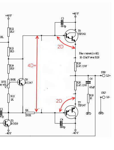

I currently learning electronics have a good understanding on how transistors work and ext however I have no idea how to explain it. Thank you fore listing these concepts, I will research these concepts. Is there anything else that I need to explain?
This is only a small piece. "Emitter follower" T8
Voltage gain is 1. Current gain is very high.
Current limit:
Current flows from +40V to output. R19 is used to measure this current. If the voltage across R19 is too big then T4 base to emitter will have 0.65 volts and turn on. When T4 turns on, it turns T8 off and limits the current.
There is another emitter follower just below this one. It pulls down to -40V.
A normal transistor needs 0.6 to 0.7 volts B to E for the part to turn on.
A Darlington transistor is two transistors in one. It takes twice as much voltage to turn on.
A diode = about 0.65 volts. So some of us say D=0.6 volts. 2D=1.3 volts.
T8 and T7 need 2D to turn on. We need both T7 and T8 to be almost on. So 4D plus a small amount is from T7 base to T8 base.
T6 makes this voltage.
If the output of the amp is zero volts then T8-base is +2D. (0+1.3V) And T7-base is -2D.
If the output of the amp is 5V then T8-base is 5+1.3V and T7-base is 3.7V.

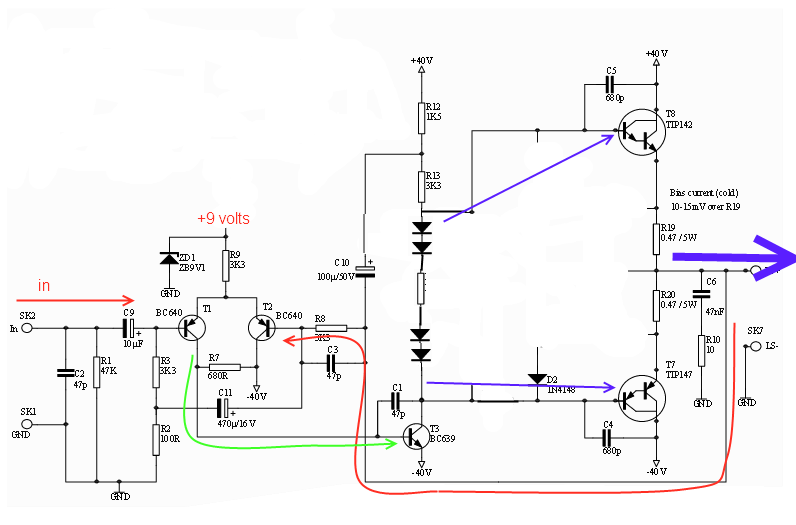

The amplifier's output should look just like the input but "louder".
T1 & T2 compares "in" and "out/300". If there is a difference it is amplified and sent to T3 which amplifies more.
I made the amp more simple. How this helps.
