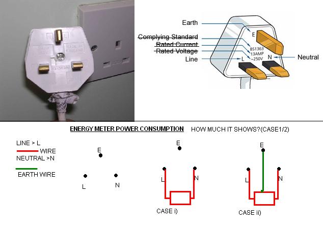

How Exactly Does Earthing Work?
It's difficult to make a computer monitor with no exposed metal parts because of the video cable.
Can i know why?
This is another ques:
Please tell me the differences in power consumption(when appliances is earthed/ and not earthed)
Will Power consumption increase, due to the complementary earth-chasis path.
1) With CRT monitors, the outer shield of the video connector was usually connected to the monitor chassis. The video connector is exposed to the user.
1a) With LCD monitors, it is common to use an external supply which is already isolated, and the chassis has no mains supply at all. Thus 'double insulation' is easier.
2) The earth-chassis path is not intended to carry current unless the equipment has failed. In that case the equipment should not be used. But no mattter where the current flows, the unit will use no more power than it uses.

Usually metal casing of the appliances are earthed; When the insulation fails, there will be contact between the internal circuitry and the metal casing. Since the metal casing will be earth, there should be some amount of current-flow. Hence Power Consumption should increase...

You're wrong, there will be a big BANG, the mains fuse will blow, and no current will flow.

You get a minor tingle, it's through the suppression components from live/neutral to earth. You get the exact same thing on diouble insultaed items as well, although in that case it's to prevent a high static charge building up on the appliance.
If an item has a three pin mains connection, then it's there for a reason - NEVER use it on a two pin circuit.

As you've already been told it makes no difference, or at least far too small to be of any consequence.
The device will consume precisely the power that it wants, no more and no less (exclusive of failures). The appliance is ignorant of the path upon which it arrives.
The Hot or Phase wire carries the +/- 150V sinusoidal AC signal
The Neutral wire sits at 0V at the electric company. it carries the RETURN current of whatever load is attached.
the Ground wire carries NO current and has NO voltage. it is not connected to any electrical circuit that you plug into the wall. It is only connected to the metallic CASE of an electrical circuit - that way, if there is a mechanical failure and something inside the case that carries a high voltage touches the metal case, a person who touches the case will not get shocked since all of the current will take the easier path to 0V through the Ground wire.
The earthing wire is supposed to be a safety wire to carry away accidental leakage or blow the fuse if a serious leak happens. Some appliances like microwave ovens have high frequency filters that are attached to the earthing wire and some small intentional current is caused by this.
Because the leakage is supposed to be zero on most machines, the absence of current in the earthing wire does not cause increased power consumption.
If your machine has voltage on its case when you are improperly using a 2 wire cord, use a 3 wire power cord. You could also investigate where the leak is, and repair the machine.
