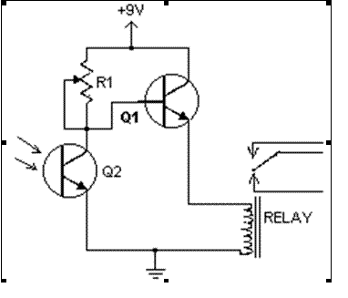

hey ..
there is the circiuit diagram of Light/dark detctor..
please tell me how it will work..?
i mean when there is dark..so what will be the respone??
the realy wont wokr..thats it..!
i dun have to put any led or some thing to show it clearly..???

The circuit is a poor design, where did get the design from.?
I think it supposed to energise the relay when the light detector is dark.?
rohaan said:
relay work when dark or when there is light..?
please make me sure bout it???
When Q2 is dark it has a higher resistance compared to when its lit.
So as Q2 gets darker the the voltage on Q2 collector will rise, this will increase the base votage of Q1. This increase of base voltage will make Q1 conduct more current thru the relay.
Eventually this increase in Q1 current will enegise the relay.
When Q2 gets more light its resistance falls, which reduces the Q2 collector voltage and so Q1 base voltage falls which causes a reduction in Q1 current and so eventually the current falls low enough that the relay de-energises.
The pot in the collector of Q2 is 'supposed' to enable the setting of the point of light/dark, when the relay operates.

Is it your design.?:confused:
The pot is wired/connected in such a way that it will be difficult, if not impossible to set up the light/dark point.
You have not stated the working voltage of the relay coil.
You will never get the full 9V at the emitter of Q1.
If you have built this already, measure some voltages light and dark and post them on the forum..

well the pot is connected as 1 leg to the 9v and the other one is connected to the Q2 collector and Q1 base..
m i right???
Am I crazy or should there be a protection diode for the inductive load?

hi rohaan,
What is the relay coil voltage and operating current.?
Whats the specification of the photodector Q1.?
What is transistor Q1.
Can you post the web link, so that we can read what the author claims.?
-BaC
I cant say if you are crazy or not, I dont know you well enough..:rolleyes:
But you are correct, a diode would be advisable.

If it's for University work then I wouldn't expect to get any sort of decent mark at all for handing something like that in - as suggested, it's an incredibly poor circuit, probably 'designed' by a 9 or 10 year old?.
Presumably you're not doing an Electronics degree?, as you wouldn't get on the course if you need to ask such basic questions.
No its not mentioned the relay coil Voltage..is it necessary?
the photo transistor is the Q2 not Q1.where Q1 is simple npn 3904.
