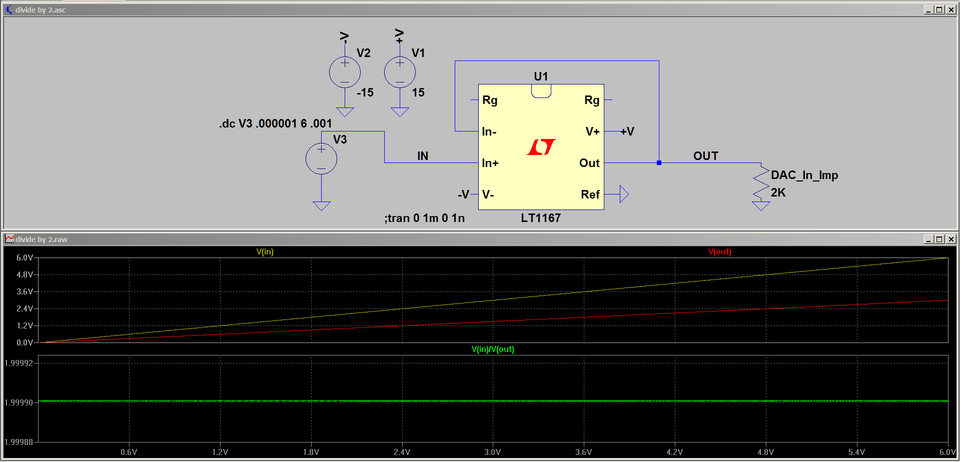

If you have a good inamp, programmable for a gain of 1, you can connect its output to its (-) input and the gain becomes 1/2. The precision resistors, high linearity, and low drift are built in.
Hi ccurtis, wow very nice! I wasn't expecting that to work, but I just tested it using the standard 3 op-amp instrumentation amplifier and it worked.. I don't have any dedicated instrumentation amp chips, but I noticed digikey carries the Burr Brown AD621 for $7. Datasheet says NONLINEARITY ERROR: 0.001% max, INPUT OFFSET DRIFT: ±2μV/°C, LOW INPUT OFFSET VOLTAGE: ±200μV.
You have something mixed up here. AD621 is made by Analog Devices, and it has a minimum gain of 10.
You could try the AD620, but LT claims their LT1167 is better (and it's 1/3 the price). But, truly, either of those two are pretty darn good. If I'm figuring it right, with the nonlinearity of either of those two inamps spec'ed in the 10's of parts per million, that should be good enough for a 13 bit DAC, just from the bit count, nevermind if your DAC can actually achieve full 13 bit performance. 1/2^13=0.000122% and 95ppm (worst case nonlinearity for the AD620)=95/1000000=0.000095%
