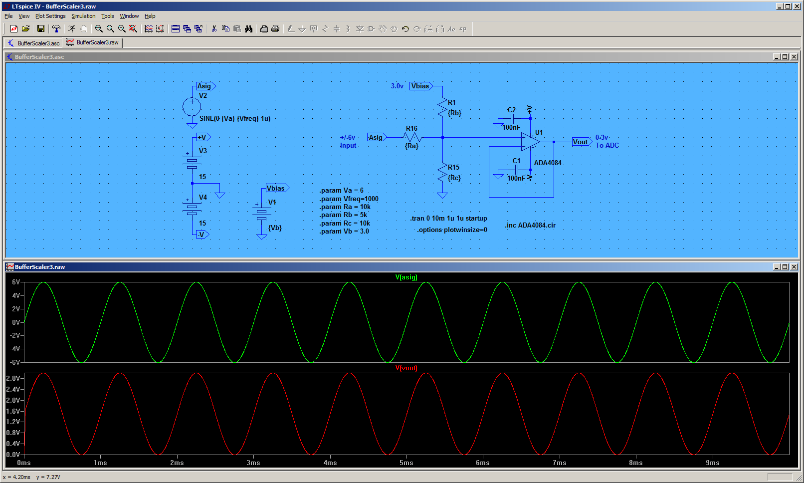

Hi
How about this?
+/-6v in, 3v out with 3v bias.
eT
