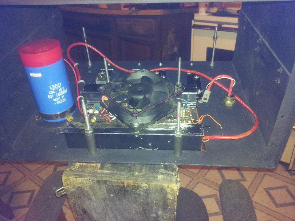

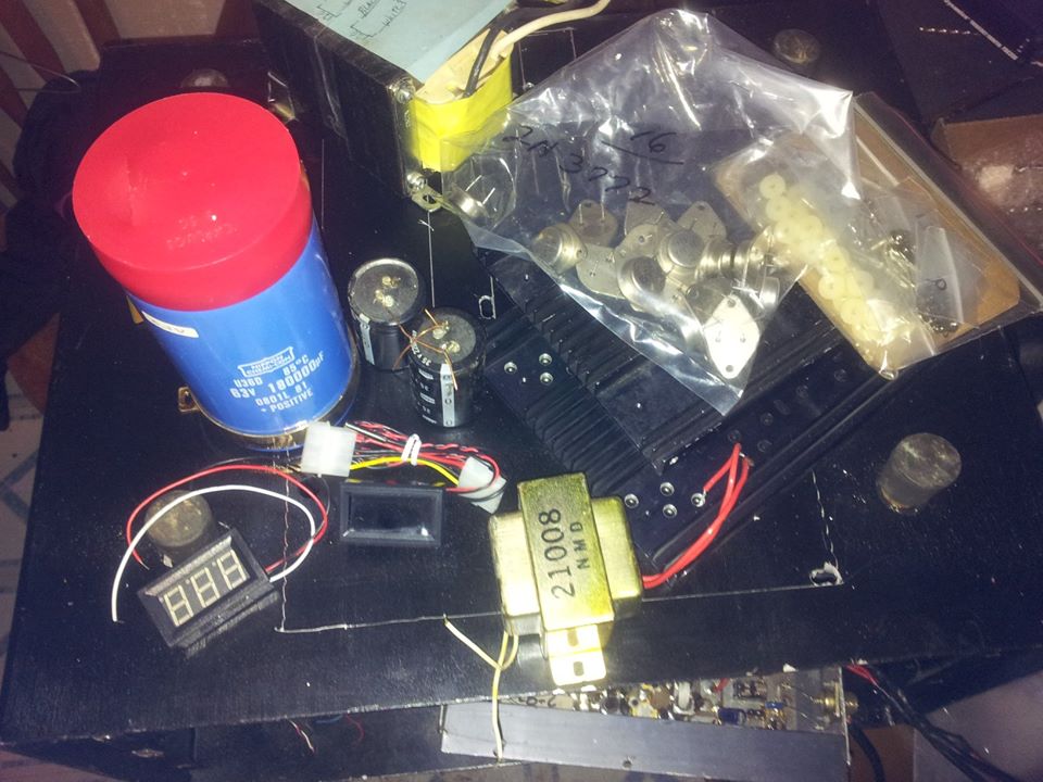

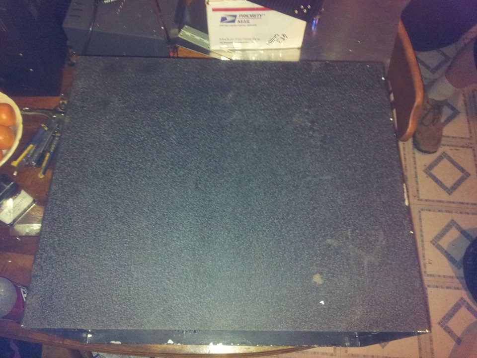

OK I am fairly new to electronics and then again, not so much! I have worked on CB radios and Ham radios plus HF amplifiers on and off my home life. I Have decided to build my own power supply. Not sure how to draw you a diagram but I can tell you what it consists of at the end of my problem question!

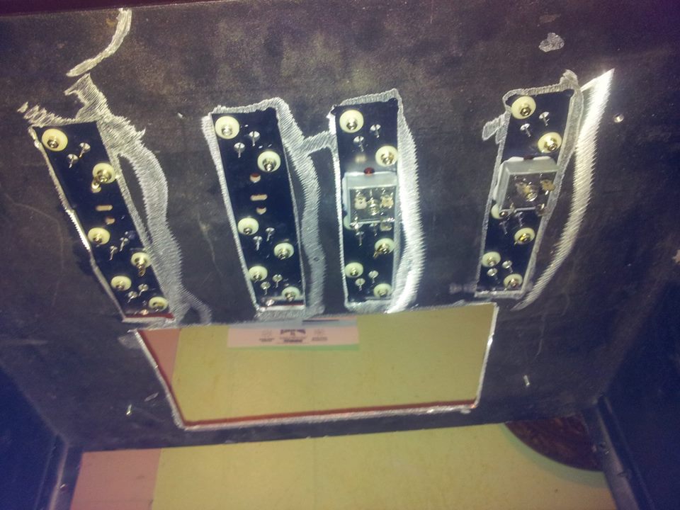

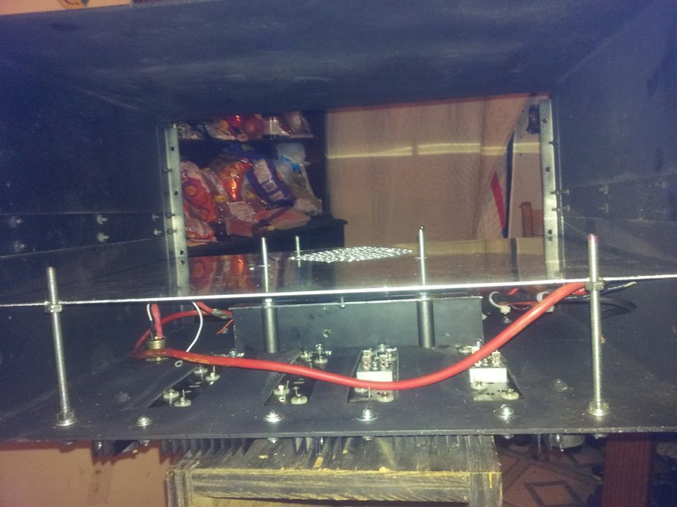

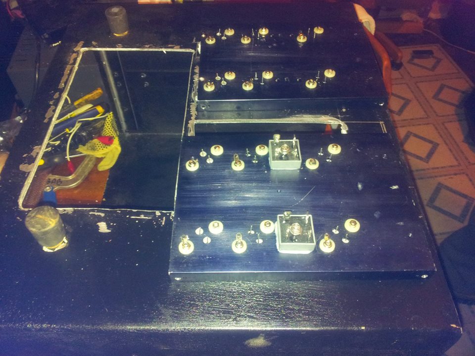

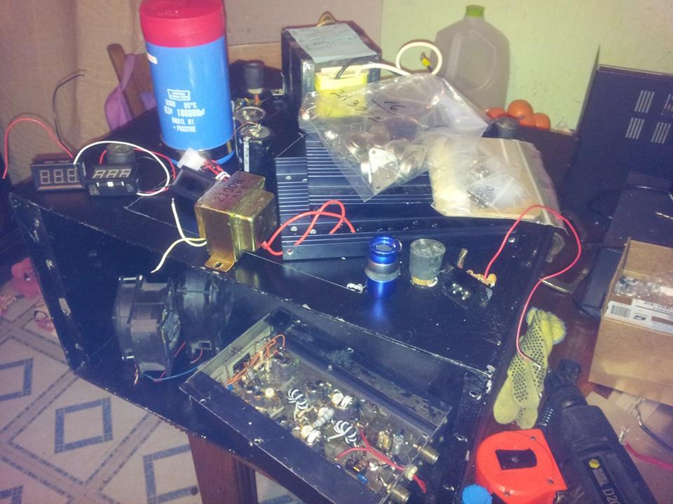

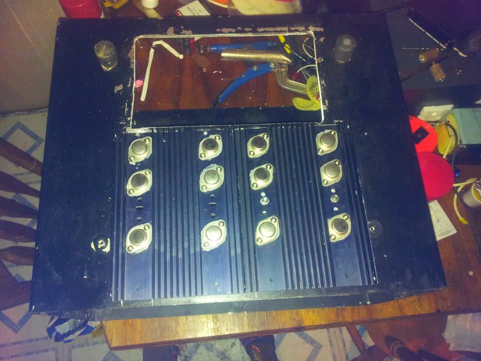

I am building a 100A variable(0V to 15+V) power supply I have 3 total TO3 heat sinks with a total of 13 2N3772's. 1 driving the 12( I had them so I used them!) Would like to know how to wire this up (Base drive line)??(Equalizer Resistor assembly)??( Collector Wiring)??, 1 driving 12? (CROWBAR)?? Also wondering if it would be better for a 2 driving 12 configuration.
I am using a
1)Peter W. Dahl Co 100A 3 stage 13.8V/14.2V/17.6V!
2) 180000uf 63V Filter cap!
3) Stock from Astron, Dual 100V/1000A Rectifiers!
4) 8 or so current limiting resistors 0.5ohm/5W!
5) Stock from Astron Regulator board with LMR723 with pre driver and variable!
6) Some type of RF Bypassing for AC input? Not sure maybe some info on this subject!
7) Some type of RF Bypassing for DC out? Not sure maybe some info on this subject!
8) Digital Current meter with or without Shunt??? Will I need a Shunt? Not sure maybe some info on this subject!
9)Crow Bar 1913, 110A SCR
10) All Digital meters for AC and DC including digital temp gauges for inturnals,( Because I have them)!
Any info will greatly appreciated! THX Bill
Looking to build a variable volt 100A power supply with crowbar circuit! Just wanting any info or ideas you guys may have on this design. Also wondering if I can get someone to draw me a schematic if I give them the parts I am using and maybe tell me if I am leaving something out. This is a great form. So glad I found it. Any info will be great even if it is to say I am a dumb ass. That is better than no feed back what so ever. THX

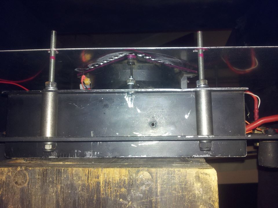

This is going to be used to power a HF linear amplifier! The amp has 6 2879 transistors! It will also be used as a bench powersupply for anything I may be performing work on at the time!

What are you going to use for the INPUT source for this thing?
Is it to be powered by 120vac or something else?
For that you need either a big transformer or build a good quality (buck) switching regulator.
CROWBAR circuit assures that all 12 2n3772's get exactly the same voltage and amperage! This way not just 1 2n3772 takes all the power at once.
I am using 1 2n3772 driving 12 2n3772. To assure that all 12 get the same power at all times. The Crowbar circuit is ideal for this application.

Yes Jim, Billy is completely confused about what a crowbar circuit is - it's called that because it essentially 'throws a crowbar' across the power supply terminals, causing the fuse to blow.
You wouldn't normally place the crowbar across the output of the supply though, the monitor circuit monitors the output, the crowbar thyristor would be across the output of the bridge rectifier (input to the regulator) to avoid damaging the regulator circuit.
Balancing the load equally across the multiple transistors is achieved simply by suitable emitter resistors balancing them out.
