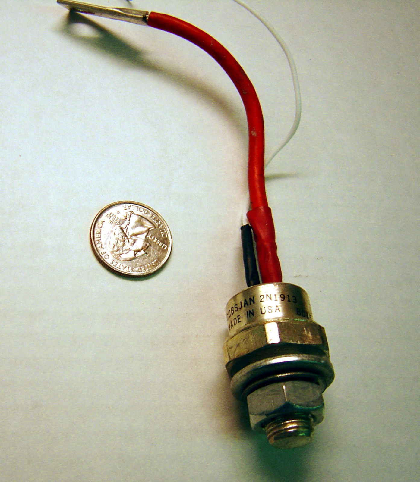

This does not have to be a crowbar set up! I have the SCR but it does not have to be used. SCR 1913 pictured

Billy....
I think the original PSU design was brilliant.....just your confused Crowbar understanding worries me.
You asked for advise here...and we are generally accurate. Not a bunch of chancers.
Personally, as much as you wan't to build this, I think you are going to battle....
And you are dealing with massive energy.....not for the faint hearted..even practised pro's would think twice...
I wish you luck :)
All the best,
tvtech

t fully understand. I thought it (SCR) did more than 1 specific thing! I had the 2 SCR1913's and thought it would be nice to include one in the power supply. I have a 110 and a 75! Now that that has been said, I sure thought this was going to go differently! I was thinking I would say what I had and what I wanted to do and then people would say" you can or cannot do this or that then I would get info on how to do so" Not the case thus far! I have learned what a SCR does and a Variable voltage wont work with it. I am learning! Lets forget about the variable voltage! I need this thing to power a amplifier ans a couple other smaller devices! Amp Freq counter some LEDS and thats about it! 80A max. Maybe I send some pics of where I am now and you guys tell me if I am going at this the right way or not?? I am at a stand still here and need some help badly.

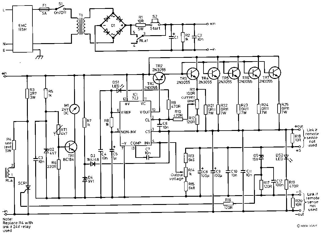

I understand that this is something that could potentially kill me or someone else it they got into this thing opened. I understand that 180000uf is not nothing to screw around with. This is not my first power supply tho! I have built smaller ones! I However I have never built one using 1 2N3772 driver driving 12 nor have I ever built one with a SCR Crowbar. You guys I would like to think are pros here! I am here for your help! If the SCR is not needed then I wont use it! I am goingto build it tho.I have to much invested not to. I am in the process of making a schematic for you guys to see and tell me maybe where I am going wrong! I started it last nite but lost it because I forgot to save it! Ill try again this evening.THX
I like a separate current shunt so that it can be integrated into the current protection/limit. You definitely want a variable current limit/protection for the supply, especially if using it for light loads.

The 'equaliser' resistors are simply fed from each of the individual 12 emitters, and their other ends all joint together to create the final output.
One 2N3772 drive should be fine, VERY crudely each output device provides 10A, so assuming they need a base current of 1A the driver needs to be able to supply 10A as well, and needs 1A base current itself - which comes from the TIP31 (told you it was CRUDE!!)
Take a look at this and see what you think:
There may be a couple of things you need to add like inrush current limiting.

An interesting circuit.
I am nor sure that I like the so called "Overvolt Protection".
And what on earth is going on with that voltmeter circuit?
Where did you find that circuit, it looks like it is cribbed from an RSGB publicaton?
It has inrush current limiting, R1/SW2/RLa. You'll have to hold SW2 until RLa latches. Could you please supply the text that goes along with the circuit? There are obviously some subtleties going on e.g. DS1/R9.
I never got to the site itself as I got a virus warning. You can get there (I think) by googling high current power supplies and looking thru the pictures. I think the diode indicates over current.
Yes, interesting voltmeter circuit. :wideyed: I was just looking around for an example of parallel transistors trying to help with the first post. :D

Outstanding RonV this is nice to have. I have seen some that look like thin online but nine with the Inrush Current Limiting! Thx RonV
Guys I am going to to my best to build a schematic tonight for ya! I hope if I can do this properly maybe you guys can tell me where I am going wrong! There are some circuits I dont know where they go so I may have to leave some connections out. Maybe someone can pick it up and finish it for me. This is the hole reason I started this post was to find out how to connect some of these components. I am a welder and a Diesel mechanic so unlike some of you guys I am not around circuits like this every day. Any information will be greatly appreciated. Thanks Bill
