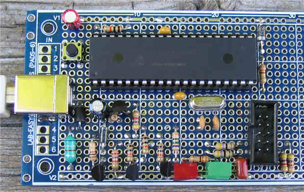

I f you have access to another programmer to pre-program a PIC18F2550, It appears better that you assemble the Junebug locally and it would work well
perhaps you may have to look at the availability and cost of set of parts. as compared to pickit2.

If you are interested in making a programmer part of junebug, perhaps assembly instructions manual could come in handy for you
and you can assemble one on a general purpose board, a jpg is attached below thanks to Bill of Blueroom and EDAboard
