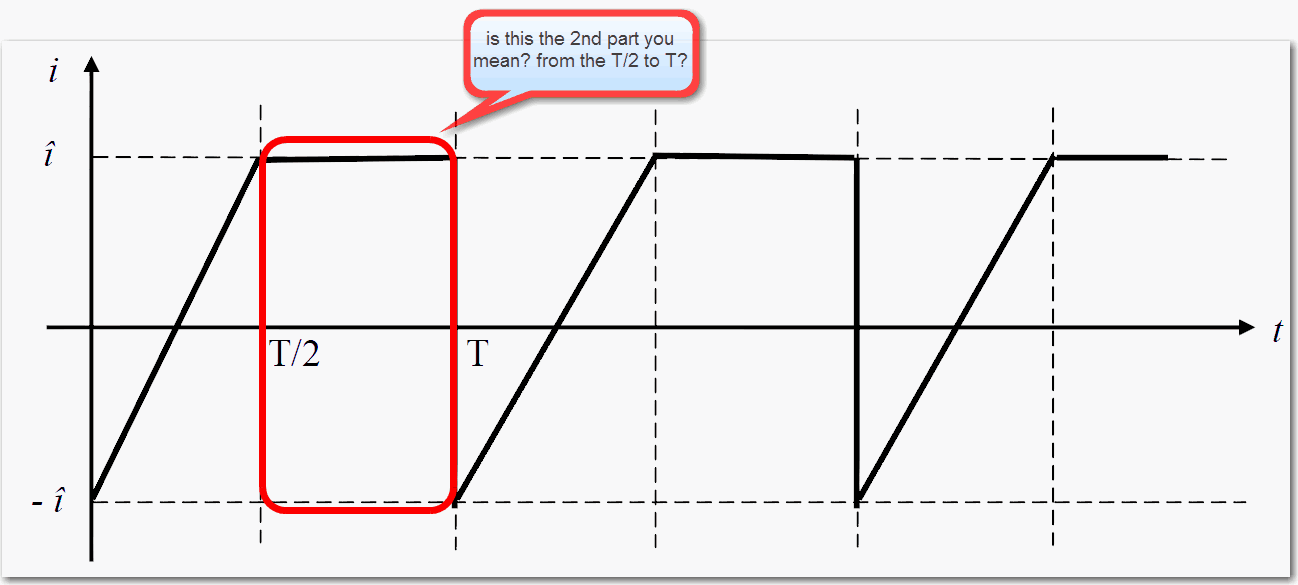

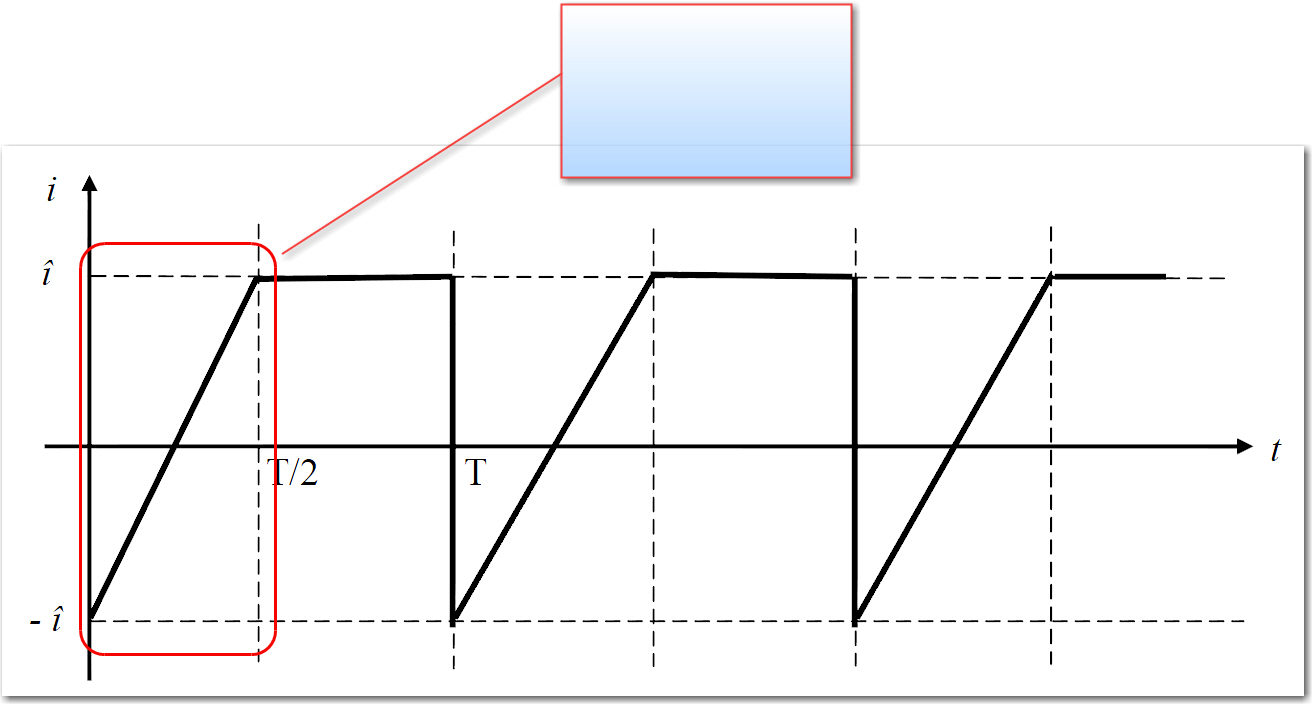

Your wave is divided in 2 parts.
The first part is a function of time, the wave grows as the times goes by, isn't it?
The second part is a constant. Even if times goes by, the wave remains the same, with the same value.
thanks. i'm still trying to understand why is the first have 0.25T i^2 as what dknguyen mentioned. If the area of triangle is = 1/2 bh. What would be the base here?
does that mean: 1/2 b * T/2? for the first triangle?
Yeah, I ran into this problem when doing the problem for you as well and it took me a while to realize what I did it two different geometric ways and they were giving me two different answers. ANd here it is:
"THe area of a function is the area between the function and the ****X-AXIS****" Not when the "big" triangle looks like it has bottomed out because if you look closely it never really does. Your brain just draws a line there to form a full triangle when there really isn't one.
So there is actually the positive and negative triangle to calculate the area for (and remember the triangles are squared before the area calculation so they will be positive and won't cancel to zero when you add them up.)
Of course, if you just do everything based off the equation of the line, you don't need to worry about this since it all takes it into account. But if you do it geometrically, you do
