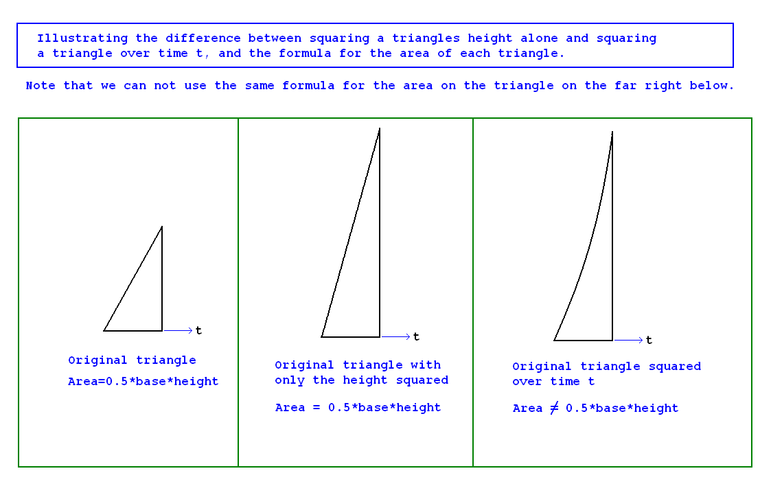

I did do that. I squared the Y-axis values (or height) before multiplying them by 1/2*base. I just stopped saying the "square of the function" because I've said it like about 20 times in my previous posts and it got very confusing to follow the post with such a frequent wordy phrase.
The area of the first little triangles is:
One Triangle = 0.5*base*height = 0.5*(T/4)*i^2
But there are two of them, so the total area of the first half is double that:
Both Triangles = 2*0.5*(T/4)*i^2 = (T/4)*i^2
Area of the second half (the square) is simply:
Square = base * height = (T/2)*i^2
Add up all the area and you get:
Total Area = (T/4)*i^2 + (T/2)*i^2 = (3/4)Ti^2
Divide by the total of the period to find the average area over time and you get:
Average Area = (1/T)(3/4)Ti^2 = (3/4)i^2
FInally square root the whole thing to get:
RMS = i*sqrt(3)/2
Hi again,
Well, what you have done is made bigger triangles by squaring the height of the
triangle alone, when you really have to square the entire triangle over time t.
When you use a formula like 0.5*base*height, that means you are sill using
a triangle that has three *straight line* sides (ie a normal looking triangle)
when the triangles that really represent the area have only two sides that are
actually straight and the part of the triangle that is normally slanted (and straight)
becomes a curve instead of a straight line.
You'll have to figure out some way to calculate the area of that new pseudo
triangle (it isnt really a triangle anymore).
Here is an illustration showing the difference this really makes:
Ahhh, i see now. A sloped line that is squared...obviously becomes a curve! I see now. It does not scale linearily.
