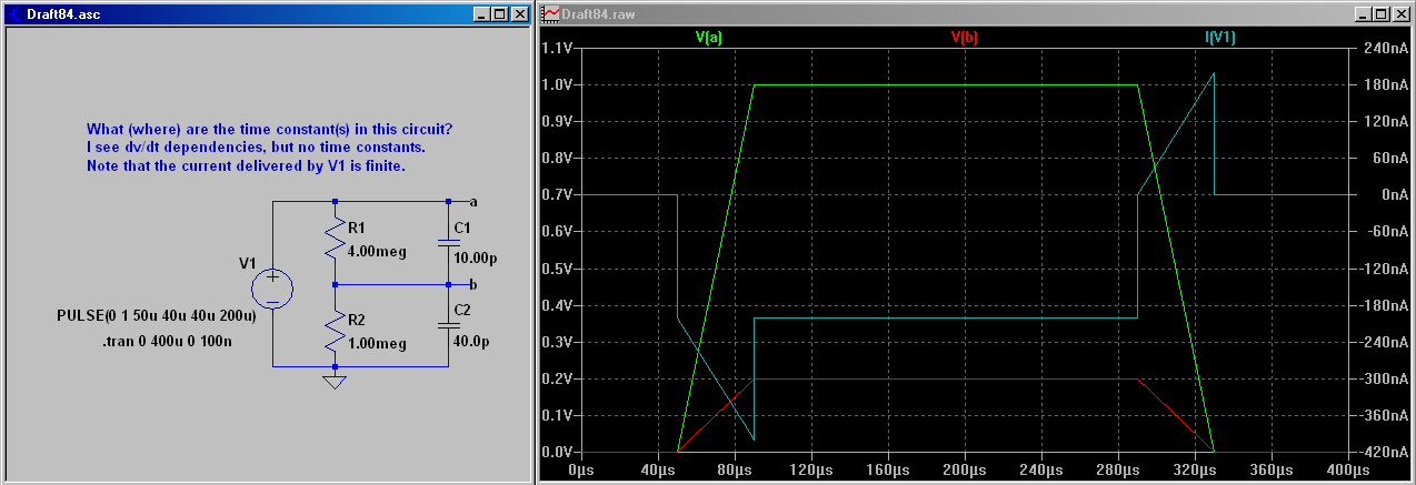

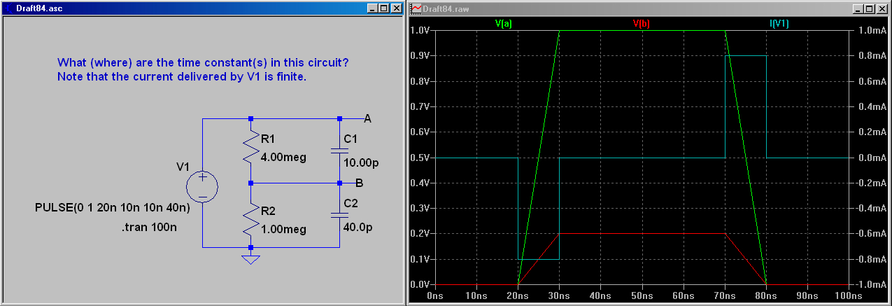

How to find the time constant?
Well, saying there is one or two time constants when they seem to be equal is somewhat of a pointless debate. The important thing is that the system becomes first order and there in only one degree of freedom from a dynamic point of view.
What about the case of two caps in series or two caps in parallel (or two inductors arranged as such)? Is there two time constants or one? Both cases become first order, and just because there are two elements does not mean the dynamics is second order and that there are two equal time constants.
But this is somewhat of a strange case, so I can live with someone saying there are two equal time constants. I just dont' think it means much.
It means that there are two storage elements could have different energy storage values. What does the TC of a system mean, anyway. The TC refers to the storage component, not the system. Yes, series/parallel resistors/caps can be combined if the resistors have the same currents and the caps are supplied with the same voltage. But, that is not the case in this circuit.

OK, that's fine. I can see your logic there. In this case the two caps are exchanging energy between each other. That's the dynamics of what is happening and one time constant value describes the interchange. If you want to say that means two equal times constants, I can't really argue against that. But, the dynamic system is a first order with one relevant time constant. This means you can find an equivalent system with one energy storage component, which I believe is what MikeMl did above. Still, you may prefer to say the real implementation has two time constants. Again, I don't see a lot of usefulness or meaning to it, but you do and perhaps others would too.
We really need more input from the questioner for this. Questions like this usually come from a book that has been assuming lots of other stuff all along and so it is not stated repeatedly for each individual problem.
If we assume small source series resistance Rs like 1uOhm it will be very difficult to see the response assuming R1 and R2 are much higher. So if we choose Rs=1 Ohm that might be a little better.
The two basic mechanisms here are:
1. The Rs and C1 and C2 time constant during start up.
2. The C1 and R1 and C2 and R2 time constants some time just after start up.
Rs being small means the initial time response is dominated by Rs*C where C is the parallel combo of C1 and C2. That simply means we'll see a fast rising exponential at the junction of C1 and C2. The resistors R1 and R2 wont play much of a role at this point in time because C1 and C2 set the short time voltage level at the junction.
So the voltage output starts out at 0 and stops rising after maybe 5*Rs*C. At that time it will reach a voltage of C1/(C1+C2) times the input voltage.
Next, the other time constants come into play if the resistor values do not match the capacitor values properly. If the ratio of the two resistors match the inverse of the ratio of the two capacitors then nothing else happens. If they are mismatched however, then we see the second time constant start to take effect.
If the ratio of the two resistors is such that the junction without caps would force a higher voltage than with the caps, then the voltage will rise. If the ratio is such that a lower voltage would be pressent, then the voltage falls.
For example, if R1=4k and R2=1k and C1=1uf and C2=1uf, the voltage would rise exponentially due to Rs*C and reach the max level of approximately Vin/2, then start to fall slowly due to exponential R1 R2 and C1 C2 time constants until it reached Vin/5. So with 1v input, it would rise very quickly (but not instantaneously) to 0.5v, then slowly back down to 0.2 volts.
However, with R1=4k, R2=1k, and C1=1uf and C2=4uf, we'd see a fast rise to 0.2 volts and it would stay there. This is how a "fast" bias network is built up where we need a reference voltage that is filtered but it has to be able to rise quickly for starting the circuit. The capacitor values have to be oppositely matched to the resistor values.
With the inclusion of Rs, the question of the time constants starts to play a real role in the circuit behavior. When we compare time constants that tells us a little about the basic operation of the circuit already. For example, with very very small Rs we have a 'stiff' differential equation that could be more difficult to solve numerically but with Rs more comparable to the other resistors we have a much more relaxed situation. We like to know the comparative difference sometimes and that comes from knowing the time constants:
Rs*C
R1*C1
R2*C2

Well the problem isnt so much what the VOLTAGE would be across one of the caps, it's what the CURRENT will be through the caps. We must look at both V and I to see what is wrong when we dont have a series resistor for the voltage source. With zero Ohms for the voltage source series resistance we can say superficially that we have two parallel RC circuits, but the circuit is not sound so we cant be sure if we have the right answer or not yet.
The voltage across the bottom cap for example comes from:
vC2(s)=((s*C1*R1+1)*R2)/(s*C2*R1*R2+s*C1*R1*R2+R2+R1)
and with a step change on the input (a DC voltage source) we have:
vC2(t)=R2/(R1+R2)-((C2*R2-C1*R1))/((C1+C2)*(R1+R2))*e^(-at)
where a=(R1+R2)/((C2+C1)*R1*R2)
and with an input voltage of 1 volt and R1=R2 and C1=C2, vC2(t)=0.5 volts which is a constant.
But when we look next at the current we see:
I(s)=((s*C1*R1+1)*(s*C2*R2+1))/(s*C2*R1*R2+s*C1*R1*R2+R1+R2)
and for a step change input if we solve for the initial value I(0) we get:
I(t)=infinity
so we need not go any farther :)

Hi again,
A time constant has dimensions t and appears in the exponential as in 1/t. So really anything we can express that way we might be able to call a time constant. Once we multiply that 1/t by t we get a constant.
Looking over Heidi's linked paper i see that they make a habit of making the assumption where we are to ignore the infinite current during startup with a DC source, and just approach the problem from a more simplistic viewpoint where we just short out the DC source and go from there. See problem #9 for another such example.
But as to the time constant(s), sometimes we view a circuit as having two time constants even when it only has one true exponential. That's because sometimes we want to make a rough comparison of the "two" time constants as for example when we want to try to figure out which is the "dominant" time constant. In that case we would be seeking to try to eliminate one of the "two" time constants so that we could simplify the analysis. So we might have an exponential part that looks like this:
e^(-t*(1/T1+1/T2))
where T1=R1*C1 and T2=R2*C2.
Clearly we can combine the "two" time constants and obtain:
e^(-t*(1/T3))
where T3 is equal to T1*T2/(T1+T2).
So we can call this either one time constant or two time constants, depending on what we are seeking to understand about the circuit. It's also obvious that if T2 was much larger than T1 then T1 would dominate and we would end up with:
e^(-t/T1)
which would make an approximate analysis much simpler.
In the strictest sense of the definition there's only one time constant but that view is often too restrictive when there is an obvious significance to the view with more than one time constant. For this circuit for example we might want to understand what we have when R1C1>>R2C2, and although the response itself only has one exponential it will certainly be of significance to think of having two time constants, especially when they are very much different from each other numerically. Couldnt we also for some reason want to look at the time constants R2C1 and R1C2? If we find significance in this calculation (and i think we can) then we will want to think of them as time constants as well.
So it all depends on the viewpoint. For the original problem however it appears from the linked text that they want a simple combination that results in only one time constant, and that comes from shorting the power supply source.

MikeML,
The time constant for each cap is 40us. Your Spice shows only a 10ns pulse. I suggest a 200us pulse to see an exponential effect.
Ratch
How about 200us? (5 "time-constants") :D
