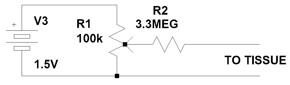

how to have from 0.03 to 0.9 Volts DC output and 0.1 microamps (100nanoamps)?
But the problem with your scheme is that your high-value current-limiting resistor will also reduce the voltage being applied.
It has a max of 0.5V or 150nA.
I assume the source of the technology may be here Dr Robert O. Becker: Silver Iontophoresis (Regeneration by Silver Ions), in which case he uses a power source in series with a very high value resistor resistor which shares/suffers the phenomenon described above.
What does the OP want? A source with a rectangular V-I characteristic?

As you asked for the schematic of what I described (via PM), here it is.
I'm pessimistic re expecting results (i.e. regeneration of tooth) from this procedure but you're of course entitled to have a go.

The posted circuit will not cause negative spikes.
For a 1cm electrode & 100nA/cm, you need 100nA. For 2cm, you'd need 200nA.
