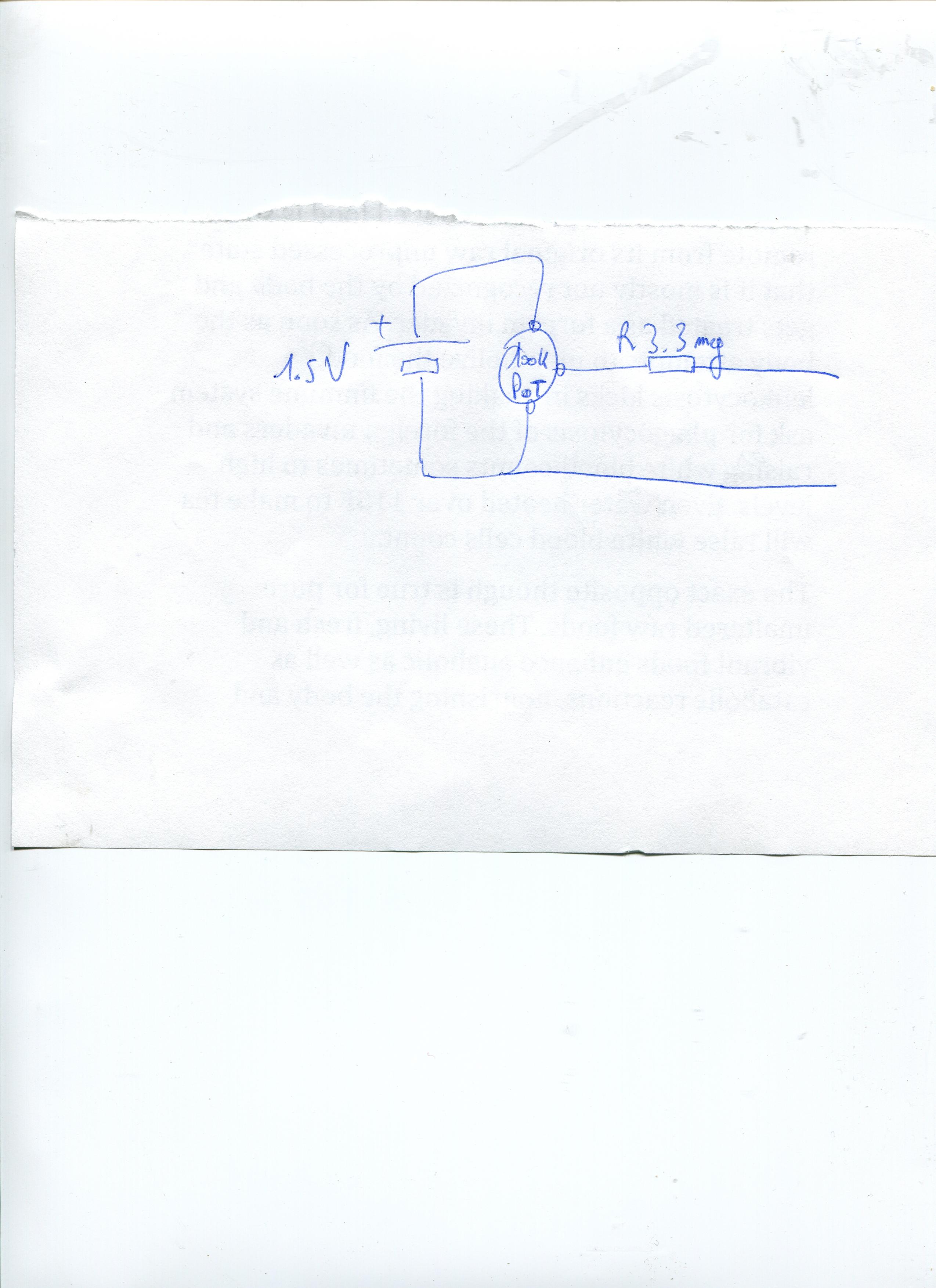

how to have from 0.03 to 0.9 Volts DC output and 0.1 microamps (100nanoamps)?
Would it be like this?

Would it still work, though, with the 100k pot and the 3.3M resistor? or not really? And is the circuit correct (although I can't draw a real one)?

In reality, you need to do an experiment and find out what the compliance would have to be. The experiment would be the silver contraption and an ohmmeter. Then you have a chance of designing the circuit. Electrode size, I think would change the voltage dependency. I;d look up the patents referenced. patents.google.com

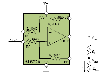

The pic with the AD8603 is probably the way to go. The system would probably have to operate on plus and minus 2.5V power supply. Operating near ground is tough without what's called split supplies. +-2.5 is not common, but since the currents are low, one can use a switching regulator to get to 5 V and then use a power supply splitter IC to create the ground in the center.
With the right reference and choice of resistors, you should easily be able to achieve 100-200 nA. Printed Circuit Board layout at these levels is critical.
The LM10 **broken link removed** would probably be a good choice for the reference to set the current.
So, with a few parts, you have a current source that meets your needs with a +-2.5 V compliance (give or take)
This is a possible "rail splitter" https://www.electro-tech-online.com/custompdfs/2011/06/tle2426-ep.pdf. You'll need a DC-DC converter to get 5V. Possibly 9 VDC to 5 VDC.
This one **broken link removed** used an input of 2V to 3.6 volts.
You now have a basis for some sort of design. What's missing is how to set the compliance voltage and indicate out of compliance. This is where it gets tricky and I need to think some more.
