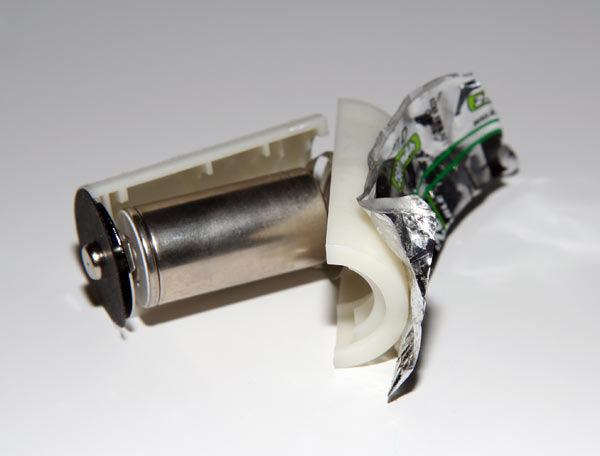

I have some "D" rechargeable batteries with "C" batteries inside. You can check by weight.
Here is a picture from "funny image thread".
