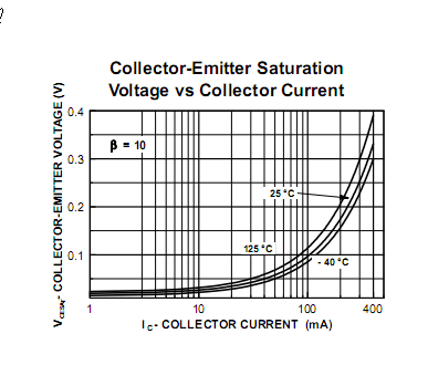

Looking at this extract from your datasheet, note the Beta 'β' value on the graph, tell me what you think about your base current calculation.??

The tutorial is WRONG!
The datasheet for every transistor shows a very high base current so that a transistor saturates well.

audioguru + Eric: Ok, so I should ignore the graph that says Typical Pulsed Current Gain vs Collector Current because that is calculated by applying 5v to C and E which uses the transistor in a different way (not as a switch as I want). The graph which Eric shows B (another term for hFE) is very low at 10. Using the formula, B = Ic / Ib, it would be Ib = Ic / B which is Ib = 200 / 10 (so this is where you got the 10 from!) = 20mA. So for 300mA Ic I need 30mA Ib and so on.
So that's right?
What is your 5V signal source? Is it still 5V when it supplies 30mA? Is it able to supply a current as high as 30mA?
