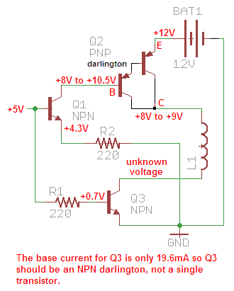

Hey Eric, you got me to thinking about the other transistors, PNP. Ignoring the resistor values, the below schematic should provide 12V to the motor?
Then all I have to do is add the diodes and the other three transistors for the other direction. Is it right to say that Q1 doesn't need a resistor on the base because it's actually on the emitter? Also it appears that the hFE of Q1 doesn't matter either as it will only make a very small change because we are dealing with small currents (20mA for Q1 C and E)?
Depending on the resistor on Q1 emitter it changes the mA of the Q2 base, how can we know the maximum mA that Q2 base can accept?
If you omit the R2, then Q1 and Q2 will probably die. As the schematic is constructed, R2 needs to be there. Remember that voltage between emitter and base cannot exeed about 0.7 volts. Above that will kill the transistor.
Thanks Grossel, so as far as you can see it all should be fine because R2 is there? Do you think any improvements could be made to this circuit or is it good enough as is?

So lets say I choose this PNP: https://www.st.com/stonline/products/literature/ds/5064/2n6036.pdf
It mentions the Emitter-base voltage as 5V. In Q2 PNP, the base is 11.2V and Emitter is 12V. Does it mean that the max difference between emitter and base can be 5V, so in my case I'm fine? Or as it's emitter-base voltage and I'm using it for collect-emitter, this 5V doesn't matter?
Also the Vce, it says maximum is 3V, is this the maximum loss of voltage between collector and emitter that occurs when at 4A (so my 12V would be 9V) or is it something else?
it is not a pNP transistor. It is a PNP darlington transistor that is two transistors.
That is its max allowed reverse voltage. The emitter-base will never have a reverse voltage in your circuit.
No.
A single power transistor will have its base at about 11V. This darlington transistor will have its base at about 10.5V.
No.
The darlington transistor begins to conduct a small current when its base is 11V and it conducts 4A when its base is as low as 8V.
The max Vce is 3V when its collector current is 4A and its base current is 40mA. Every transistor is different, some are better than others. The graph shows that a "typical" transistor has a Vce of 2V.

The datasheet has Electrical Characteristics that says the base-emitter saturation voltage is a max of 4V when the collector current is 4A.
Your motor has a stall current higher than 4A so the darlington might have a base-emitter saturation voltage that is higher than 4V.
If it does apply in my case, I have the 12v going to the collector but I don't know how to control the base to 8V? I thought the voltage did really matter as long as it's more than 5V? What if the base is at 10.5V but it has 40mA going through it, will it still conduct 4A through the collector and emitter?
You do not have 12V at the collector. You have 12V at the emitter. The collector voltage is less than the emitter voltage due to the collector-emitter saturation voltage which is a max of 3V when the collector current is 4A and the base current is 40mA.
The transistor controls its base voltage. Some transistors have a lower base-emitter voltage and some transistors have a higher base-emitter voltage.
Edit: Also is it true that if you are just using the transistor as a switch, you don't need to worry about voltage unless you are using a supply voltage more than 15V?
The supply voltage doesn't matter when a transistor is used as a switch and the transistor has a max allowed voltage more than the supply voltage.
The darlington has a max allowed voltage of 80V, not 15V.
And when you say , this does mean the the 12V going to the emitter will drop to 10V on the collector of the PNP, so really the motor will only get 10V instead of 12V?
The PNP darlington has a max collector-emitter saturation voltage of 3V. You also need an NPN darlington that will also have a max collector-emitter saturation voltage of 3V. So the motor might get only 6V. If your darlington transistors are "typical" then the motor will get 8V.
That is why we use Mosfets as switches. An IRF3711Z logic-level N-channel Mosfet has a max saturation voltage loss of only 0.04V when its current is 4A.

Thanks once again for that, it's starting to make sense :). Yes I was planning on using a NPN darlington too because I couldn't find a regular transistor that could accept such low base current, I think I will look into Mosfets as you advise.

I've now updated my design as below so I can use it with my Arduino. I won't be using darlingtons rather I'm using 2A rated transistors that only has a Vce of 0.3V max @ 1A which I think it alright.
I've shown two ground connections so you can see my concern, it is acceptable that Q1 effectively loses 89mA back to the batteries ground?
So we are letting through 972mA of current to the motor but also using 89mA for the top transistors and 8mA for the bottom transistors from the battery. Is this excessive to just let 1A through or is this just a fact of using transistors?
You still got a problem. You cannot trust that Hfe of Q1 is just 10 times. If that Hfe is t.ex 200 times, the you'll force too much current into emitter on Q2.

Saturated HFE is shown at 10 in the saturation graphs mostly because it's usually the minimum you'll see when Vce is less than Vbe.. It is not the upper limit. It does NOT apply when the transistor is not saturated.
In your circuit the Vbe of Q2 maintains the Q1 collector voltage at about 11.3V. In that case Q1 isn't saturated at all, and it's driving very heavily and the current in Q1 and Q2 is limited only by the small signal HFE which is often from 200 and upwards. With 10mA of base current in Q1 it will try to have a collector current of 2 or more amperes. And for this, Q1 and Q2 will die.
