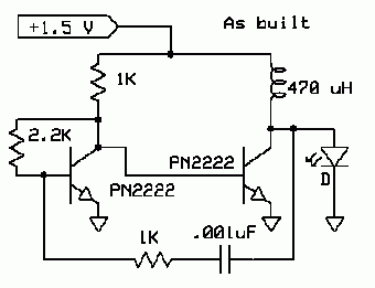

I just need to light up an LED with 1.2V cell. Same as joule thief but I don’t like to put a resistor instead of an inductor I need actual inductor.

Here is the circuit diagram.
Somebody please help me to make this 470uH inductor.I don't want to use 470 ohm resister for that I need an actual inductor.
Please tell me how to make that inductor.

You mean this?
Maybe you're confused? This is inductor, just buy one and you can get the circuit working and save the space :)

As you have probably found out by now, winding your own air-core coil to get 470 uH will take a few hundred turns of fine wire. This is an impractical and clumsy attempt. May I suggest instead that you use a ferrite core to reduce the number of turns required. Unfortunately, there are many different kinds of ferrite materials out there, and winding an identical number of turns for each will result in radically different inductance values.
Winding an air core is real easy.
Mount the largest size dowel rod you can in a drill (3/8 or 1/2"). Mark the length the inductor should be on the dowel rod. Pronine will tell you based on the gauge how many layers at that length it'll take (try to make it an even 2 or 3 or 4, not 3.36 or something). Secure the wire to the dowel rod with some tape, hold some tension on the wire from the spool, and slowly spin up the drill. It's real easy to get tight/no-gap windings this way with just a little practice. Layer it back over itself when you get to the marking for the end of the inductor for the next layer. You can tape the windings down in between layers if you want to help hold them, I use some special HV insulating polyethylene tape for mine but packing tape would be fine too. This works better the smaller the wire is (24-32ga is what I have used).
Alternatively, Madisound.com and PartsExpress.com should have something close to .5mH in 20ga and larger wires for low DCR.
This is listed as a 470uH RF choke? Will this work as the inductor? I've been wanting to build a similar circuit, but kind of put off on winding coils by hand. I think the circuit above is the 'Joule-Thief', but remember it differently.
A 470uH coil on a 1/4 inch dowel with 1/4 inch length using 30 gauge wire is only 30 feet of wire, you could wind one in half an hour with what you have a round the house if you have enough 30 gauge wire.
