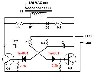

How to parallel two 2N3055 transistors = 120vac, 150 watts?
I corrected the horrible original inverter by correcting the polarity of the capacitors, adding series base diodes and adding base-emitter resistors. Decrease the base bias resistors to 47 ohms and increase the capacitor values 4 times the original.

The transformer inductance determines the magnetizing current, it does not limit the operating (input) current.
That is true if the primary and secondary are well coupled at the frequency of interest. But if the coupling at that frequency is poor, then the inductance can limit the current.
Though maybe I should have said that the inductance would limit the rise time of the current. If the switching frequency is fast, then the current may not get up to a nominal value before the next transition.
And, since we are talking about a square wave, the real frequency of those edges will be much higher than the switching frequency.
Now, I wasn't saying that this IS the problem, Just that it might be. And the first thing that I would do to check would be to look at the current waveform with an o'scope.

Isn't anyone doing any math here? :(
The 2N3055 transistor has a current rating of 15 amps max plus a gain of around 20 - 30 at best.
In my books that says that in ideal conditions you could maybe push ~180 watts to the inverter input but to do so would take somewhere between 500 - 750 ma base drive current. :facepalm:
No.
The hFE or beta is used for a linear amplifier that has plenty of collector to emitter voltage and for the 2N3055 it is a minimum hFE of only 5 when its collector current is 10A and its collector to emitter voltage is at least 4V.
You want the transistors to saturate with a low voltage drop, the datasheet says for a collector current of 10A the minimum base current must be 3.3A, then the saturation voltage loss is "only" 3V.
The maximum output power will be only 10A x (12V-3V)= 90W. The transistors will produce total heating of 30W. The base bias resistors will be 3 ohms and will produce total heating of 33W.
The base emitter junctions of the transistors will produce total heating of 6.6W. VERY poor efficiency.
Gary's circuit with no capacitors has both transistors conducting maybe 500mA each at the same time without oscillation.
I have seen a lot of inverters made with the 2N3055 transistor and it surprises the heck out of me that anyone would really want to make an inverter with these old transistors. I think they were originally made for use for audio where they had to work in the linear mode so saturation voltage wasnt much of an issue.
In an inverter that runs off of a battery, efficiency is a very important property of the inverter. With a 50 percent efficiency, the battery runs down twice as fast as one with a theoretical 100 percent efficiency. So the goal of high efficiency becomes very apparent.

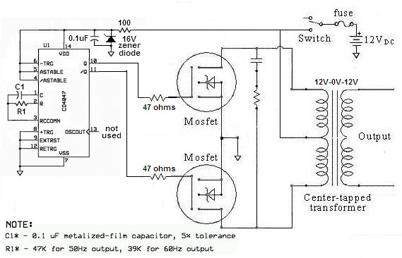

Here is a very simple squarewave inverter using Mosfets. There is no dead-time so one Mosfet is turning off when the other one is turning on causing a current spike and reduced efficiency.
The CD4047 IC produces a squarewave with exactly 50-50 symmetry.

That's something like i was thinking about in post #29. A fifty percent duty osc that drives the MOSFETs.
One way to add some dead time is to use an open collector inverter gate, pullup resistor and cap on the output, followed by a Schmitt Trigger inverter gate, followed by an inverting gate, and put one of these in each gate drive line.
When the osc signal goes high, the cap discharges fast, so the output of the Schmitt Trigger goes high and so the output of the following inverter gate goes low turning off that transistor. When the osc signal goes low, the cap begins to charge but it takes some time to reach the Schmitt Trigger threshold level so there is a delay before the Schmitt Trigger output goes low, and finally when it does the output of the following inverter gate goes high which turns that MOSFET on. So the turn off signal is not delayed while the turn on signal is delayed, and the delay can be adjusted by changing the value of the pullup resistor and capacitor. A small dead time like 1us might be enough if the MOSFETs can turn off fast. For bipolars a longer dead time is better.

To be honest if a person wants a basic yet decnet driver circuit for any type of inverter Would recomend going out and buying a actual dedicated IC that does the job right. ;)
There are hundreds to choose from and everyone of them will do the job better and with less parts than any toss together circuit made from 555's and logic gate bits N pieces.
I would recomend starting with something like a LM494 or a LM3524 IC or one of their many variants as a basic driver IC and go from there.
I agree. Power designs are so much easier to do with the right part for the job.
