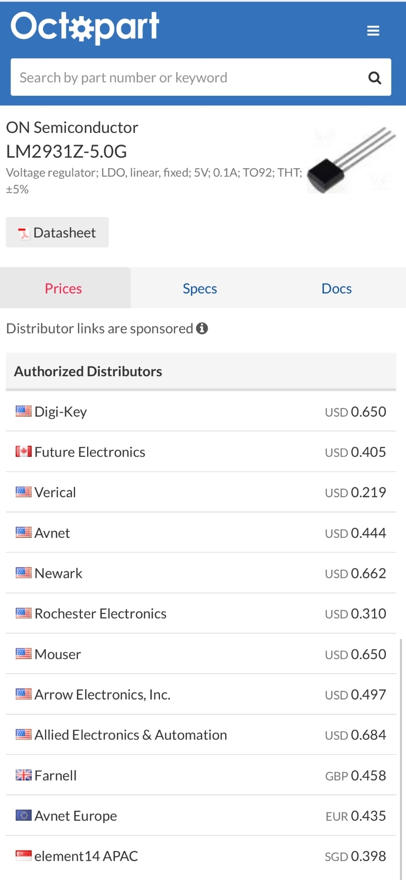

The suffix after the part number specifies the package the part it in (e.g., T0220, TO92, SOIC-8). The data sheet is your friend.
Searching for LM2931 on Octopart.com shows some of the different options - see first picture below.

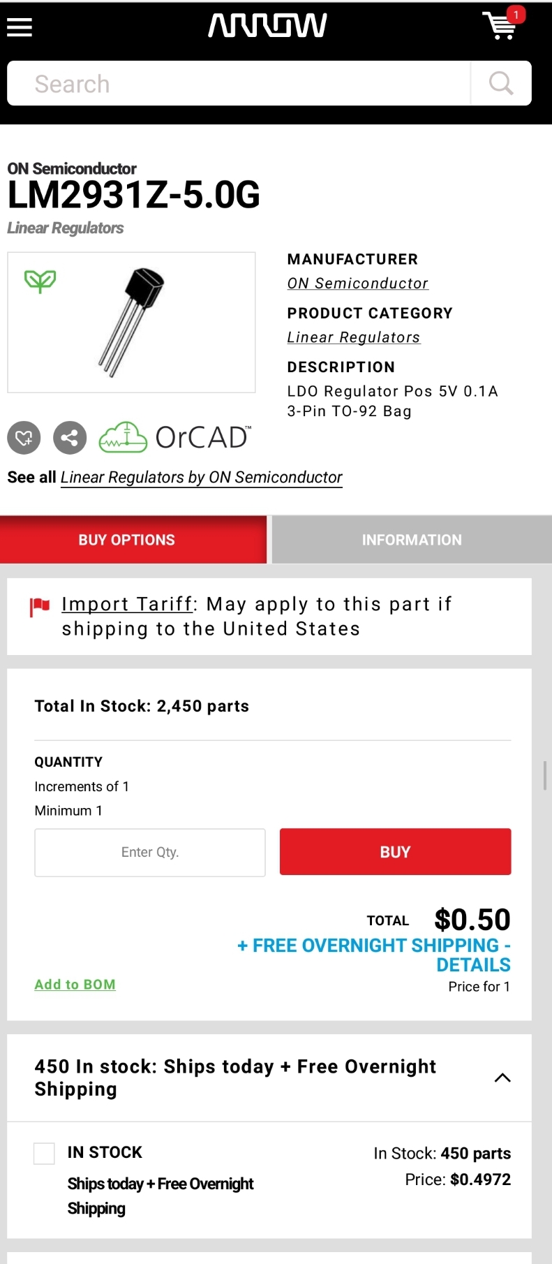

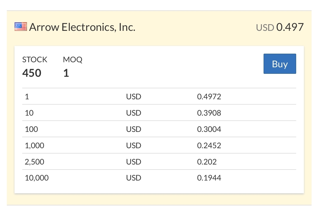

Clicking on one of the TO92 versions available at Arrow brings up the price breakdown for this part and a BUY button. See the second picture below.
Clicking the BUY button brings up the screen where you can actually purchase the part. Enter the quantity you'd like to order, and click the BUY button. Note that the screen says Overnight shipping is free. If you click any other option when checking out, shipping will not be free.

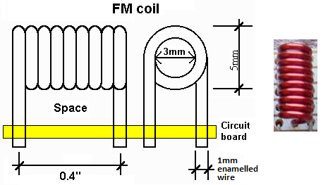

Your coils are very different than mine, they will probably tune to aircraft frequencies and cause the RF cops to arrest you for causing an aircraft collision.
Circuit drawing says .1uh coils. I used online coil calculator to make both coils .1uh. I tested both coils on both of my meters I get crazy values. One meter reads coil too high the other meter reads coil too low. Next I did the math myself and got .100082uh round that off = .1uh
I did several experiments making coils and learn if diameter doubles the value goes up about 3 times with the same number of turns. I kept getting coils like 5 1/3 turns or 6 3/4 turns or 3 1/2 turns. I decided to make a 4 turn coil 3/16" long then keep changing the diameter until I get .1uh I learned coil diameter needs to be .280 diameter. I have machinist drill bit sets I wrapped wired around different drill bits to see what diameter coil turned out to be after metal spring back. I has to make a few coils to finally get .280 diameter. Diameter, length, number of turns, is correct it should be .1uh. Wish my meter would tell me for sure what the value is I guess I will find out if FM radio receives no signal then coils are wrong.
Since the inductance is so low and the stray capacitance is so high then calculating the coils or measuring them is useless. My coils work fine and I simply guessed that they are 0.1uH, your calculated coils are so different to mine that they will not tune to the FM broadcast band. Why not copy mine and make your project so it works properly?
I may have to copy yours. Soon as the cap and battery holder comes I think I will test is like it is. If it does not work then I change it. Is your coil 8 or 9 turns? I have no 1mm enamel coated wire. I may have a short piece of naked 1mm wire that I can paint.
I stole some enamelled wire from the inductor on a speaker crossover network. My coils have 9 turns but I did not try tuning the C6 frequency range since there are many FM radio stations all across the FM broadcast band in my city.
