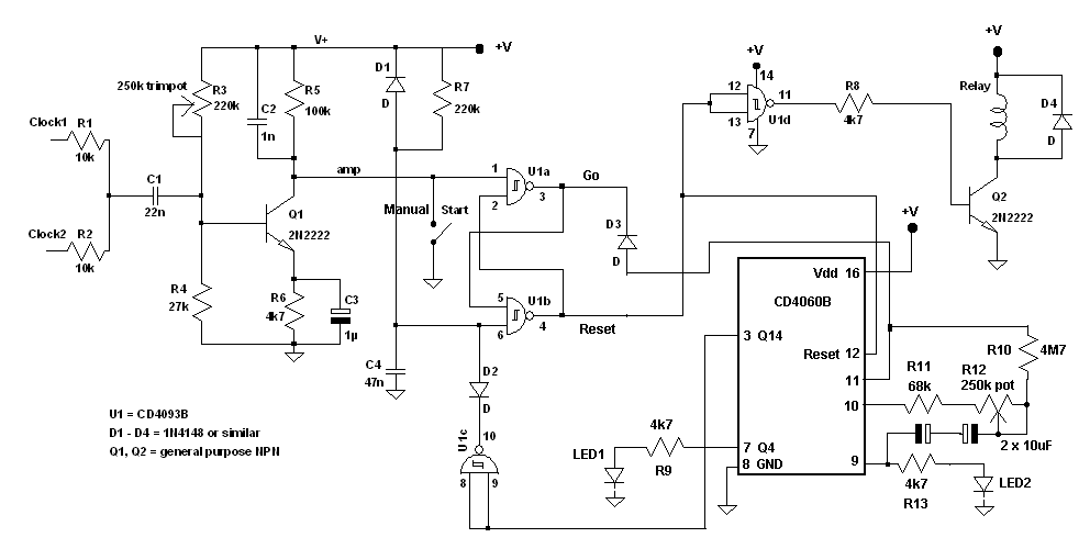

How to reset this ic without any switch....

Hi alec...
How are you ! :)
Fried my battery was low so I replaced with new 10 volt battery..
but the problem As I connect the battery the 3hr timer starts to run without
clock pluse or manual start ...
But If I use the 9v old battery which gives something 7 volt(because it is old)..
The 3hr timer doesn't starts untill I manually start or untill it gets clock pluse..
As it gets clock pluse it starts to run...
But with new one battery it starts as I connect the battery...
I hope this is a big problem !!
Thanks for your co-operation uptill now !
Thanks in advance !
Yusuf
