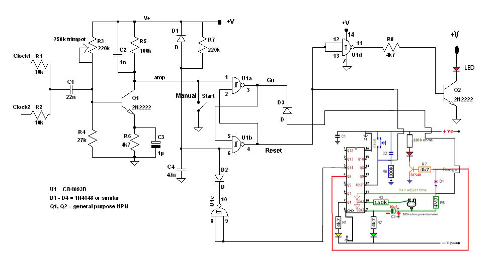

Hello alec.... I have read your post and I have also discuss with my friend and he replied to me :
You have had a great deal of difficulty attempting to build my tried and tested circuits.
You are now proposing to build a circuit that has never been built before
So far - the best that can be said is that the circuit works in a simulator.
That doesn't mean it will work in reality.
If you build the entire circuit at once - and find that it doesn't work -
You won't know where the fault/faults lie.
And your lack of experience will make it difficult for you to sort the problems out.
The circuit will have to be built and tested,
That much is true.
I have been trying to encourage you to approach this task in stages.
And check its performance as you go.
As he said we should make this circuit in stages because Alec I dont have good electronics knowledge so minor fault can damage the IC several times...
So Ron said and he given me the the circuit diagram so that I can complete your full circuit by stages..... easily and conveniently....
so alec what do you say ??? :)

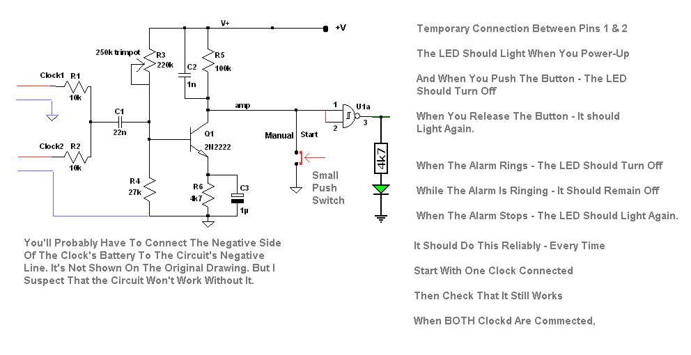

I agree it's a good idea to build this in stages, and your friend's circuit is a good stage 1.
(1) Re the beeper connection, we don't know which (if any) beeper terminal is connected to which clock battery terminal. To play safe, simply connect one beeper terminal to the stage 1 circuit ground and connect the other beeper terminal to the 'Clock 1' terminal. I am assuming the clock has its own separate battery.
(2) My design calls for the R3 trimpot to be set so that pin 1 of the gate U1a goes to about 2/3 of +V at power-up and stays there until a beeper signal is received. The operation of this stage will not then be as your friend suggests. So the comments in the right-hand column of the picture in post #81 should instead read as follows :-
Temporary connection between pins 1 and 2 of U1.
The LED should be OFF when you power up.
When you push the button the LED should turn ON.
When you release the button it should go OFF again.
When/while the alarm rings the LED should flicker or dim.
When the alarm stops the LED should go OFF.
It should do this reliably every time. Start with one clock
connected then check it still works with both clocks connected.

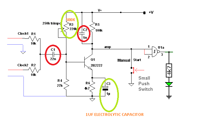

I AM BACK...I HAVE BOUGHT THE COMPONENTS BUT SOME COMPONENTS ARE NO AVAILABLE.... BUT ALMOST ALL I HAVE GOT......
HERE I HAVE ATTACH THE CIRCUIT DIAGRAM............
THE COMPONENTS WHICH ARE NOT AVAILABLE IS MARKED IN RED IN THE CIRCUIT DIAGRAM
C1 & C2..
I DIDN'T GET ANY IF THE ABOVE CERAMIC CAPACITORS..
I ONLY HAVE :
---> 10NF (CERAMIC, WHICH ARE SMALL AND YELLOW IN COLOR) AND CODE IS 103...
---> 100 nf AND THE CODE IS 104...
---> 3.3 nf AND THE CODE IS 332...
AND THE COMPONENTS WHICH ARE MARKED IN GREEN SHOWS CAN I REPLACE IT... WITH THE VALUE SHOWN..
R3 & C3...
R3 : 500K TRIM POT
C3 : 1UF ELECTROLYTIC CAPACITOR....
THANKS IN ADVANCE...
KINDLY ACKNOWLEDGE :
YUSUF
Try the 10nF (first choice) or 100nF (second choice) for C1, the 3.3nF for C2. These alternatives will affect the frequency response of the amplifier so it may not be as effective as intended. You will just have to hope it's ok with your particular beeper signals.
The 500k trimpot will suffice for R3.
C3 is specified as 1uF; which is what you have?

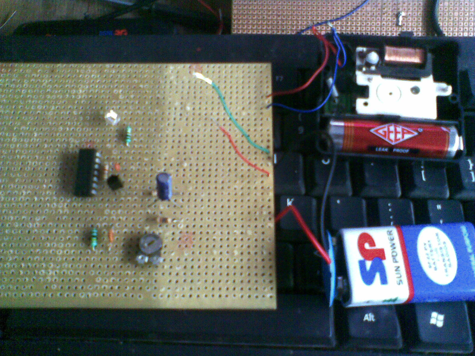

hello alec.....
i have tried making this circuit but after creating it ... when i powered ...
it doesn't worked .... I was not getting any response by pressing switch or adding alarm clock circuit.... the led was off and it remained off...
.... and also battery and ic was heating .......
i looked all the connections very well and my all connections was perfect.........
i have attach my circuit which i have made.......
So what should I do..... forward..
and one more thing , I have replace the switch with small wires....... so while touching the wires it will work as switch....
so alec.... kindly help... what should i do forward....
thanks...
.... and also battery and ic was heating ....... i looked all the connections very well and my all connections was perfect.....
Clearly all the connections are NOT perfect. Let's hope the components survived being heated.
Make doubly sure that you have correctly identified which way round the IC is connected, and that its ground (Vss) and +V (Vdd) pins are of the correct polarity and connect only where they should. Check also that there are no solder blobs or bare wires shorting out connection points. BTW, you should have followed the advice above and first of all built just the amplifier part (i.e. without the counter IC shown in the picture).
I'm afraid the picture (even if it were sharp) gives no clues as to how the components are interconnected and where the problem might lie.
The battery will obviously have to be replaced by another power source when you get the circuit working and are driving a relay with it.

wow........ great alec.......... you are brilliant....
I have checked the connections as you have said ... and the problem was lying in the vss and vdd... I have connected incorrectly ... now I have connected correctly and the result was as follows....
when I press switch ( the two wires) the led glows....
but as i connect my alarm clock circuit the led doesn't glow... and also while touching the the tips of the terminals in this circuit (where the alarm clock beeper pulse is connected) the led glow......
I hope .. this means that amplifier is working and while getting the pulse from the alarm clock the led doesn't glow or blinks...
help......
That sounds more promising. The stray electrical signals present at your fingers are probably much higher voltage than your beeper signals, so that is why the LED glows. You now need to adjust the amp bias to suit the beeper signals. As you are using a 9V battery you need to adjust the pot so that the voltage at the connection point between R5 and the Q1 collector is about 6V with respect to ground. The LED should then be off if there is no beeper signal but glow in sympathy with the beeper signal.
Edit: The beeper has two terminals. Do you have two wires connected from there to the amplifier input?

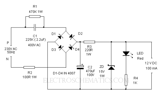

HI... ALEC...
I am waiting with my circuit in hand for your reply...
You haven't built the circuit I gave you in post #78. That is why you are getting weird results.
friend............ I love you.................. thanks a lot............... I have made it....
Ok alec.... Now it's time to build power supply ... for this circuit.. and say bye to battery..
as this circuit also contains relay .... then we should have 12 volt 100 ma current power supply.
I have a transformer-less power supply attached in my attachment ...
please have a look and reply alec...
thanks--
Aaarrrrgggghhhhh !! On no account build that transformerless supply: it's potentially lethal !!:eek:
Use a wall-wart instead. Is 12V 100mA the coil rating of the relay you intend to use?
