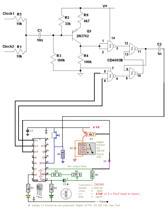

The LEDs attached to R1 and R2 will flash (slowly) to indicate that the timer is running. The R2 LED flash rate should be 0.3793 Hz for a 3hr timer.
Note: C3 should be either a 4.7uF non-polarised electrolytic, or 2 x 10uF polarised electrolytics connected back-to-back (as shown at the bottom of the schematic).
As you now want to have a variable timed period I've modified the circuit so that it can be set anywhere in the range ~1.5 - 7.5 hrs just by adjusting variable resistor R4.
Note that in the new circuit (attached) :-
a) R4 is now 250k, R3 is 68k.
b) Pins 5 and 6 of the CD4093 are now separated and are connected respectively to pins 2 and 1 of the CD4060 so that the beeper pulses coming from the alarm clock are blocked for 3/4 of the timed period, i.e. for at least the 1 hr that they persist. That enables periods down to ~1.5 hrs to be timed.
c) The relay is now driven from the Q14 output (pin 3) of the CD4060.
As an indication that the timer is working, the R2 LED, driven by pin 9 of the CD4060, flashes at a rate ~ 137/T, where the rate is flashes per minute and T is the period in hours. [The R1 LED flashes at 1/16 that rate].

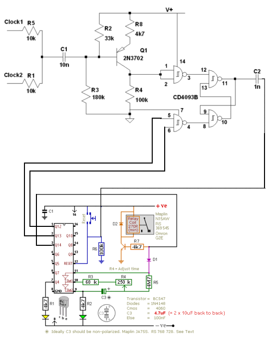

You told us the alarm sounds for 1hr (not 30mins). My circuit was designed accordingly. With the component values shown the minimum timer period is ~1.5hrs, as I mentioned in post #43. That means the timer is started (reset) by the first pulse in the beep and stops after a minimum of ~1.5hrs.
Note that the relay drive part of the circuit apparently needs to be changed. As it stands, while the timer is running the relay is de-energised and at the end of the timed period the relay is energised. I assume you want the opposite?
Friend my alarm sounds of 1 hr.. I have just gaven an example of 30 minutes.. So you said this circuit was design for minimum 1.5 hr.. I agree ... But in any other alarm clock the time of beeper can vary.. Suppose 20 minutes.. Or etc.. So what components we should set to gain any alarm clock.. Beeper time..
If you want to use the circuit with an alarm clock which beeps for less than 1hr then you can reduce the value of R3 (currently 68k). That will enable you to set timer periods shorter than ~1.5hrs. The guiding principle is that the beep duration must be less than 0.75 * T, where T is the timed period. [If the duration is > 0.75 T then the timer will be re-triggered as soon as the timed period expires; which isn't what you want].
Edit: Did you take note of my comment about the relay drive ?
A revised circuit showing the changed relay drive is attached. Note the transistor is now a pnp type (e.g. 2N2905) and the relay coil connection is between its collector and ground.

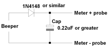

I'm afraid the files aren't helpful. I can't tell from the video what voltage range your meter is set to, or whether it's AC or DC.
Try connecting the signal via a series silicon diode to a 0.22 uF (or greater) capacitor to rectify and smooth the signal, measure the voltage across the cap using the meter on its 2V DC range (or nearest DC range you have), and let us know the reading.

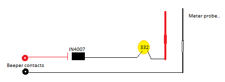

Hi alec..
Do you mean I should check like this....
please look in my attachment...
No. Like the attached.
You may have to swap over the two wires at the left side of the pic, depending on your beeper polariity, so that you get a reading.

hello alec....
OK ! I have tested as per in your attachment...... .
But the result was same friend... it was showing varying voltage...
Well if you are getting up to .2V across the cap then the beeper voltage must be about .2 + .6 = .8V, which should be plenty to provide the required timer-start pulses. Good luck with the build.

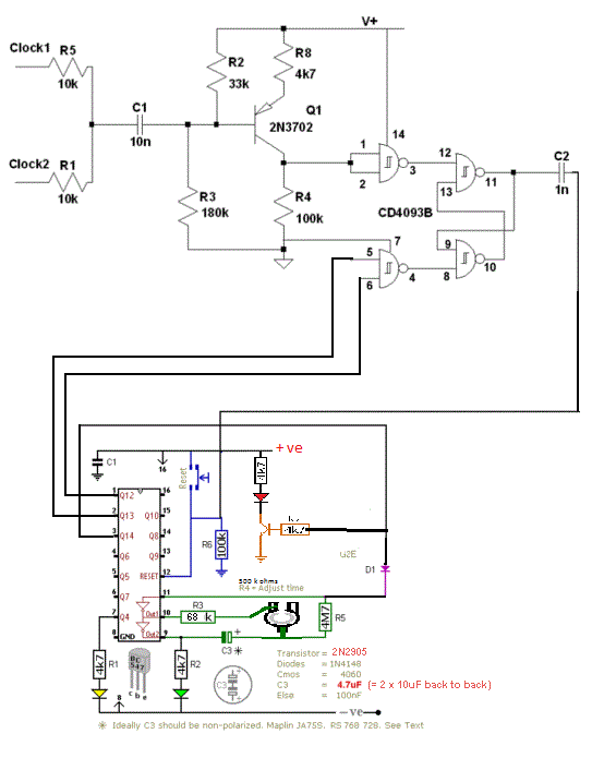

Just leave out the relay and temporarily use 0.22uF for C3 instead of 4.7uF. That will speed up the timer by ~ 20 times. The circuit already has LEDs to indicate the timer is working. Re-read my earlier posts.
Hello friend...
I have made a circuit diagram and I have replace led in place of relay... as per you told..
so should I arrange like this as in this circuit.....
so please have a look in my attachment .....
and if any problem occur then please correct it... I dont have 250 k ohms pot so I have used 500 k pot...
and what is the meaning of this you have told in back post.. I didn't understand properly :
please explain in simple form... friend..
