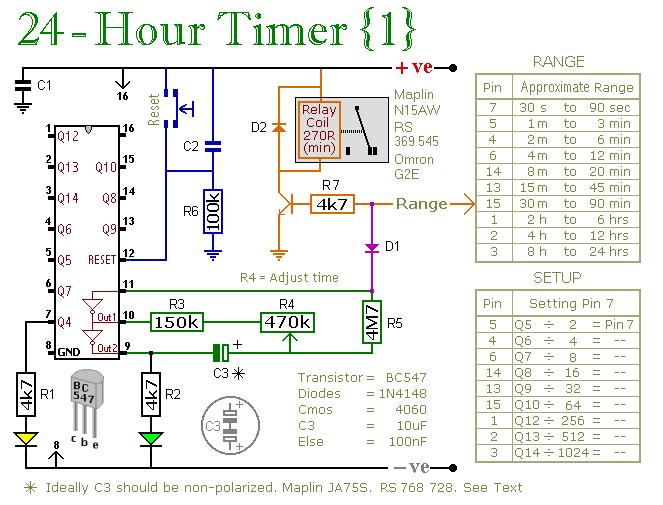

How to reset this ic without any switch....

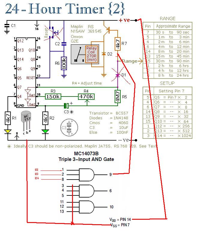

Just change the Range connection and adjust R4 so that the 3hr timer becomes a 2hr timer. The total timed period will then be 1hr + 2hr = 3hr.
Alec.. Thanks but my alarm sounds for one hour and i want three hour timer circuit so what modification will i have to do..
Timer to run for ever.
Timer to repeat every 24 hours.
Relay to be on for 3 hours.
Remove D1. (make...run for ever)
Add MC14073 or CD4073 (CMOS 3 input AND) OR (CMOS 3 input NAND will also work)
Connect the three inputs to Q12, Q13 and Q14.
Connect unused inputs to GND, VSS, VE (all the same thing)
Output of AND gate to R7. The AND will be high 1/8 of the time or 3 hours out of 24.

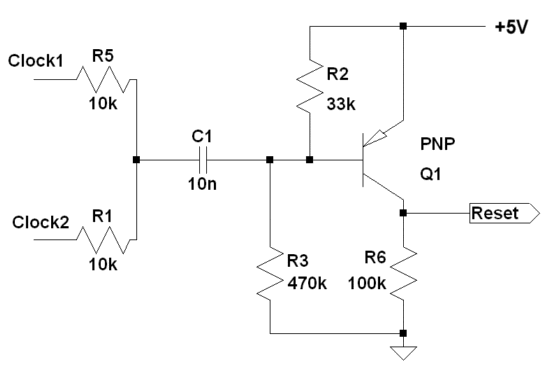

The circuit in post #19 may need a further mod to cope with two alarm clocks driving the reset pin, because of one clock loading the other. Attached is my suggestion (it just adds 2 resistors), which biases the transistor base ~0.3V below the +ve rail to improve sensitivity.
BTW, I still think it would have been easier to use one of the timers shown in the link below, instead of the two alarm clocks plus 3hr timer :)

I've just tested the simulation with clocks sending out alarm pulses as low as 1V peak-to-peak at 500Hz and the resulting reset pulse trains look fine. Good luck with the build. Bear in mind that if the timer range etc is set to 2hrs as per post #21 then manually resetting the timer by pushbutton will give a 2hr timed period, whereas alarm signals lasting 1hr will give a 1hr + 2hr = 3hr timed period. If that's a problem we'll need to rethink the auto-reset circuit. It would help if we knew exactly what sort of signal (voltage, polarity, frequency, duration) is available to you when the alarm sounds.

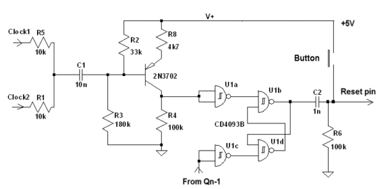

As you haven't provided details of the alarm clock output signals I've re-designed the reset circuit to cope with a wider input range. The attached circuit will respond to either pulsed DC or sine-wave signals of amplitude as low as 0.2V and as high as 5V, and now includes a set/reset latch (made from cross-coupled NAND gates) so that the first-arriving pulse/sine signal sets the latch and resets the timer IC at pin 12. Subsequent timer-reset pulses are ignored until the latch is reset. This means that the timer can be configured for 3hrs, regardless of whether it is triggered by an alarm clock or by the button. The latch requires a reset pulse at > 1hr (if the alarm sounds for 1hr). It can conveniently be obtained at 1.5Hrs by using the timer output Qn-1, where Qn is the Range output used to give the 3hr output. For example, if you use timer pin 2 (Q13) to give the 3hr output then pin 1 (Q12) will provide the 1.5hr output for resetting the latch. If this new circuit proves too sensitive the sensitivity can be reduced by reducing R4.

hi alec.... please define IC pins I couldn't understand " U1a , U1b etc" please tell the Ic pins numbers instead of " U1a , U1b etc..." and I have CD4060 Ic... I dont have CD4093 so please tell on CD4060.....

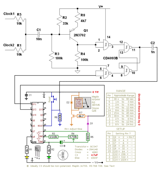

You need a CD4093B in addition to your CD4060.
Attached is how my reset circuit is connected to the CD4060.
I have added the pin numbers of the 4093. Note that because the 4060 does not have a Q11 output we are using Q12 and Q13 (pins 1 and 2). This has made it necessary to change C3 from 10uF to 4.7uF so that you get your required 3hr time-out. All the figures in the Range Table should, therefore, be divided by two. Note also that C2 is now 1nF and is not connected to the V+ rail.

Friend thanks for your reply. And can you tell me how will this circuit work with alarm clock.And for gaining 3hr time what changes will i have to do.Because i can't understand chart properly..
As I said above, the circuit will respond to either pulsed DC or sine-wave signals of amplitude as low as 0.2V and as high as 5V. Something in that range is likely to be available at the alarm sounder teminals. If you use the suggested circuit with the connections as shown you will only have to adjust the pot to set the 3hr time (the pot should give a time range of 2-6 hrs).
