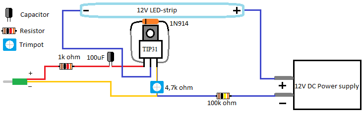

I surfed around the internet and made this simple schematic.
Is there everything ok with my schematic?

I answered this same question 45 minutes ago on another website.
You got it very WRONG:

Hi, recently I've found circuits for a TIP31 connected to an audio jack to make an LED change it's brightness to the music. I'm wondering, is it possible to make the LED dim when the music gets louder, instead of getting brighter? And how would I do this?
Hi Bibbi,
Below is a circuit I knocked out for you to experiment with.
The circuit consumes 20mA (0.020A) so it will run from a battery.
You can adjust the capacitor value to change the length of time the LED is off and you can lower the input resistor value to increase the sensitivity or increase the input resistor value to decrease the sensitivity.
