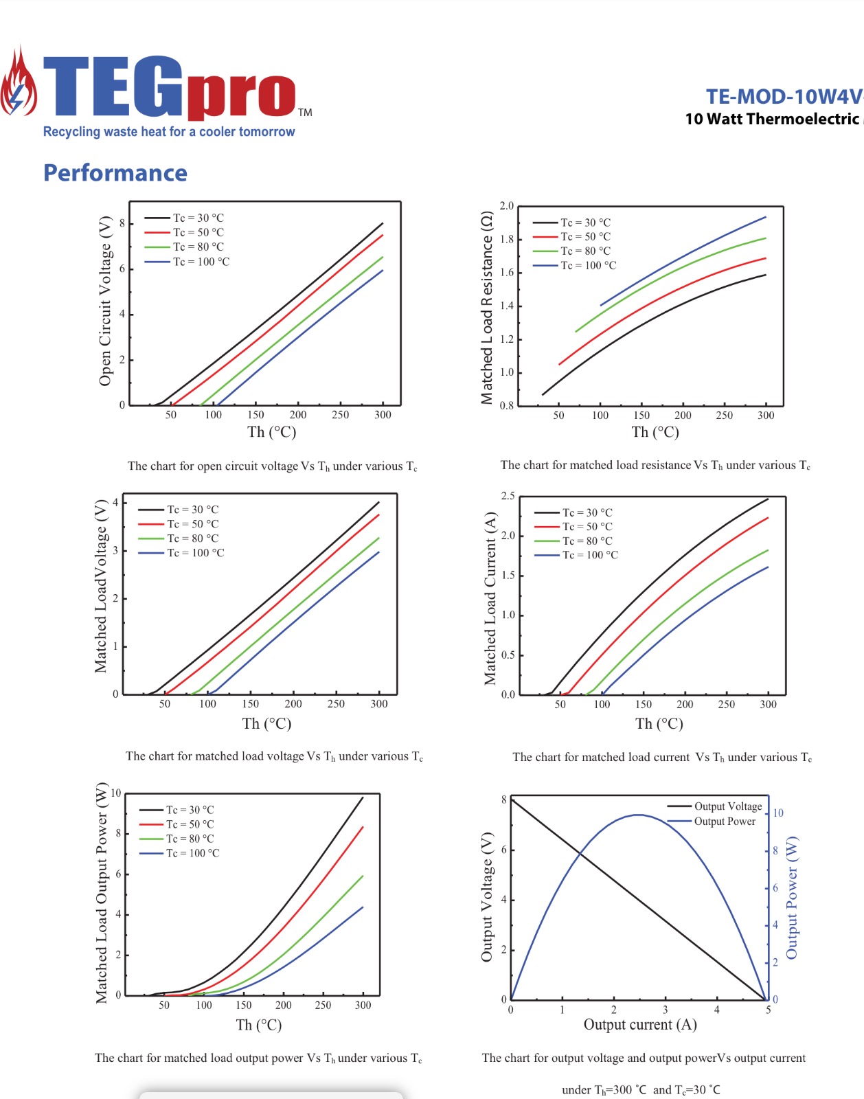

You linked a 10W 4 Volt device yet only spec'd 1V 1.2W . why?

Note the efficient load match is 50% of Voc, which I mentioned before.

I don't have a data sheet on the TEG you have.
I think it will output 1V at no current, 0V at 130mA, but is is best run at 0.5V at 65mA. That is the max power point. It can not do 1.V at 130mA.
I have a circuit that loads the cell down to (0.75V) and outputs 1.6 volts. It is not quite right yet but I will work more on it tonight.
Does anyone have a spice model for a TEG cell? I think I will use a 1V source with 7.7 ohms internal resistance.
