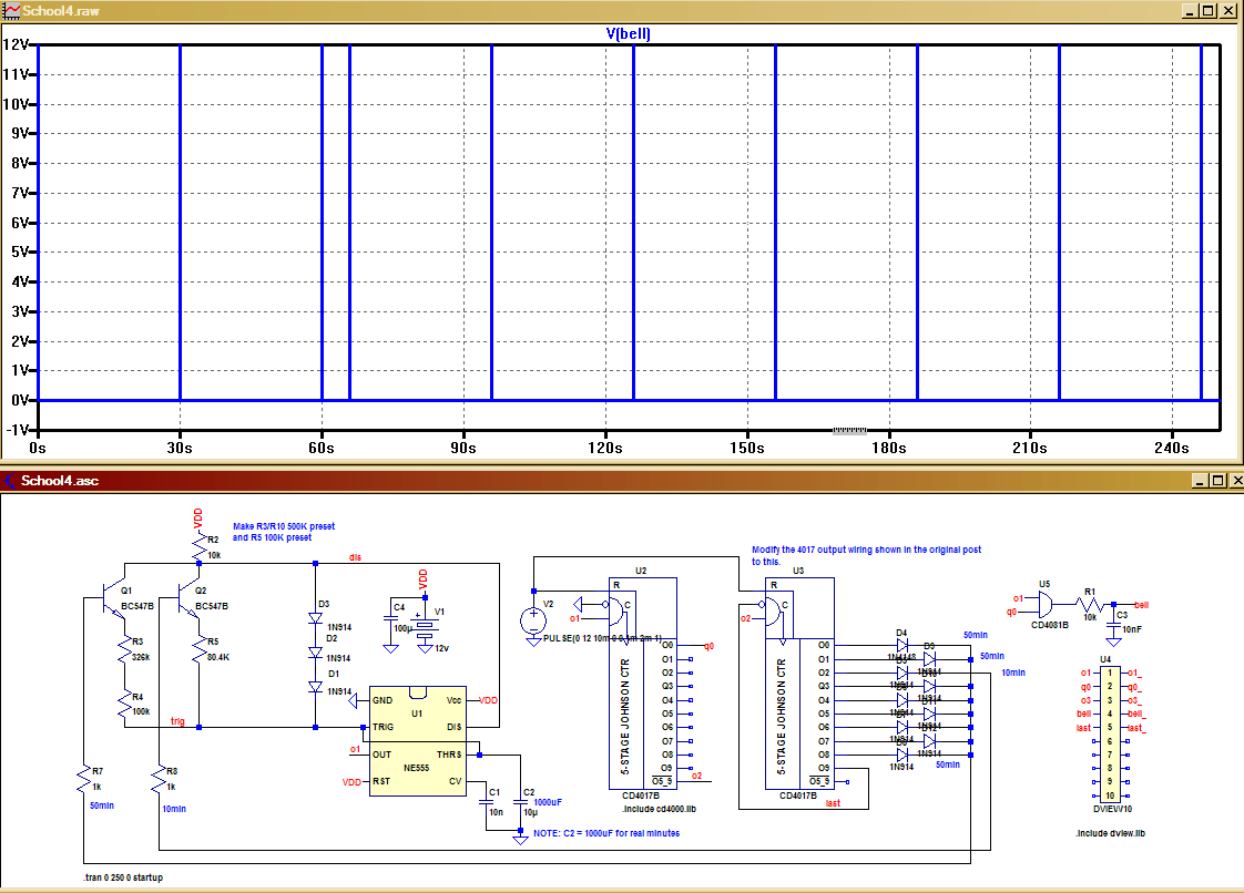

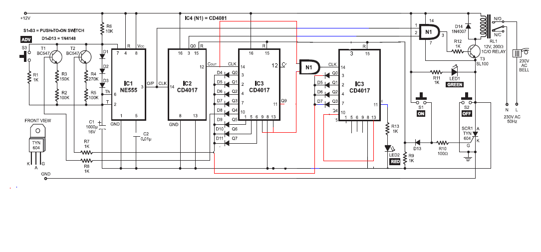

Look at this School Bell circuit for a previous Thread.
As its a School project, you work out the changes required and post your circuit for checking.;)

thank you so much ,
Seems a little complicated
I think there is a better way to design by IC 72555 ! am I right ?!
You need the design a modulo 60 counter for the minutes & a modulo 24 counter for the hours.
Then design gating to detect the times of each event and provide appropriate outputs.
