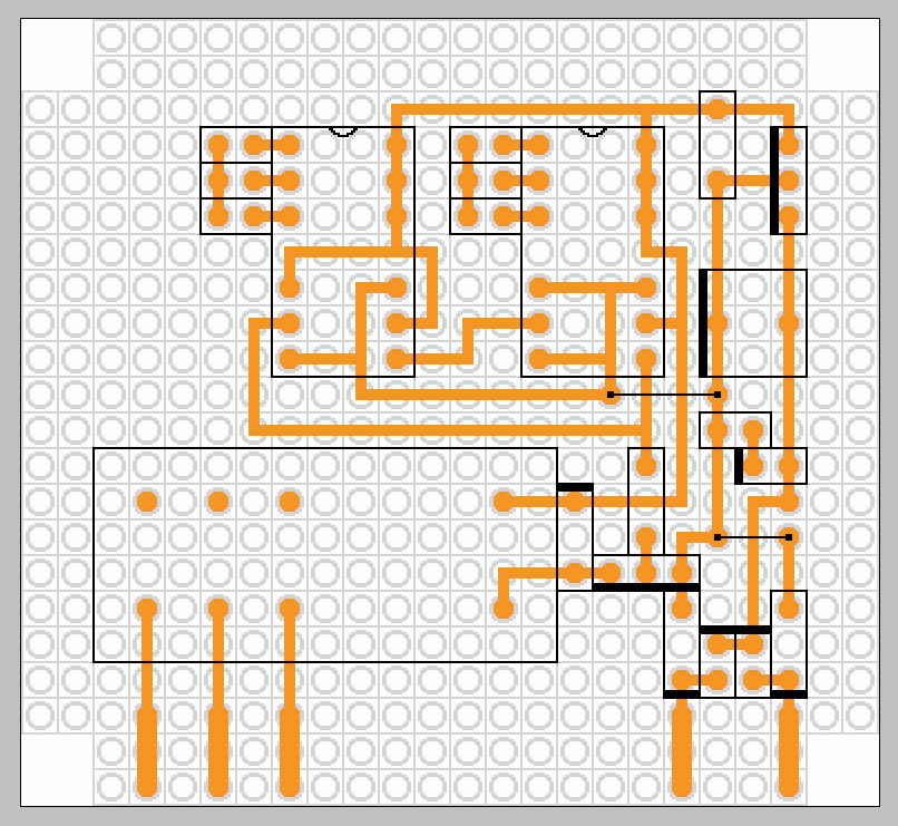

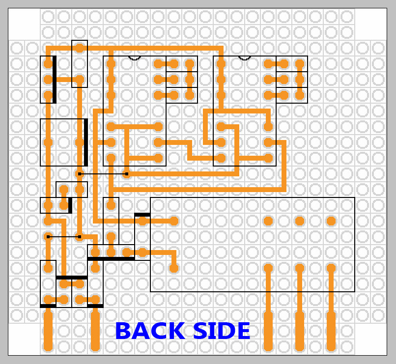

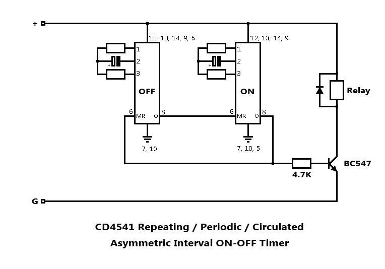

I don't know why my Periodic ON-OFF Timer don't work. They are two CD4541.
taotoon
I don't know how Master Reset (MR) pin work.
LOW -> HIGH = stop oscillator, output unchange ?
HIGH -> LOW = start oscilator, reset counter, output change ?
I test by insert only the right chip. The output remain HIGH all the time.
I try to reset by apply V+ to MR pin, the output still HIGH.
I remove V+ from MR pin, the output still HIGH.
(The right chip set to Auto Reset when power on.)

You are using a pulldown resistor on the MR pin when you do this right?
No. I use regulated 10V (7810). I jump that 10V to MR.
I will measure voltage at all pins again.
Every Cmos oscillator that I have seen has AC across the capacitor. So a polarized tantalum capacitor won't work.
