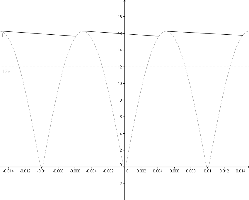

I have a normal car batteri charger that provides me with 12,9 volt dc. When I put a 6800uF 25v capacitor in parallel with the car charger, it gives me suddenly 18,8 volt dc. I can easily hear that my electric test motor (12v rc motor) gets many more RPM with the capacitor in parallel.
I have learned to multiply with square root of 2 when I go from vac to vdc with a lose of 0,35v over each diode. But I havnt learned anything about why my 12,9vdc can turn into 18,8vdc

Probably because the 12.9V is pulsed DC from a rectifier so measures 12.9V on the meater and adding a capacitor gives 18V which is the peak voltage.
I got it now I think. So after my ac/dc converter I get dc waves and doesnt really get the peak voltage. I will first get the peak voltage after I put in a capacitor.
By that I mean. If I had 15vac and made an ac/dc converter I would get waves from 0v to 21v, that being the reason why I measure 12,9vdc. Then I add capacitor to "smoothing" ^^ out the waves and will then be able to read 18,8.

Reason why you measure 18V is because of . . . - see curve I uploaded.
As you see, the cap will charge up to the peak of the curve. And then discharge slightly. The voltage will keep about 18 volts.
Another thing is that a battery charger often has a higher output voltage then 12V when there is no load. Voltage out should read 16,9 - 1,4 = 15,6 volts at maximum.
