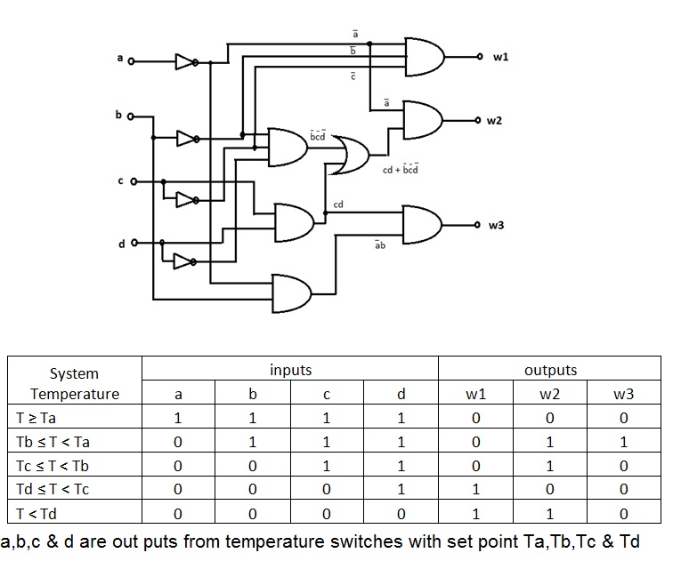

Hey guys! I really need your help with the task below.
If anybody is good at that, please write to trindyakyulya@gmail.com
Design a structure of the circuit controlling the work of the G1 and G2 heaters via the W1, W2, and W3
switches in dependence on temperature T:
- when T ≥ Ta – G1 and G2 turned off
- when Tb ≤ T < Ta – G1 and G2 connected in series and turned on
- when Tc ≤ T < Tb – only G2 turned on
- when Td ≤ T < Tc – only G1 turned on
- when T < Td – G1 and G2 connected in parallel and turned on

Do you need the full detailed shematic with temperature sensor? or what you need is just the block diagrams? The circuit on your attachment, is it with the question so that you only need to say whcih switches needed to be closed and open? if that is the case below is the answer considering shown status of the switches are "off" . but in practical switching on of W1 & W3 together is not allowed, it must have interlock with other switches in real application to prevent short circuit.
- when T ≥ Ta – G1 and G2 turned off - W1 & W2 off , W3 does not effect (either on or off)
- when Tb ≤ T < Ta – G1 and G2 connected in series and turned on - W1 off, W2 & W3 on
- when Tc ≤ T < Tb – only G2 turned on - W1 off, W2 on , W3 off
- when Td ≤ T < Tc – only G1 turned on - W1 on, W2 & W3 off
- when T < Td – G1 and G2 connected in parallel and turned on - W1 & W2 on, W3 off

Thanks Honduras & JoeJester, she contacted me privately, the expectation of the prof was to assign some input and send signals to switches for different configuration as shown. i have attached the complete shematic that i sent to her.
I would have thought the design was to include everything from one temperature setting and one temperature sensor thru the decision circuits to the relay drivers.
I guess it depends on what tshe is studying.
