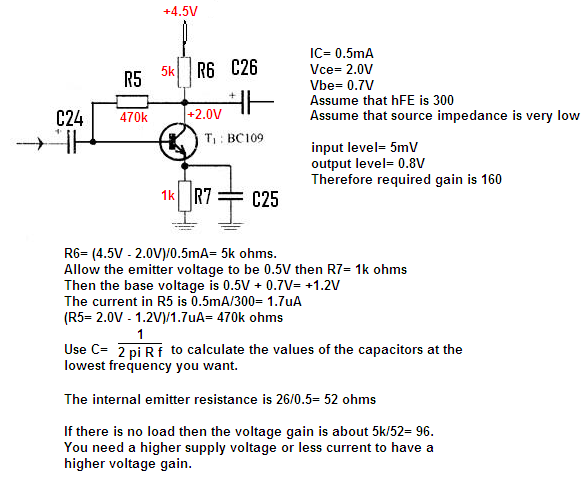

I need to calculete some resistors

The TDA7000 "radio" IC and the BC109 transistor are obsolete and are not made anymore.
The TDA7000 had horrible performance. I used BC109 transistors in my first job 45 years ago.
The hFE of an old BC109 is not 300, it is a range from 200 to 800. Yours might be 300.
Its Vbe is not 0.7V, with a collector current as low as 0.5mA then its Vbe is about 0.6V.
I did the simple calculations for you.
I made a mistake on purpose. I made Vc= +2.0V instead of making Vce= +2.0V.
I want the French-speaking guy to fix it.
ok thank audioguru this will help to start thank uu so much
you said that TDA7000 it is an old IC what kind of IC existe now and have good perfermance
Good FM radio ICs are very complicated. The TDA7513 has 80 pins in a tiny surface-mount package and has many features that are programmed and set by a microcontroller. It is used in modern car radios and home stereos.
