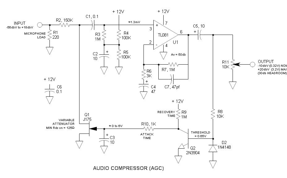

How about this compressor?
I've seen a lot of requests for this. It could be a fun project. :woot:

AG, how about this compressor?
A Jfet attenuator produces severe odd harmonics distortion when its input level is more than about only 100mV. The distortion is reduced and the input level can be much higher if half the signal level at the drain pin is fed to the gate pin. If a coupling capacitor is used to feed the gate pin then its slow charging time slows down the attack time of the compressor.
Here is a link to a good compressor circuit: **broken link removed**
