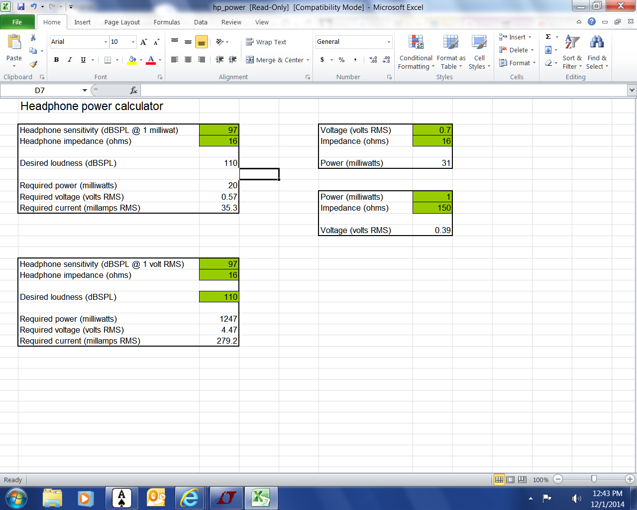

I would like to build a hearing aid, appreciate any professional advice
We do not know how much hearing loss there is. A loss of 12dB needs the output power to be 16 times the power that normal hearing uses.
A person with normal hearing uses headphone with the loudest peaks at 100mW per ear. Then normal peak levels would be -6dB which is 25mW. To allow normal levels when there is a 12dB hearing loss then the earphone will need a peak power of 400mW which is not possible with these little headphones amplifiers for MP3 payers.

I'm no expert but when I did the numbers for the Panasonic 62 mw gave a SPL of 109 db. I would be very hesitant do anything more.
Many "audiophools" with normal (?) hearing blast their headphones with peaks of 115dB. I hear them coming when they are still fairly far away. Then your Panasonic 62 needs 248mW.
I measured peaks of 120dB in a disco many years ago but it did not seem to be too loud.
But we do not know how much hearing loss there is for a deaf person and we do not know how loud they like the sounds to be. Also we are unsure about blasting away the remains of the hearing of a deaf person because we are not ear doctors.

Earbuds with a sensitivity of 97dB per mW need 64mW for 115dB per ear.
The TPA6111 stereo amp IC you linked to has an output of 60mW into 16 ohms when its supply is 3.3V. A Li-Po battery cell is 3.2V when it should be disconnected.

Average conversation level is about 65dB with peaks reaching 80dB.
Wikipedia rates "mild" hearing loss at between 26 and 40dB, "moderate" hearing loss is 41 to 54dB and "moderately severe" hearing loss is 55 to 70dB. There is also severe, profound and total hearing losses listed.
Then a person with a moderate hearing loss of 48dB needs 128dB for normal conversation. Then the power amplifier needs an RMS power rating into 16 ohms of 260mW.
