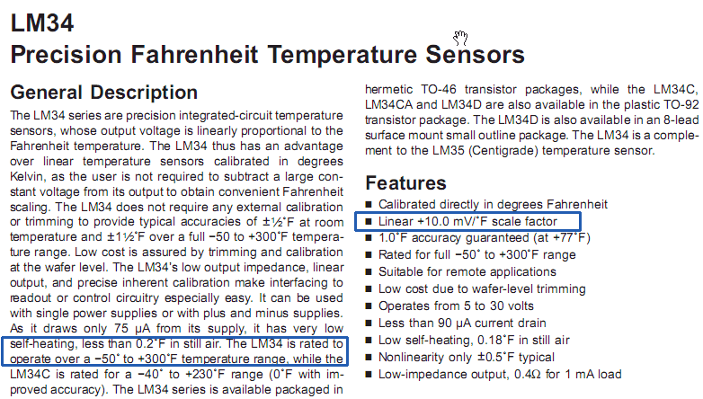

Look at this LM34 clip.
The Tempr range starts at -50F and increases by 10mV/F, so at +32F thats 82F degree change * 10mV =820mV and at 40F that 90F change *10mV = 900mV.

That changes things a bit. I (obviously) misread the LM34D d/s. Instead of trying to detect 32 degF at 320mV and 72 degF at 720mV, I'll be looking at 0V and 400mV. So I'm definately going to want that 5x gain.
Can you help me understand how the d/s output spec relates to no outputing higher than Vs-1.5? The clip you provided looks like Vs-4.0 worst case and Vs-2.0 typical. Am I correct in understand that the input cannot exceed Vs-1.5.

I'm looking at the D version, 32 to 212 degF. I guess the comment "Definately going to want the 5x gain" was being over zealous. More appropriately I should have said "I can definately use the 5x gain". The sensor sensitivity hasn't changed, so the need for the additional gain has changed. I was just noticing the increased headroom you provided by correcting my design error.

Look at this clip from the LM34D d/s.
The minimum expected tempr is +3F using Fig #1 on Page 2 of the d/s,,, look at Fig #2 as an option.

The LM34D should give320mV at 32F and 400mV at 40F

I see that now. Single supply will not get below 3-5 DegF output. Bummer. I'd really like to avoid dual supplies. I'll have to think on it a while, but the 3-5 degF limitation may not be a problem (but it would be better if it did read to 32F instead of 35F). If I set the thresholds for 50-55 degF not reading to 32 won't be a problem.

The output will be 40degF=400mV instead of 80mV ([40-32] *10) as we thought earlier.
Based on your d/s clip fo the LM34, the D may not be accurate below 3-5degF? Or it won't read below 3-5degF?

The 3F minimum on the LM34D means an absolute minimum V of~ +30mV, which in Centigrade is -16Cdeg. I would say your application will never get that cold, I hope.!!

Oops. I think I just got my Cs and Fs screwed up as well. I don't think it's going to get to 29 degrees below freezing. Interesting that the part is listed as 32F to 212F but has a minimum accurate output of 3F. I'll take it.
