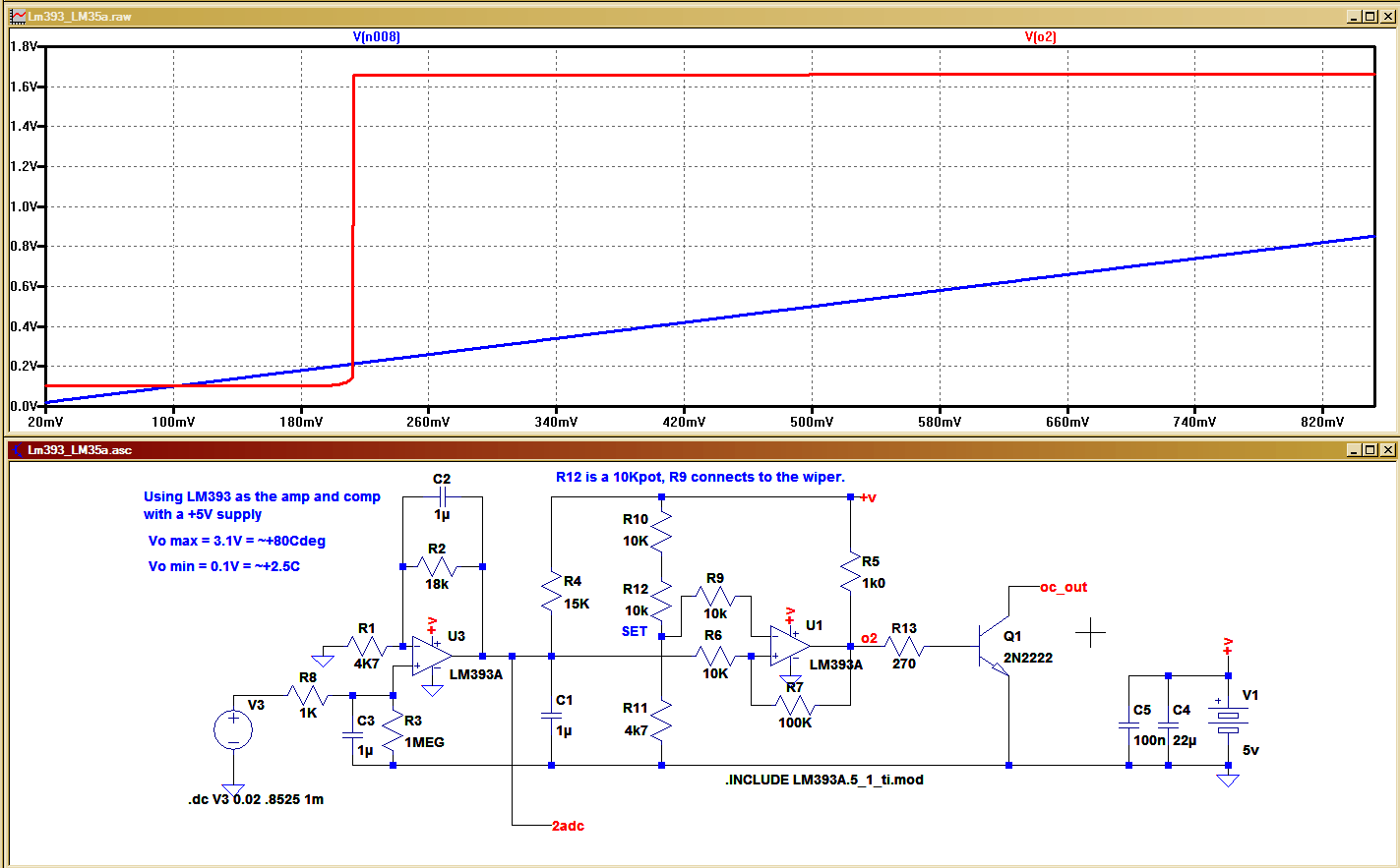

It appears that both comparators need to trip at the exact same point for proper operation of the circuit. But, in practice, they will not due to differences in their offset voltage.
To resolve this you could use U2 as just an inverter by connecting the negative input of U2 to the output of U3 and adding a resistive divider to set the threshold of the positive input of U2 at about 0.3V.
Or am I misunderstanding the circuit operation?:)
hi carl,
The circuit is designed to give the user a wide range and easy setting of the High and Low thresholds.
IIRC you use LTspice, attached the asc file, try it out.
BTW: its a useful circuit for auto battery chargers.
  • LM393WideHystIce2.asc
hi carl,
I wasn't questioning the operation of the circuit in simulation. That will work fine since the offset of both the comparators is the same. But with an actual device the two comparators will likely have slightly different offsets which means they will switch at slight different points. Thus if U3 switches before U2 there will be no hysteresis for U3 and it could oscillate.
That was my concern. That's why I suggested the circuit change to maintain the hysteresis and ease of threshold adjustment that your circuit has without this possible oscillation problem.

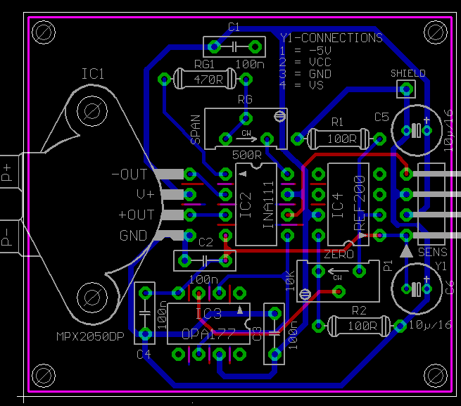

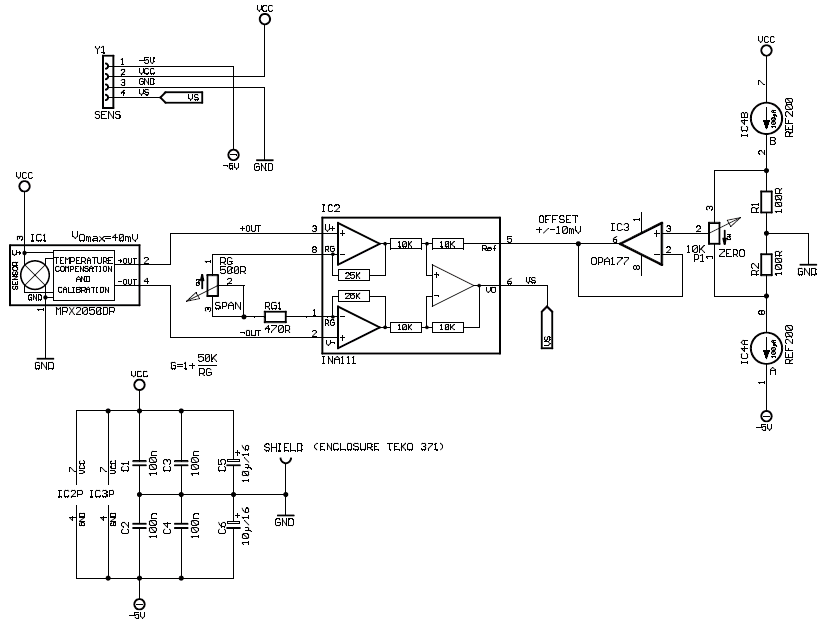

Hi ADWSystems,
here is another approach to measure icing on a heat exchanger.
Icing may occur before temperature is actually down to <0C and depends on atmospheric conditions. Ice might even build up at +5C with the right amount of humidity and airspeed through the heat exchanger.
I developed an "anti-icing" system for a car manufacturing plant (Audi, Ingolstadt/Germany).
The principle is very easy to understand: Intake air- and exhaust air pressure are almost equal (minus the resistance of the heat exchanger).
I used a differential pressure sensor with both (negative and positive pressure ports connected to PU hoses and fixed into position) and placed the measuring points directly at the intake and exhaust end of the heat exchanger.
During normal operation (no icing) the pressures are almost equal. As soon as ice builds up the pressure difference increases. The output voltage of a differential pressure sensor with amplifier is in the Volt-range (no necessity to deal with milli-Volts and amplification factors).
Using a 10mb differential pressure sensor you can set the amplification of the INA11 (instrumentation amplifier) for an output of 5V at half the span of the sensor. Sensor used is a Motorola MPX2010DP.
If icing is sensed you should disable cooling and use room air to melt the ice. If normal conditions are regained cooling could automatically be re-initiated.
Here are the schematic and PCB layout of a differential pressure sensor. The positive port must be connected to the pressure side of the heat exchanger while the negative port must be connected to the outlet.
Board size is 53.6575X47.4662mm (2.1125X1.8750").
The circuit is relatively cheap to build.
For comparison: A professional differential pressure transducer (Furness Controls - UK) is about €1,2000.
Boncuk

The circuit as previously built showed no sign of instability, I believe that you are looking for problems that do not exist.:rolleyes:
All the User has to do is SET the Low threshold and then SET the High threshold, while setting the High threshold, the Low remains at its set value.
If you would care to post your version of a working solution, I would be pleased to see it.?

Lets assume that you amplify the 80mV range change to say a 5V range, how are you going to use the amplified signal.?
If you want greater sensitivity you could use an NTC thermistor instead of the LM34. For example, a typical 10k (at 25C) thermistor has a resistance which varies (albeit non-linearly) from ~ 33k to ~20k over a temperature range of 0C to 10C. [Figures taken from **broken link removed** ]

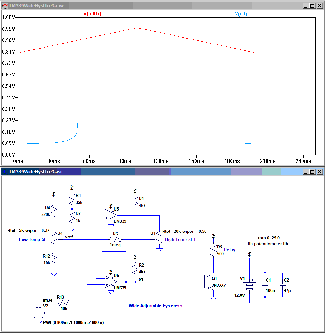

As an engineer I tend to look for subtle problems (sometimes perhaps when they do not exist).;)
But I think my concern is valid, even if you did build one circuit that worked without problem. A different chip with a wider offset between comparators could, I believe, exhibit oscillations.
Anyway, attached is your circuit with my modification. I didn't have the model for the LM393 so I used the LM339.
View attachment LM339WideHystIce3.asc
There is a single-comparator option which provides a just-as-easy setting feature and wide hysteresis. Simply replace the positive feedback resistor with a 1 Meg trimmer. U4 is then used to set the lower threshold and the 1 Meg trimmer sets the hysteresis amount (and hence indirectly the upper threshold). Because the trimmer value is much greater than R12 it has little effect on the lower threshold setting.

Thanks for posting your version of the circuit, if you are more comfortable with your version I do not have a problem.
Whatever the OP decides to do, [ if he uses either version] I hope he will post some feedback on his results.
