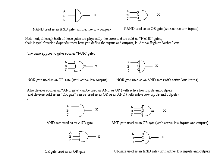

Attached are 2 options and my gating paper which may help you understand the circuits.
I converted your table to employ H & L rather than 1 & 0 as the latter is confusing when negative logic is used. (In negative logic, H = 0 & L = 1)
I chose the ICs as follows:-
For the Active High (AH) option, for U1 I needed an AND gate with an AH output and Active Low (AL) inputs - a NOR package.
For U2 I needed two 3 input AND gates with an AH output and AH inputs. But these are not manufactured as far as I know. So I used a quad AND.
For the Active Low (AL) option, for U1 I needed an AND gate with an AL output and (AL) inputs - a OR package.
For U2 I needed two 3 input AND gates with AL output and AH inputs - a triple NAND. Alternatively, a dual 4 input NAND would do.
