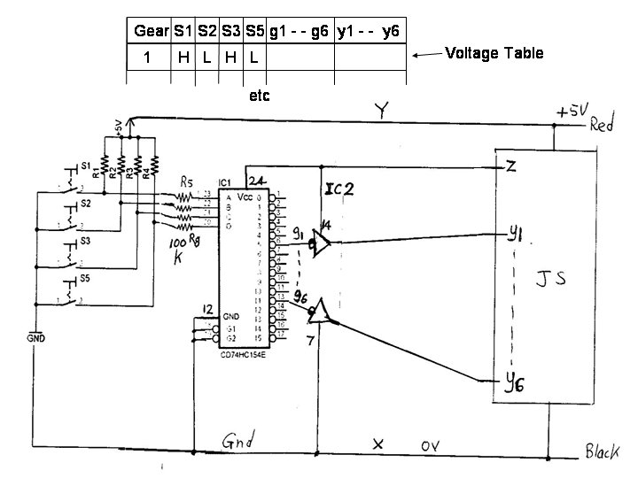

It appears that with the Gnd open, the circuit is obtaining a connection to x via the outputs of the inverters (ie. the 5 that are low) through the pull down resistors in the JS to x. Hence the low voltages measured at the inputs to the 74HC154.
Our problem all along has been that we don't know what is inside the JS. We can only deduce what may be in it from your measurements and our general electronics knowledge.
The first step is to re-connect the Gnd of the circuit to the x wire. I know it does not work but we need to find out why. Remove the connection from pin 14 of IC2 (the inverter) and connect it to +5V.
Then connect a LED as per my LED option circuit from the appropriate output of IC2 to y1.
Test. If it works, connect the remaining LEDs.
If not, make voltage measurement on both sides of the LED with the output of IC2 High and then with it Low.
Here is a variant that may solve the problem.
I suspect the problem with the last attempt was due the input protection diodes in IC2 injecting a current into Z.
So insert resistors R5 ~ 8 and transfer the wire on IC1 pin 24 from +5V to Z. BUT leave the top end of R1 ~ 4 connected to +5V.
The resistors can be any value in the range 47k to 100k and they don't need to be equal, so use what you have on hand. They are intended to minimise the current going into Z via the IC1 input protection diodes.
If it does not work, don't bushrange. Simply make a systematic measurement of the voltages for each gear and fill in a table as shown in the drawing so that Philba and I can analyse.
Also measure the voltage on Z for each gear. I forgot to add this to the table.

LEN:
I have reconnected circuit ground to joystick ground, and powered the Hex Ic with 5+ from joystick as stated. I have connected each LED in series after the hex output and into y1-y6 inputs as per your diagram on pg4. I get similar results to previous test:

I suggest that you do as I said in my previous post. If it does not work, produce a table of all voltages wrt Gnd.

The voltages across the LEDs are only of limited value.
It would help me if you measure the voltages wrt Gnd and tabulate them as suggested in the previous post.

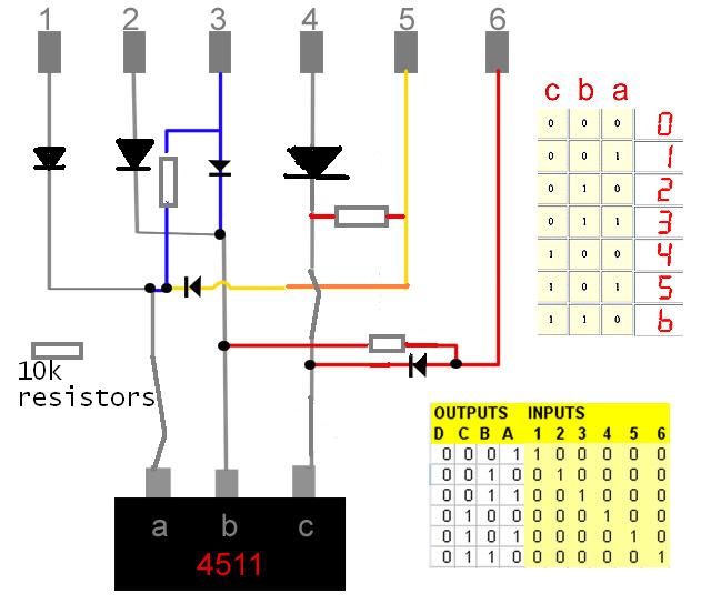

tnx for the 4511 diagram. May I ask why you changed some of the diodes to resistors?
Look up diode resistor gates. You need a resistor to act as a pull up or pull down. Pull down in your case. If you only use diodes, there won't be any change of voltage. When all diodes are off, the only pull down current will be due to the diode leakage which is often in the nA or pA range.
So when all diodes are off, with CMOS (which has a very high input resistance) the voltage at the inputs to the 4511 would depend on the diode leagage currents and the resistance of the PCB!
Remember that diodes will drop about 0.6 Volt, so the 4511 won't see the full 5 Volt. This may not be critical, but I personally would prefer to use NAND gates to do the OR function. A triple NAND gate IC would do the trick.

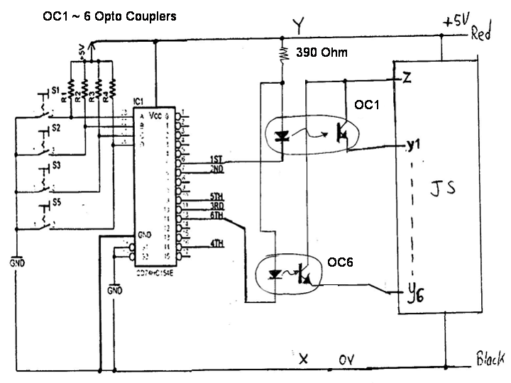

Here is a simple solution. I don't know why I did not think of it earlier. It is the closest you'll get to the original switches.
You will need 6 opto couplers such as the 4N25. Or, if you can find one with 2 opto in a package, you'll only need 3 ICs. Dual optos used to be available, but I could not see any in the electronics catalogues at a quick look.

That seems very logical. Thats what I was saying earlier in this post, about 'just closing a switch' like the original circuit, I wiki'ed the 4N25 and I understand the system perfectly, isolates voltages into two seperate circuits, and implements a remote switch using a light sensing device, very clever. That seems perfect! Will try pick some of them up today too.

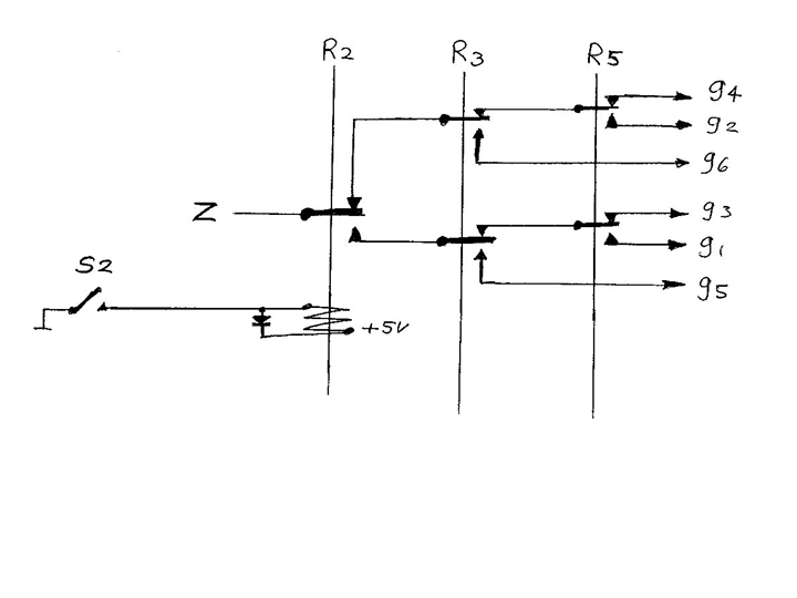

Another thing I was thinking last night, is we could just use 6 of those relays I tried using originally on this circuit... same principle right?
Yes, you could use 6 relays but you can do it with 3 as I posted originally.
Here is a variant of that post. Now we know that Z has to be connected to the lever spring of R2.

FInally! It works 100%!
Thanks to all of you that helped out, definitely couldn't have done it without you all.
I used the 4N25's just as you drew the diagram Len, and it worked perfectly first time.

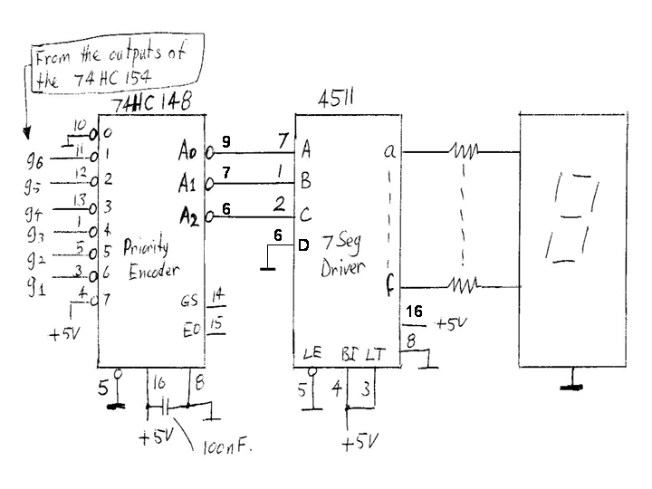

Next I want to add on to the circuit, with a 4511, and each gear will display the corresponding number on the 4511. Not sure when I will have the time for this next stage, will keep you posted though.
L8r
R
That's good.
Here is the 7 segment circuit.
If you can't buy a 74HC148, the 74HC147 will do.
Note that the gear lines are connected in reverse order. This is because the outputs of the 75HC148 are active low. If you study the truth table in the data sheet you will see how it works. (1 and 6 are complementary as are 2 & 5, etc.)
If you can't buy the 74HC148 or the 74HC147, then buy a 4023 or 74HC10. These are triple 3 input NAND gates. I'' post a circuit for this option if necessary.
