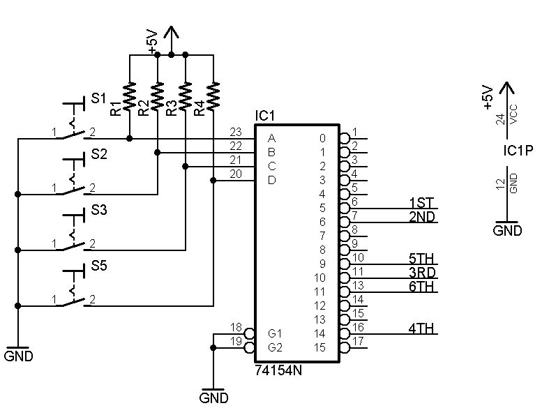

Thank you for your very easy to understand drawing, I'm very grateful for your efforts!
Question: What exactly are the resistors needed for, I see you're dropping the voltage before the inputs to the IC, is 5v too much??? How does this work?
Question2: you've drawn switches S1-S4 with another little symbol above the actual switch symbol, the little squiggle and the sideways 'T' (sorry for the stupid description)... what does that represent? Sorry for all the stupid questions!!!
Question3: You have used the 74151N IC, how on earth do you know what IC to look for out of the many thousands they make??! ALso, the solution to my problem requires AND's and NAND's/NOR's according to ljcox and my friends logic diagram. Does this IC have these? I looked at the datasheet online and my God, I was very confused by the linework logic diagram within the IC... I dont know how you know what outputs to pick....

the resistors are to pull the input high when the switch is open. this is important as a floating input (no connection) can go either way. You can use any resistor in the range 4.7K to 100K. I usually use 10K because I bought a whole pile of them.
active high vs active low is basically just an inversion. nand and nor (not and, not or) logic was slightly easier to use. Also, active low was used in bus configurations where you could have multiple devices connected to the same wire where pulled high was the default state (0).. I wouldn't worry too much about it.
edit: to answer the switch question - that was just the first spst switch symbol I found in the eagle libs.
Look at the truth table in the data sheet.
ljcox: I take it the HEX inverted IC will convert active High/Low inputs to its opposite logic?
You mean the 74154 or 74HC154. Yes, these ICs have AL outputs. You said you needed AH. So and inverter will invert the signals, ie. H becomes L and vice versa. I recommend you use the 74HC154 since it has adequated output drive to cope with what ever type of technology is in the JS. A 74154 is a TTL device (as it the 74LS154) and so you may have interfacing problems.
I suggest you forget about the 74xx154 for the moment and try to thoroughly understand my circuits. Then you will be in a better position to understand the 74xx154 ICs.

The 74154 is a TTL device, with active low outputs. I thought philba recommended a CMOS version of the device???
The outputs will be high, around 3 to 4 volts when none of the S1 thru S5 push buttons are pressed.
To set '5' low,[1st] both S1 and S3 must be pressed.
I'm sorry this help is limited, I'll look thru the back posts and try to get up to speed.
EDIT: I assume that you have got the +5V and 0V lines connected to the 74154?

hi ryan,
Understood.
Looking back at your earlier posting.
>> I tapped into the V+ of the joystick (my meter reads 2.5v from the power of the joystick to the common
of all the gear1-6 switches on the joystick board).
The Common of the S1 to S6 should be at 0V [Gnd], not 2.5V
There is another black wire on the board which has NO continuity to the gear 1-6 common, but when I read the Voltage across that main black wire and the joystick V+ its about 4.5volts.
This Black wire is the 0V [Gnd] and should be connected to the 0V of your pcb, pin 14 of the 74HC154 and the S1 to S6 Common.
Recapping:
The RED wire +V should goto the top of the resistors, as you have shown and pin 24 of the 74HC154.
The BLACK wire 0V should goto the Common of S1 thru S6 and pin14 of the 74HC154.
Dont use your meter on Continuity to test the circuit when the ic's are connected.
Remember when you have connected as described, the output pins of the 74HC154 without any gear switches pressed will be high, about +4V.
The selected output will goto 0V when the correct gear switch is pressed.
