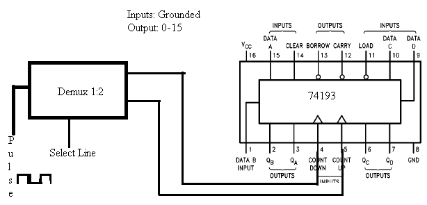

What are the rules to be followed to implement a IC(...like 74 series) on Genral purpose PCB,
i need use 74193 in my circuit, and i have done with the design.
But my problem is i dont know how to implement IC's Practically (Connections the i need to make, to exclude High impedance state etc.,). :confused:

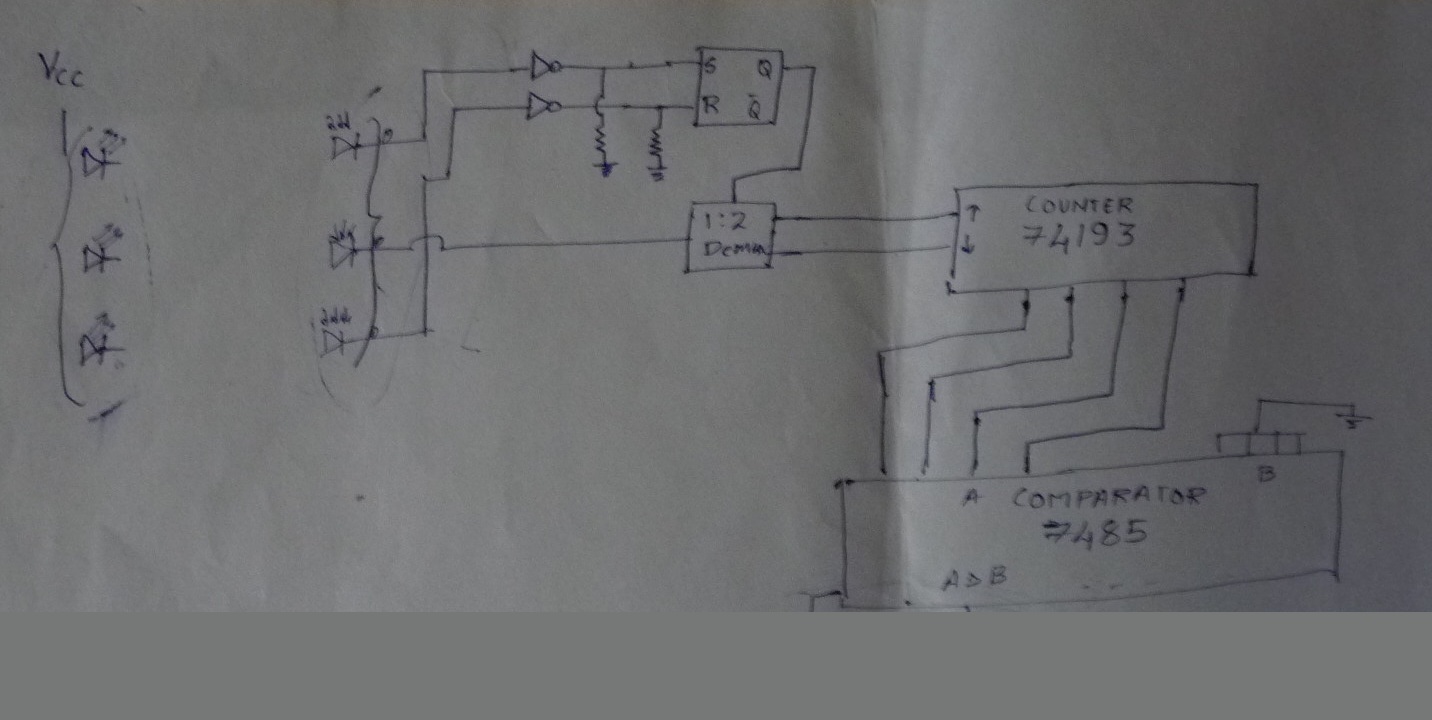

Here it is...also tell me where all i should use pull-down resistors,
i tried the design in a breadboard, but there was something wrong,
so i've posted this thread

Looking over your diagram.
The DEMUX, what type of IC is it.?
The 74193 requires that when clocking the unclocked pin must be high.

Gate outputs are normally pulled low or high.
You have to devise a logic gate combination that keeps the unused clock input held high while the other clock input is being clocked on a rising edge.
Do you follow OK.
BTW: do you plan to use the parallel load pin.?
Also have you got the CLEAR pin held low.?
EDIT:
Hint. Consider using NAND logic gates. Lets know how it goes.

may i know should i use pull-down resistors in all inputs of IC, so that i will eliminate High input state?
I'm not using "LOAD", "Borrow", "Carry"...
Yes, i'l use pull down resistor for "Clear"

No
Use a 1K resistor to +5v to hold this pin high, if not being used
Connect directly to 0V, if you dont plan to use Clear/Reset

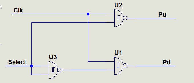

Look at this image for one option for gating the clock.

The resistors on the S and R are not required.
i may have to use it because i need the
"previous state as output" when there is no input...
(Because there will be no input at some times...
and 74279 does'nt have pull-down resistor embedded in it...)
May i know why u told so?
Is the 1:2 MUX the circuit I posted.?
Yes, Mostly ...
